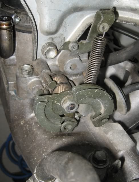

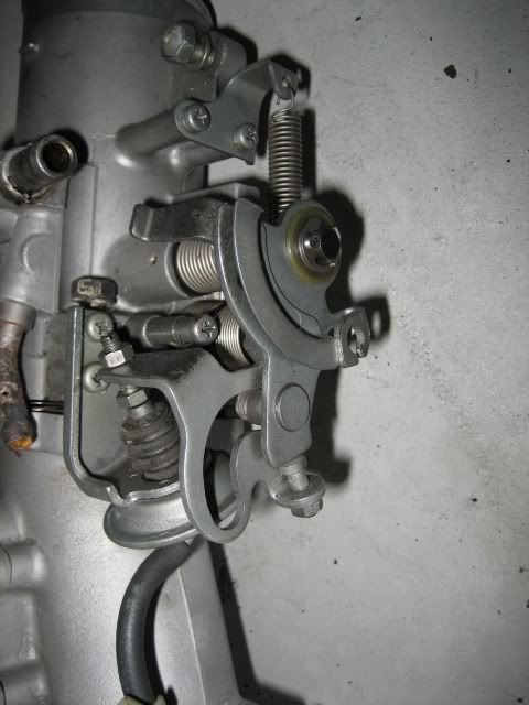

How bout these:
Supra throttle linkage (minus the auto tranny cable linkage)
and the MX-83 Cressida linkage (with the tranny cable linkage)
As you can see, the Supra linkage is more complicated with the cable linkage driving the throttle plate via another link. I can't just remove the MX-83 link because it lacks the extra "pin" to drive the secondary linkage.
I also can't just use the MX-83 TB because it's shorter and lacks the connections for ISC air tube, vacuum ports are positioned diferently, PCV hardline faces wrong direction, and there's no way to stably mount the dumb thing to the head with the stock supra Y pipe.
And there's no way I want to not use the tuned ACIS intake runner system!
