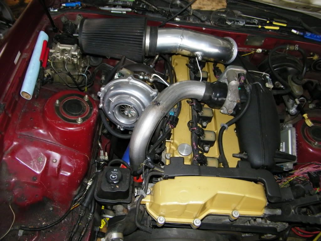

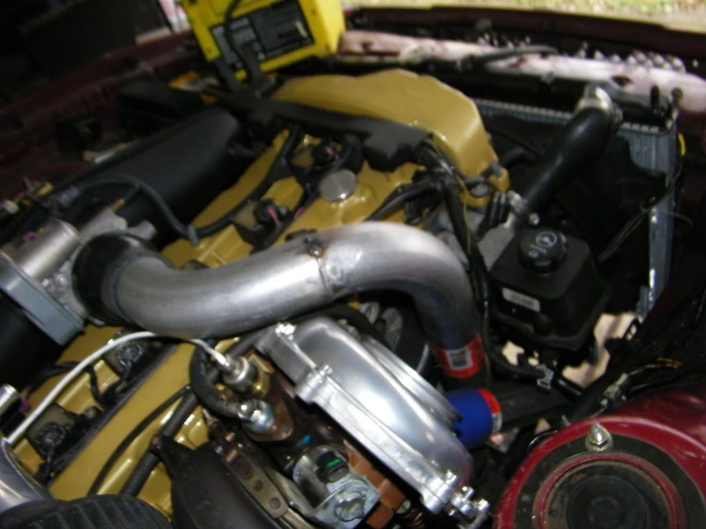

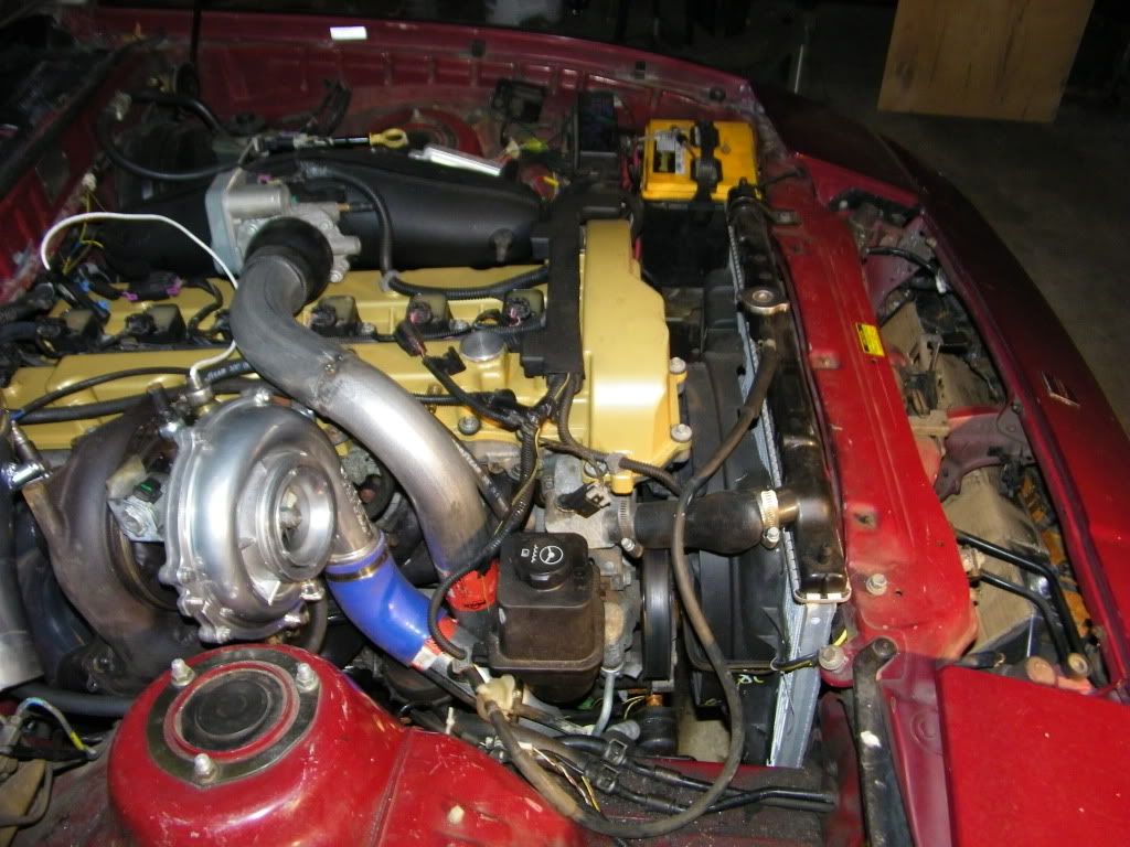

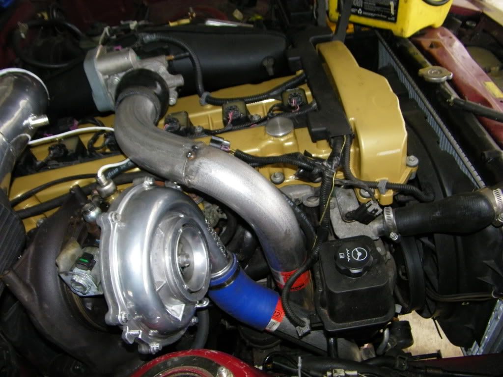

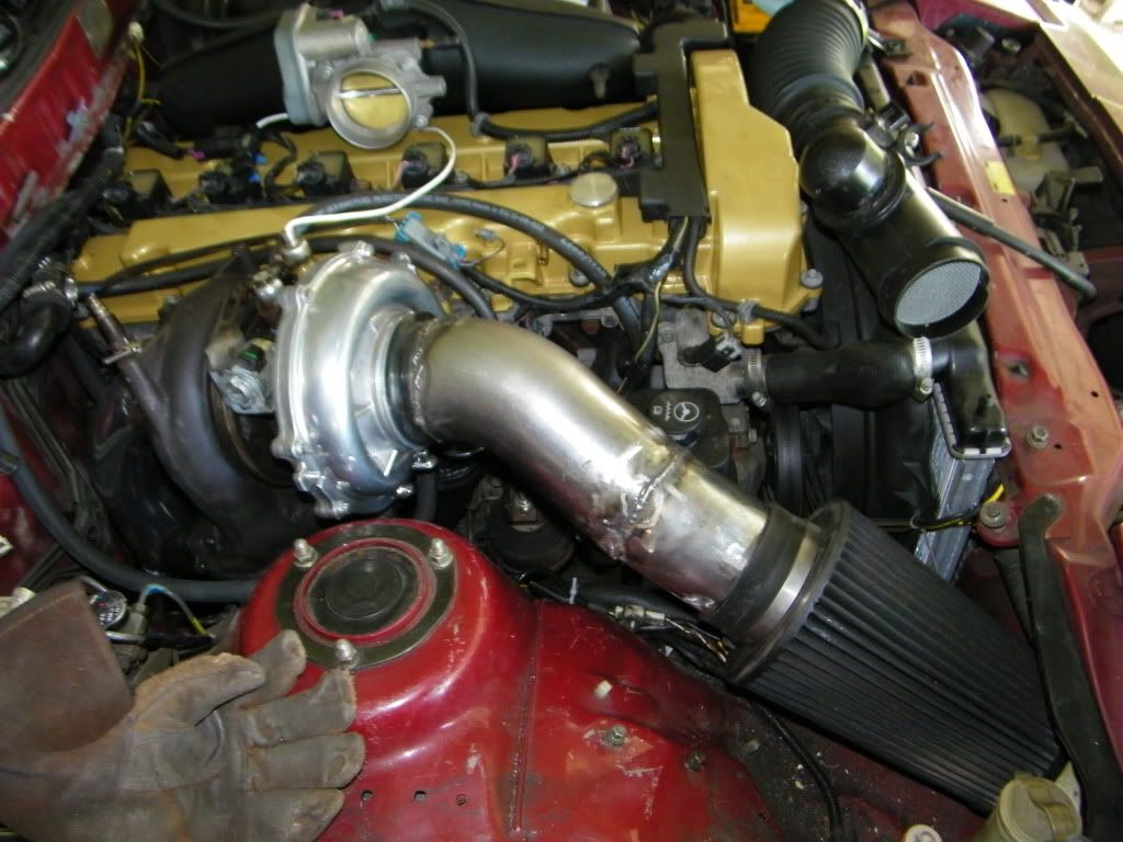

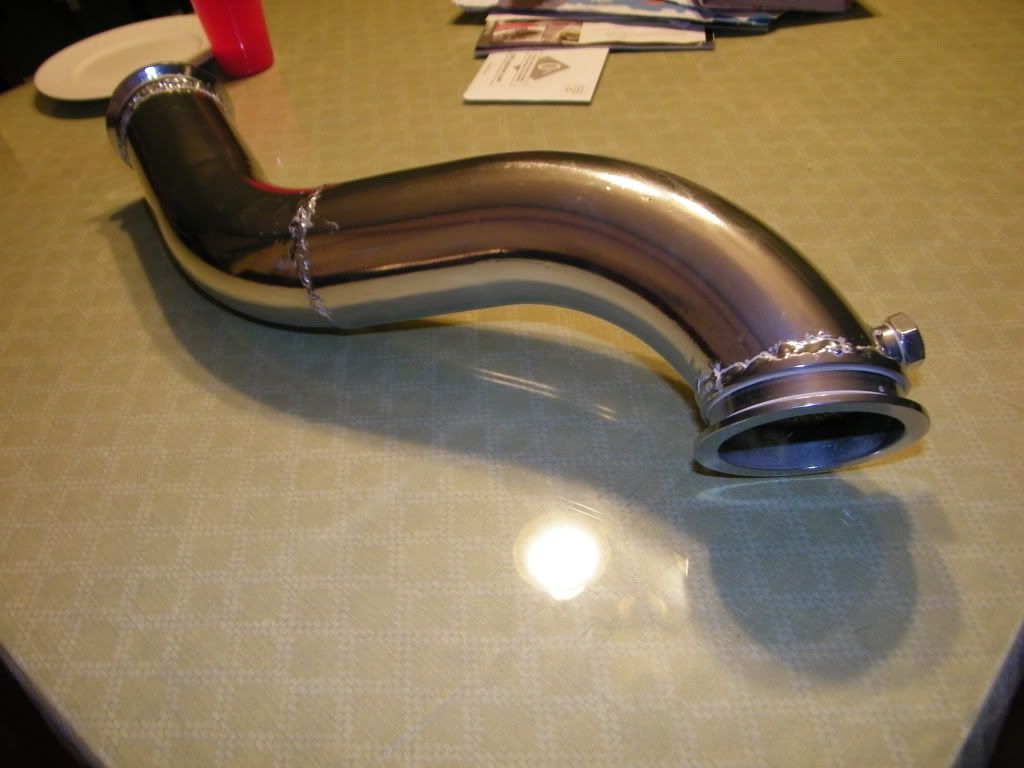

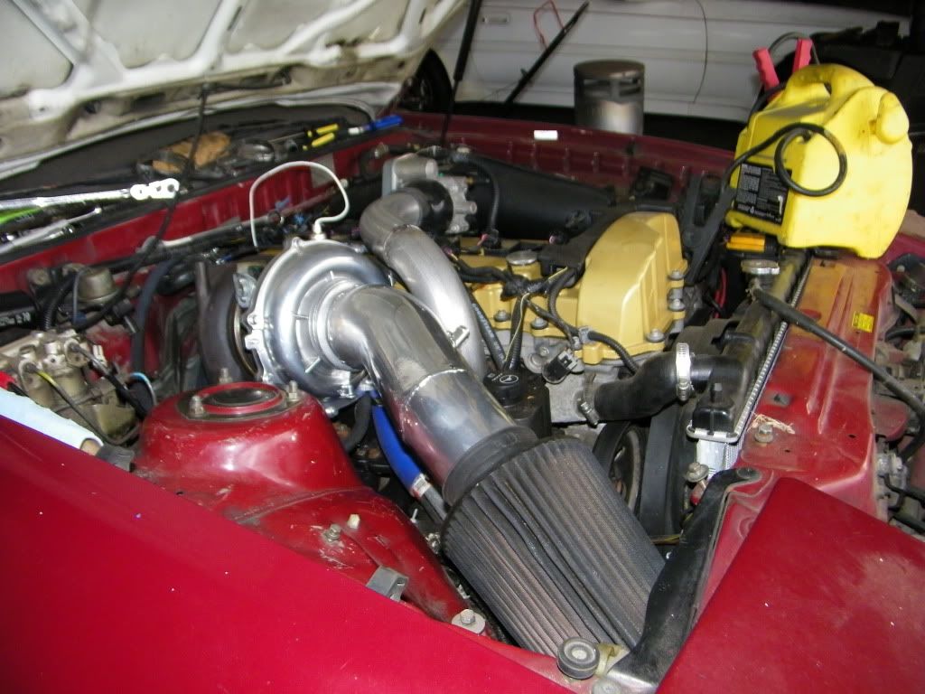

Got my downpipe finished, so now I can do some trouble shooting without blowing out my eardrums. I had to go 2 piece for assembly. I had to use a band clamp for the turbo and decided to use another to mate the two sections of pipe as well. So far they work great.
O2 bung is a welded on spark plug anti-fouler. Get 2 at autozone for $3.59. The upper section is out for ceramic coating.
This downpipe has now spent 8 years in my car in 3 different configurations:
7m-gte
4.2 - N/A
and now
4.2 Turbo
Unfortunately, my welding has barely improved :)

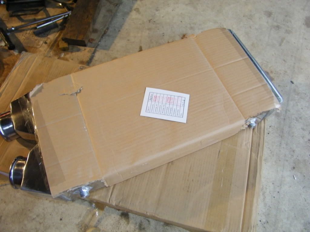

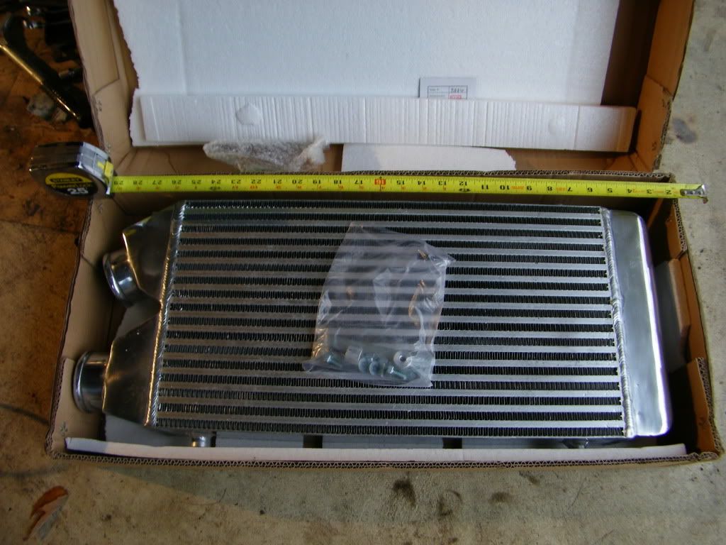

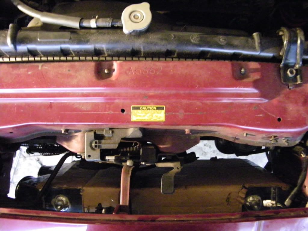

Got my IC in. It's an ebay special. Dual pass. Core dimensions are roughly 20 x 8 x 3.
I used its box to make a sleeve for it. I know that it's gonna take a few test fits to fab up the mounts and I don't want to damage any fins. On top, there's quality control checklist from the manufacturer. I don't know if they actually do all of these things for each IC, but if they do it's a good sign.

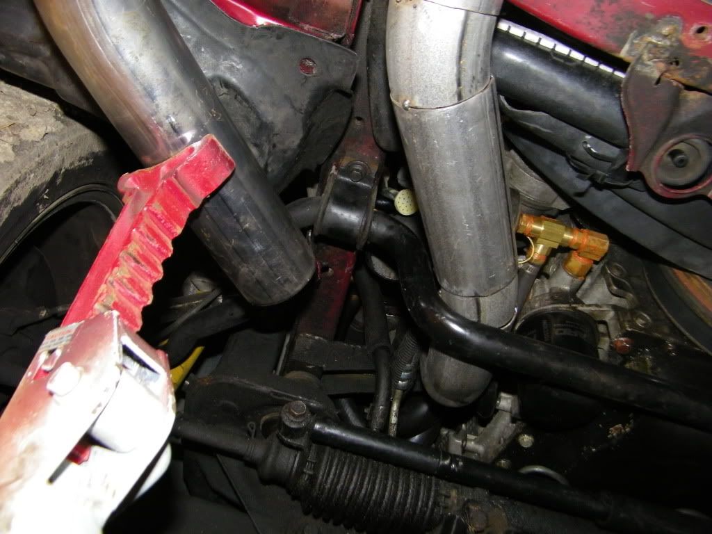

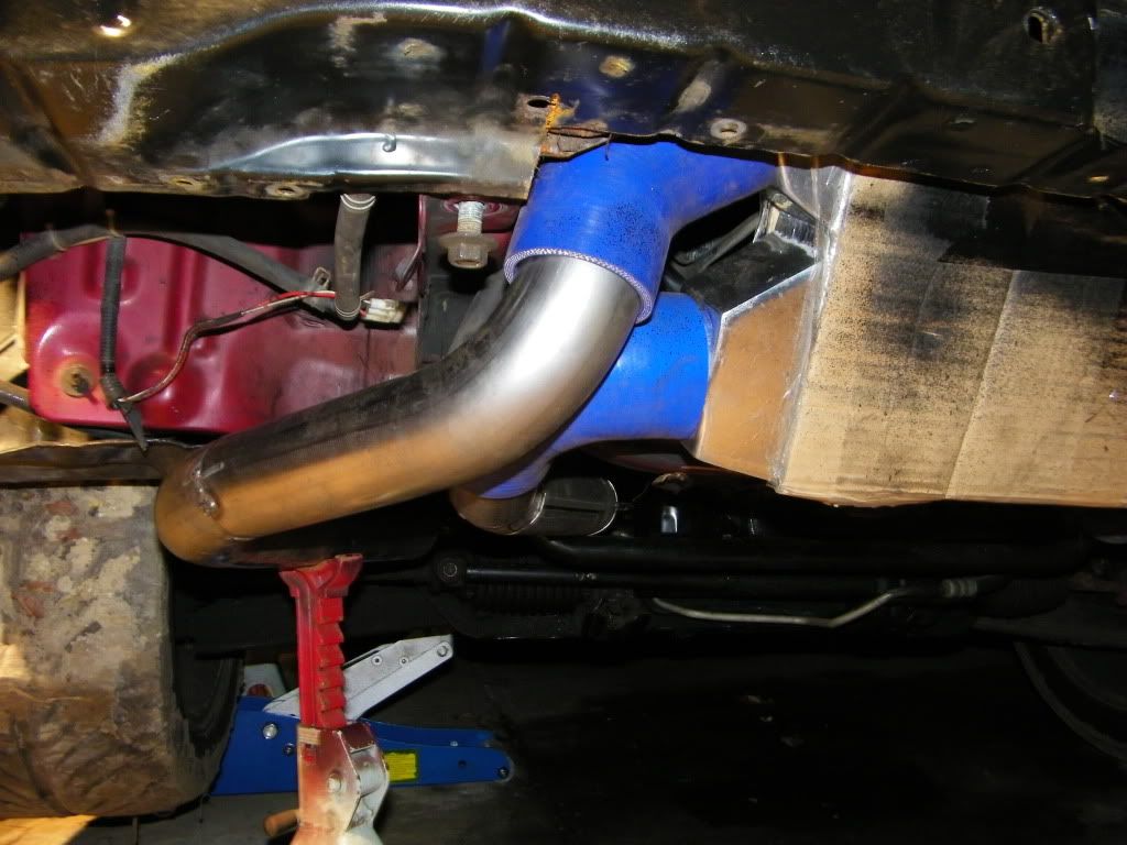

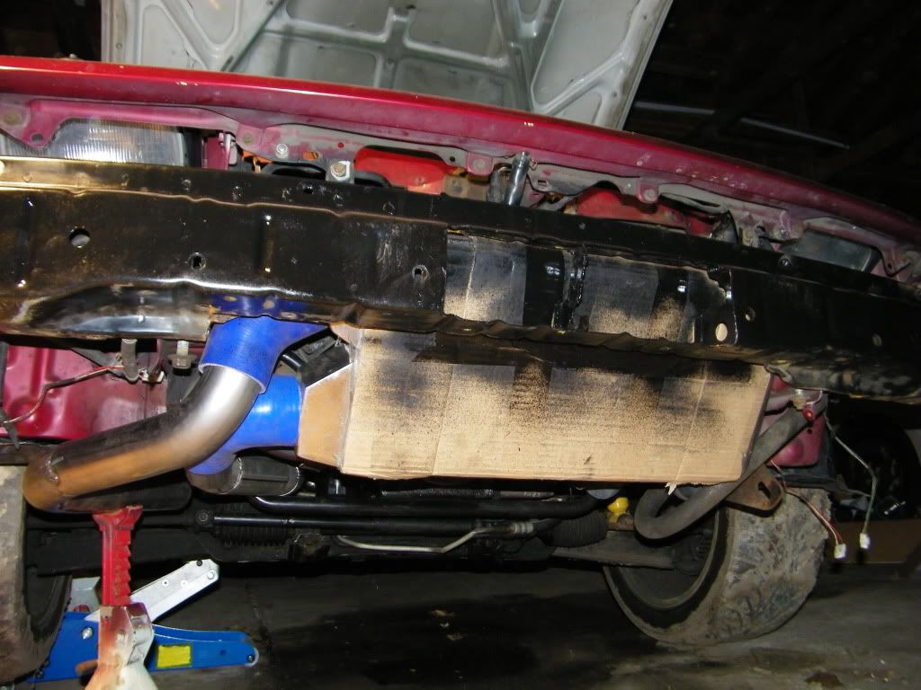

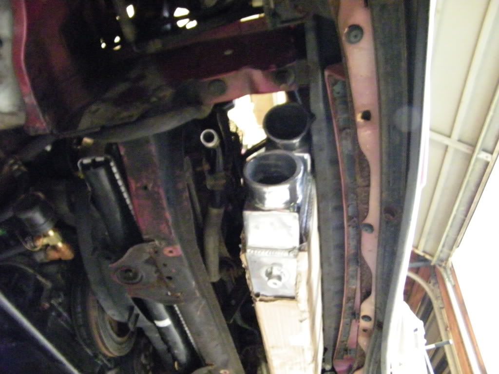

Mocking up...

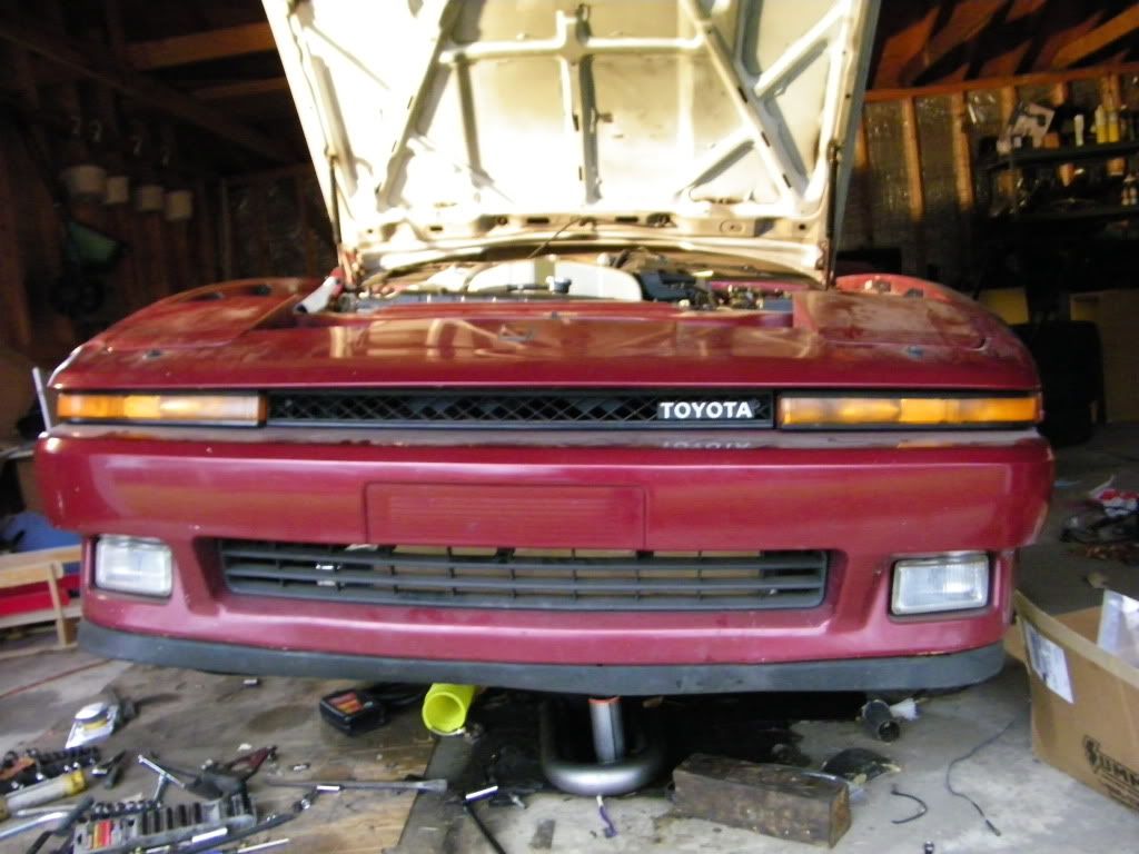

I pulled the bumper to so that I could have a little room to work. Might have been a bad call. The bumper has been attached for the last 25 years and did not want to come off the car. There are many plastic-plastic interfaces held together with M10 bolts. So far about 60% have broken rather than come out. I hope Toyota has some of this stuff available still. Any tips on disassembling the bumper?
