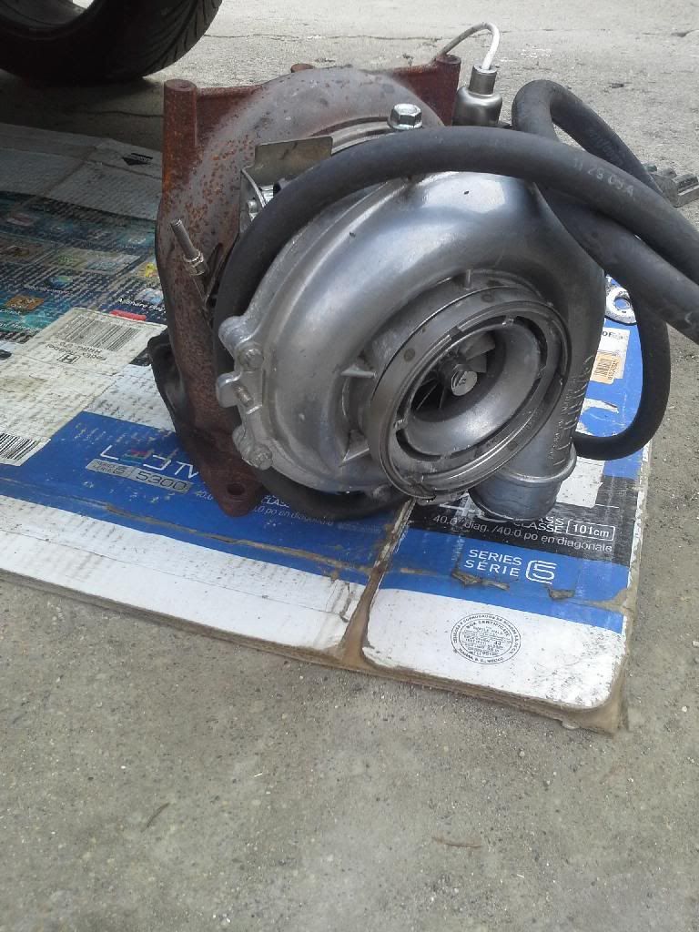

Something you might be interested in, it's been suggested on some of the powerstroke forums that certain GT40 backplates may be able to bolt on to the 3788va CHRA...in case you find you want a little more flow out of it.
-Matt
Interesting that you mentioned this, I was just looking into it. I wasn't able to find any good info. Seems like I should be able to bolt a gt3788va compressor to a gt3782va turbo (ford version) to get a more conventional package. I read somewhere that it doesn't work, but I'd like to try anyway.
From what I can gather, and I might be wrong, but the turbine housing and CHRA is identical between the 3782va and 88va, since the 82 is the stock turbo and the 88 is a direct bolt-on upgrade. If my info is correct (the numbers might be wrong), they moved from a 9 blade turbine wheel to a 10 blade (which is why it whistles louder than than the 3782VA) with both a 72.5/66.5 ind/exducer, and bumped the compressor up from 61/82 ind/exd to 63.5/88 ind/exducer. At the same time, I also heard that the 88 had a better quality journal bearing...apparently they were a source of failure in the stock 82. Don't know if I'd want to upgrade the 82 to a larger compressor for that reason...if the bearing is having issues, the last thing you'd want is more load.
I know I found a thread about someone who mounted a gt4088 compressor onto the 3788VA, but IIRC, they had to do some minor clearancing on the 4088 backplate. I'll see if I can find that again for you.

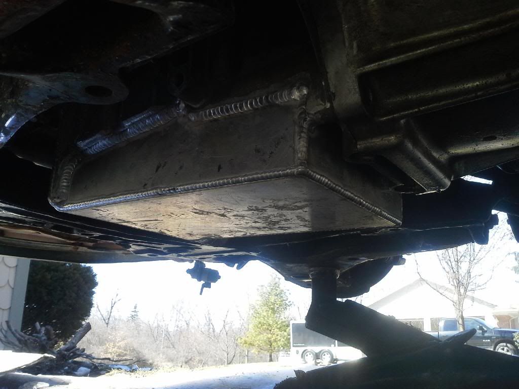

So a litany of errors resulted in me basically giving the cold shoulder to the Supra for the past 4 months or so. I had planned on swapping my pan prior to November so that I could still roll the car into the garage to work during the winter. I was slow and winter was fast, and the poor thing was covered in snow -jack stands and all- before I could work up the drive to button her up.
Things have now warmed up enough that I can at least see that there is a Supra underneath the snow, so I decided to assess.
Oil pan replacement means dropping the crossmember and disassembling much of the front suspension.
The suspension is mostly back together. Need the impact gun to finish the sway bar links and I'm missing a nut here and there.

Here's the new pan:
This is NOT limequat fab skills, this one was farmed out. Once again, the bolt fairies were active over the winter and made off with some my hardware.

Damned bolt fairies get me all the time, too. The pan looks nice.
It also looks like the stock brace that goes across the back of the crossmember won't fit there anymore. Any plans to replace it?
I don't think I've tried it, but yes definitely need to replace! Maybe with something that will double as a skid plate. Keep me from high-centering on my nice welded aluminum sump.
