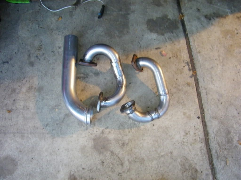

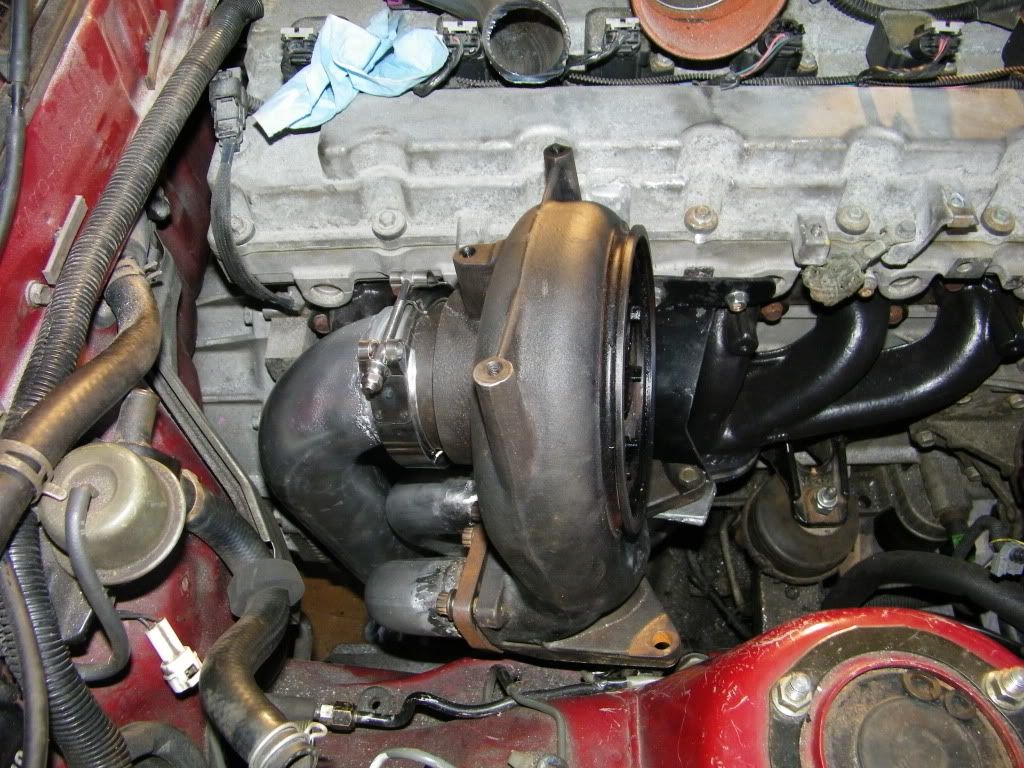

limequat;1652022 said:Haven't posted for a while, but it's not for not working on the beast. A lot of fabrication at this point, so the going is slow. Here's what I've been working on:

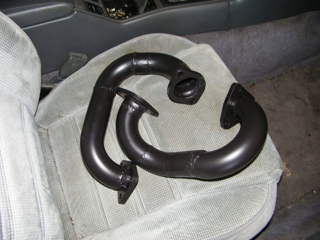

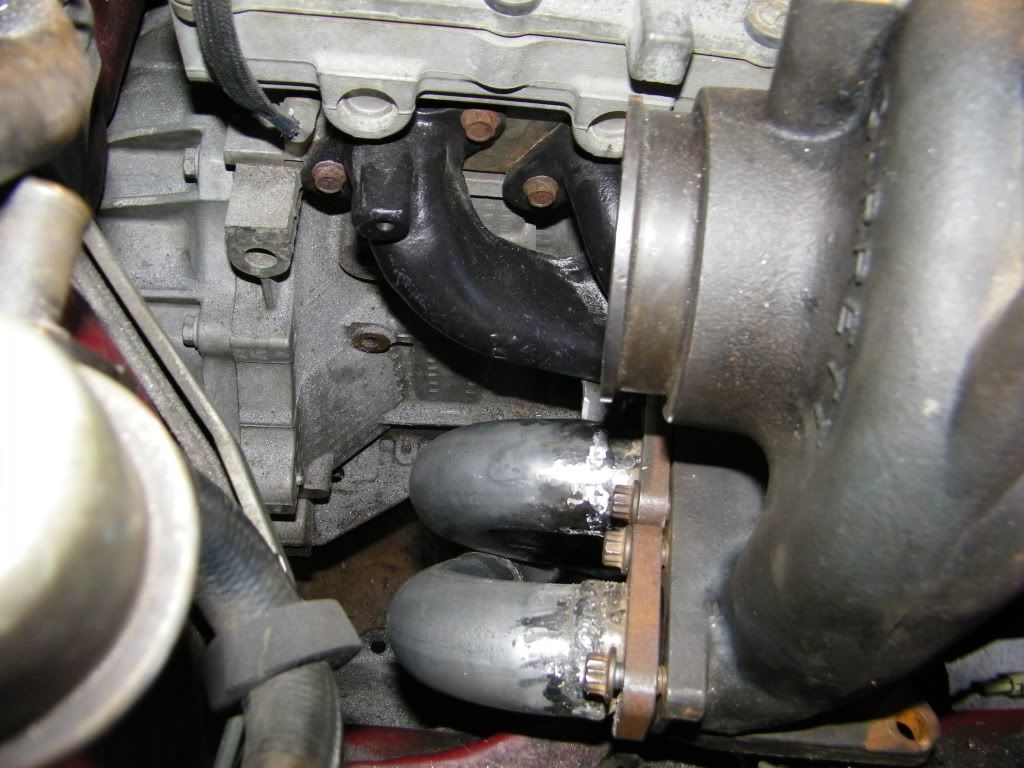

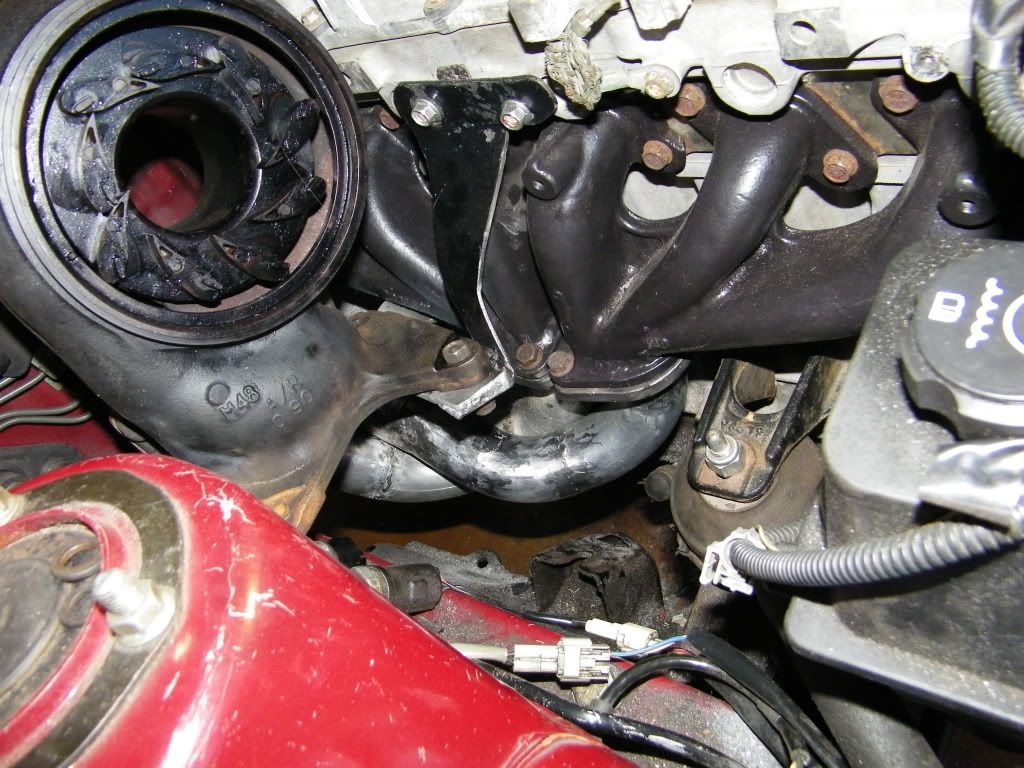

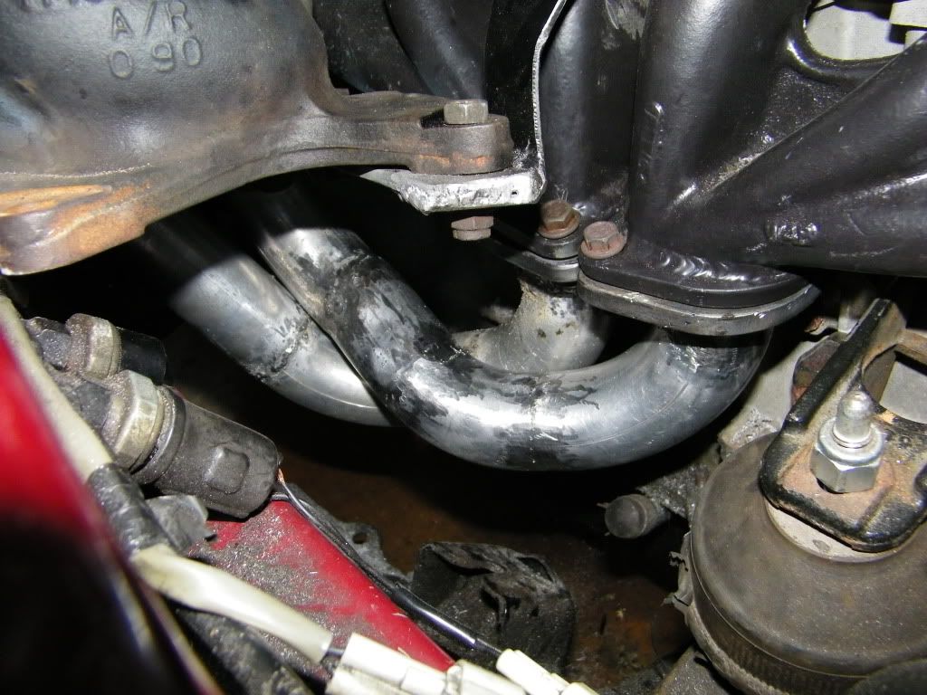

From left to right they're the downpipe stub and 2 up-pipes. Welding is mostly done need to do some finish grinding and sanding. Hoping to rig up a pressure tester tomorrow to check weld integrity. Then on to get ceramic coated. Here they are getting test fit, please excuse my flux core welding skills:

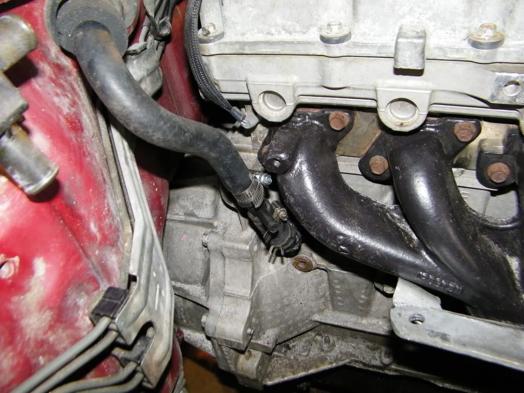

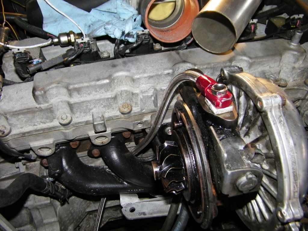

The above is a good view of my stock manifold, chopped, flanged and ceramic coated by Tom at Stovebolt.
After I get these banged out, I'll start on oil and water lines to the turbo.
what are your plans for the opporation of the vanes on the turbo? is it off a 6.4L, total understanding of its geometry and oppertion can be a VERY strong combination with a 4.2 i6
