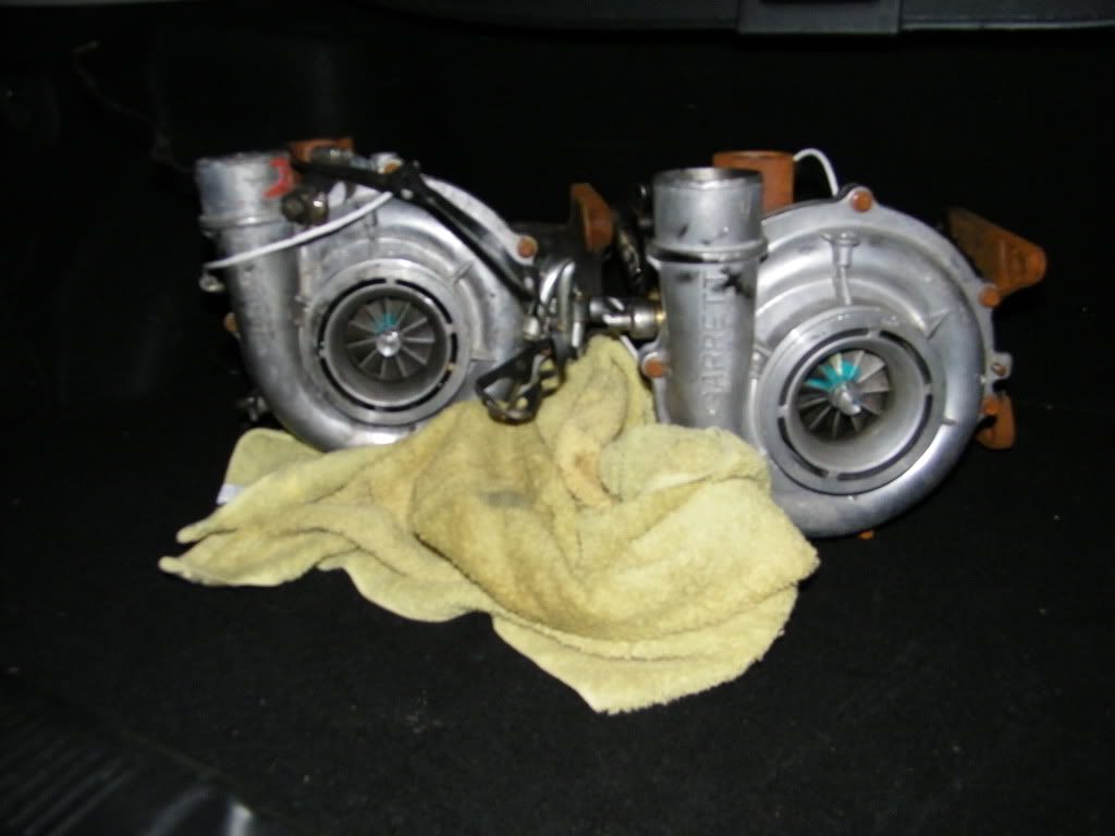

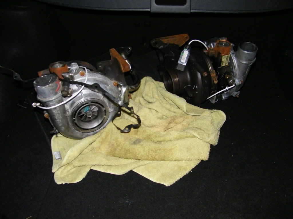

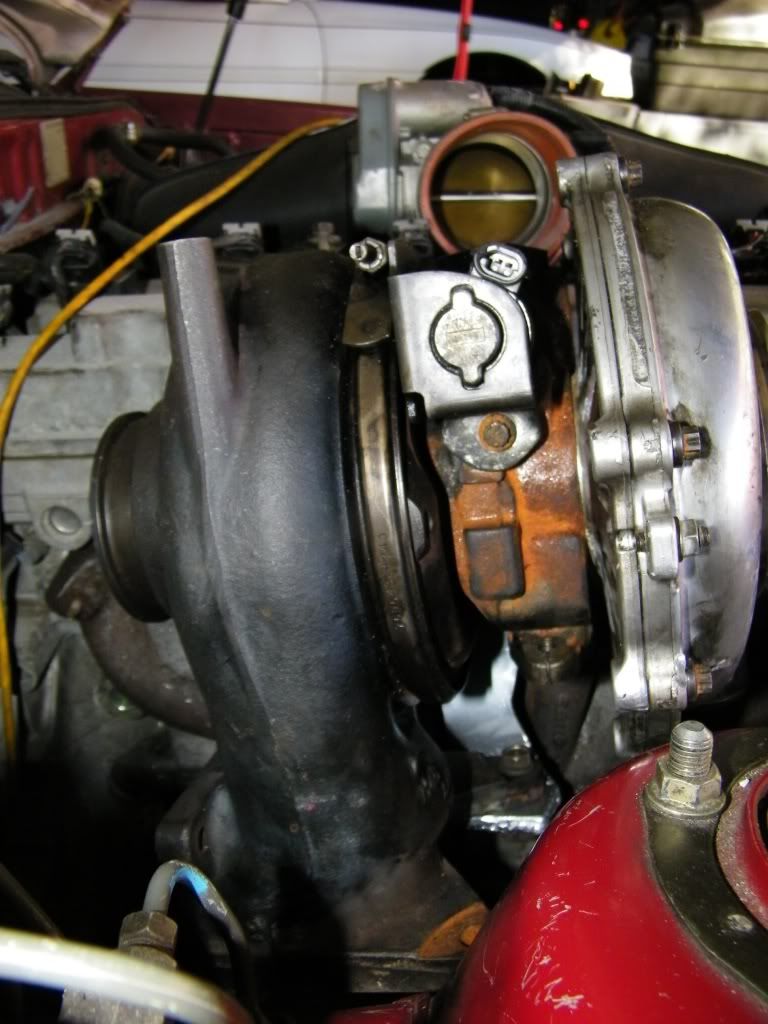

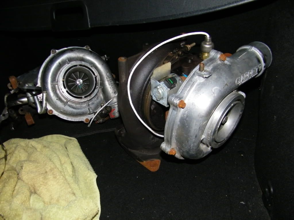

After taking out my A/C lines and some other minutia, I convinced myself that I will be able to fit my turbo in after all.
I have two GT3788VA off of a Duramax. These are the Garrett GT series GT37 frame, but with a GT40 wheel and variable geometry on the exhaust side. One of them will flow over 900 CFM, so the other is a spare. There are few people on the tubes that have used these turbos with varying success. Those fortunate to have stand alone engine control can program an output for the turbo. Others use wastegate actuators to control the veins. Here's a video from someone in the former camp. Spool to 25 psi is almost instantaneous on all of 2.2 liters:
http://www.youtube.com/watch?v=y4lDkm6Xj5g&feature=related
My turbo is only slightly bigger, but with an additional 2.0 liters of displacement, I expect spool to be incredible. Here's how it works: The PCM drives a solenoid that in turns controls oil flow to a slide ring on the turbine. Full oil flow, the turbine is choked to almost nothing. These turbos will make boost at idle.
Low oil flow, and the vanes open up. No need for a wastegate.

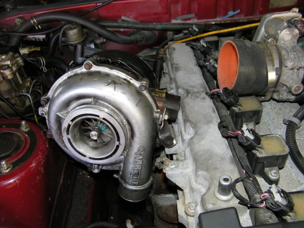

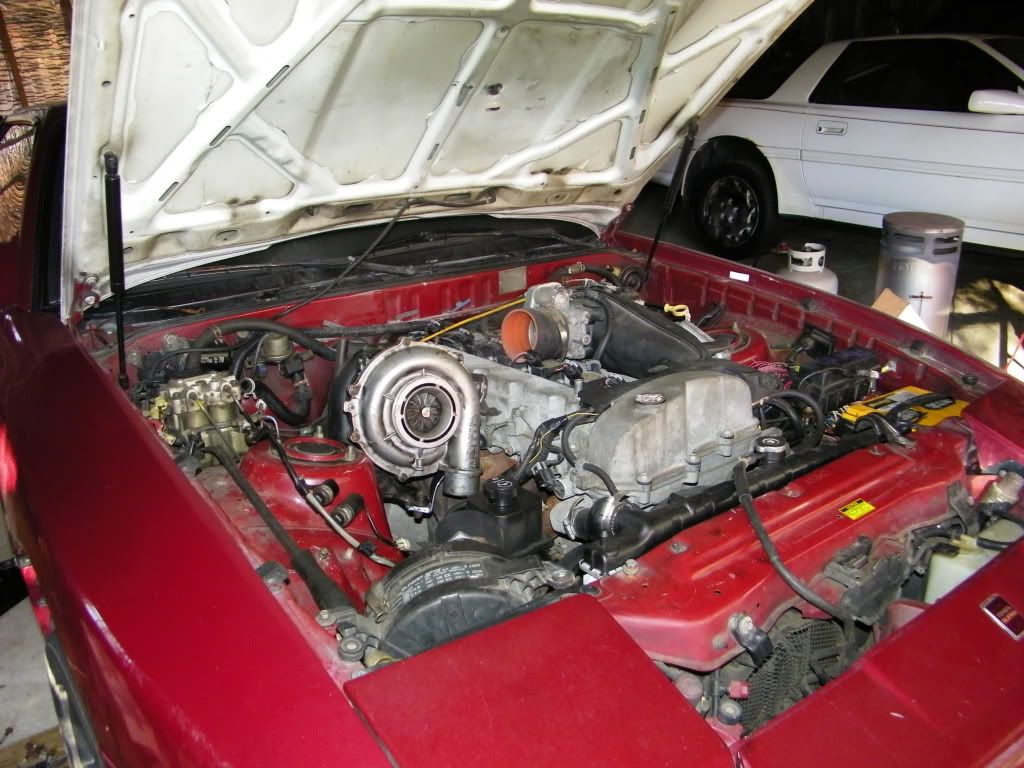

I think this may go with some work:
6,616
That last pic a photoshop or actual mockup? My eyes are tired, but that looks like it could work! :)
limequat
Dissident
Apr 1, 2005
532
Detroit
Actual mockup. I've since clocked the compressor 90 degrees and it's looking even better.

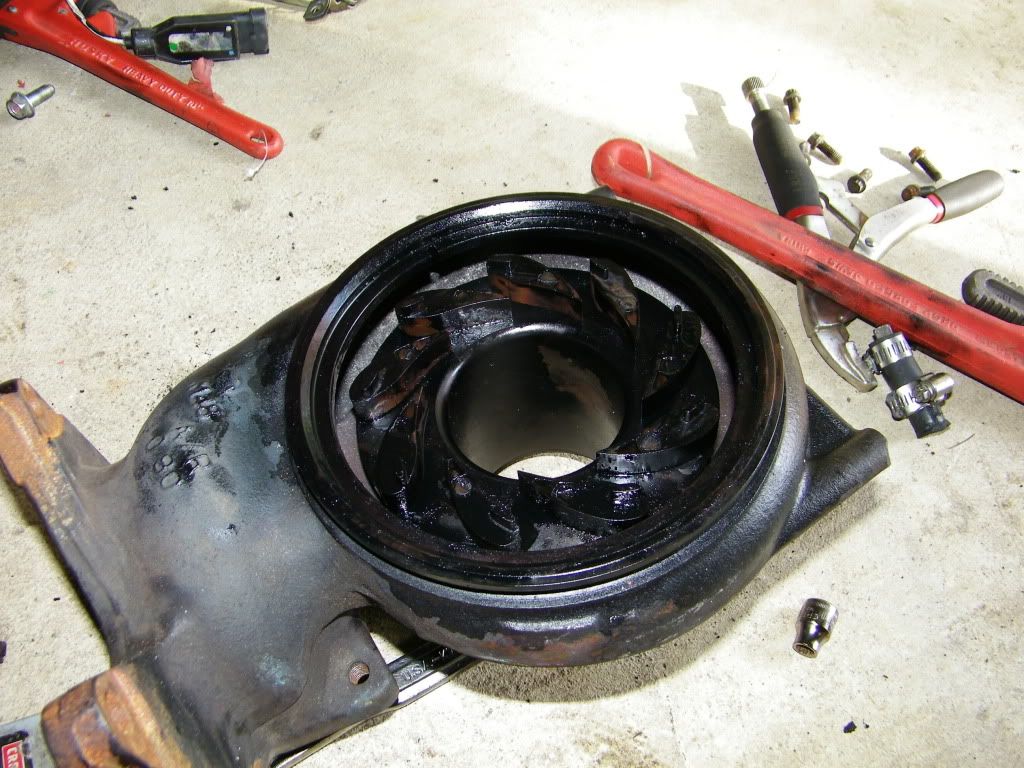

Sidebar: Diesel soot is the nastiest stuff.
thedave925
Since 9/16/05
Nov 9, 2005
626
East Bay, Cali
This looks promising, V-band clamp and some skill can yield results.
Almost looks like you could retain the AC, with dropping the low hard line some.
Is there some kind of sleeve to put over the coolant line feeding the heater core? That would be hard to get to later on if it split from heat.
Exactly what I was thinking.
I think I'm just going to reroute it. The nipple coming out of the block is actually a thread in fitting. I'm planning on replacing it with a 90 deg elbow to free up space for the downpipe.

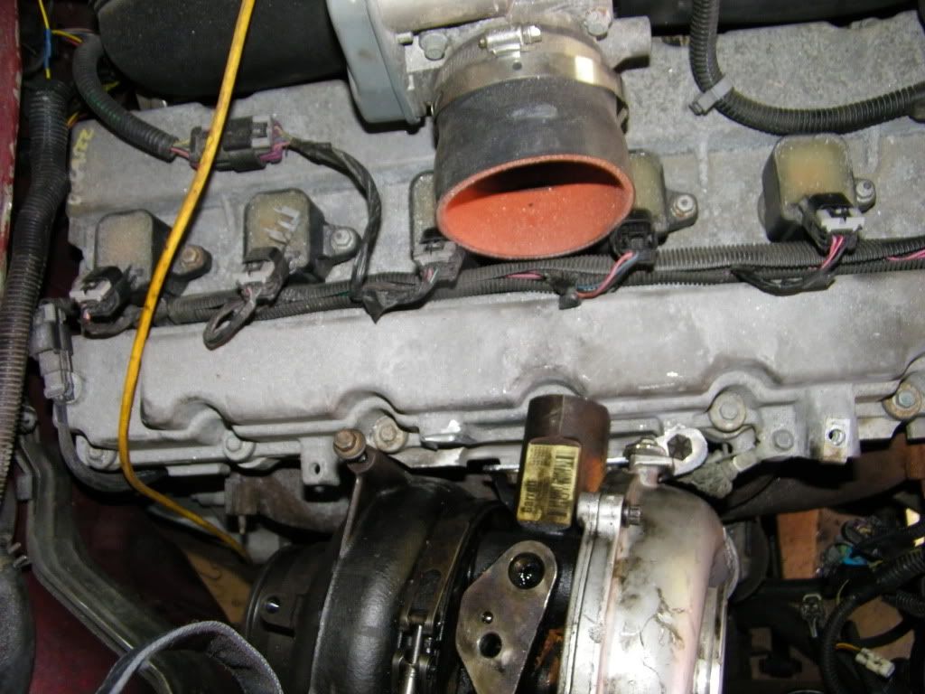

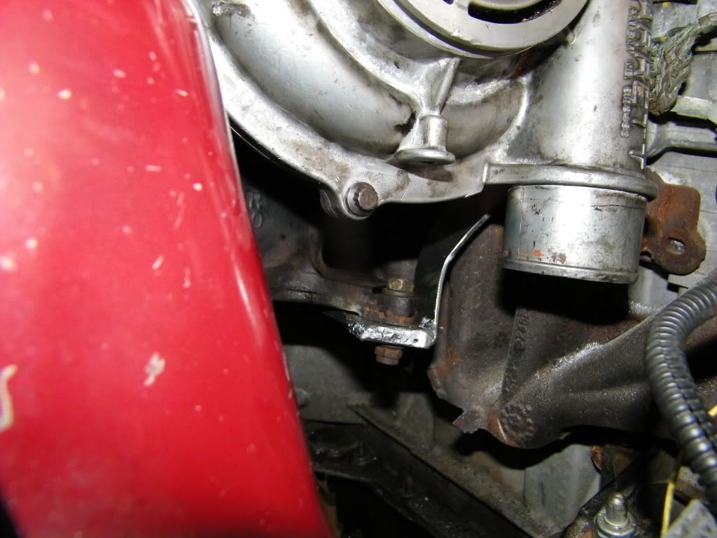

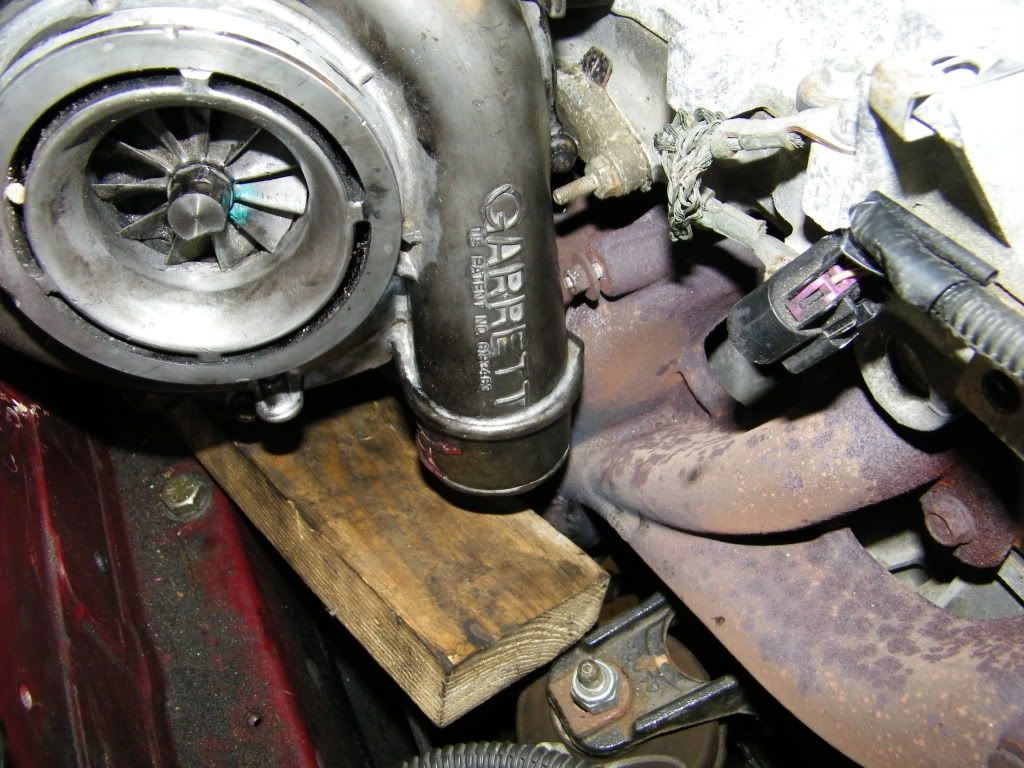

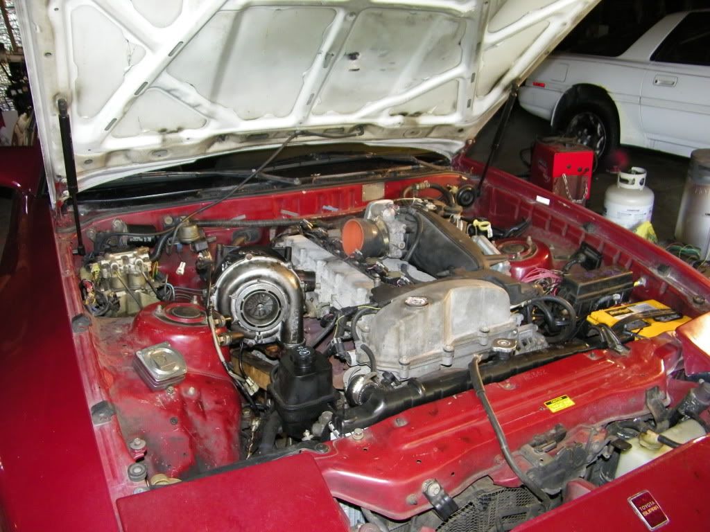

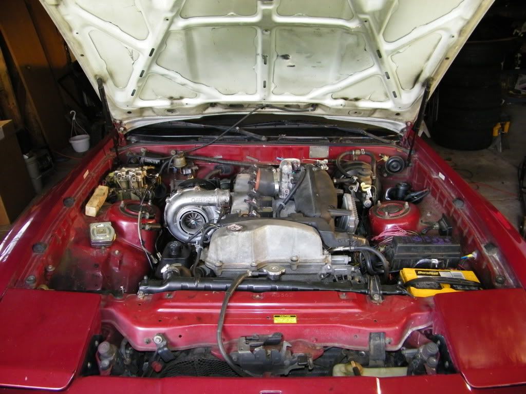

Turbo is bolted to the engine. Made a bracket using the mounts for the air injection and then down to the block. Another L bracket holds the top of the compressor housing. Got started on my downpipe but ran out of weld wire.

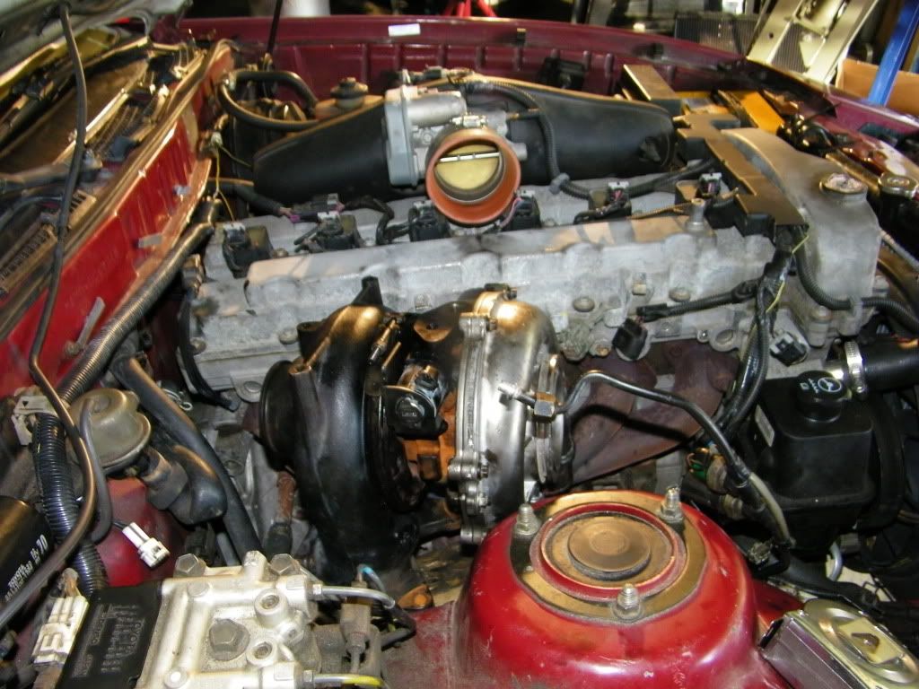

I'm going to be using the stock manifold modified by Tom Langdon at Stovebolt. Next I'll build a pair of S shaped up-pipes to feed the turbo. Hard to see from the top.
