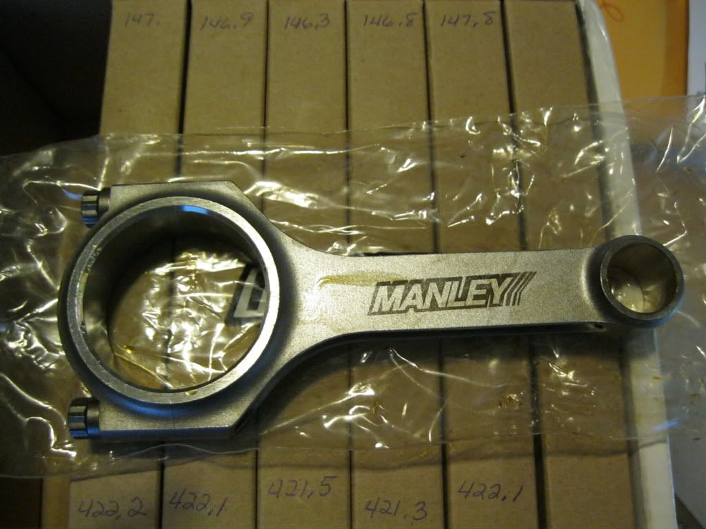

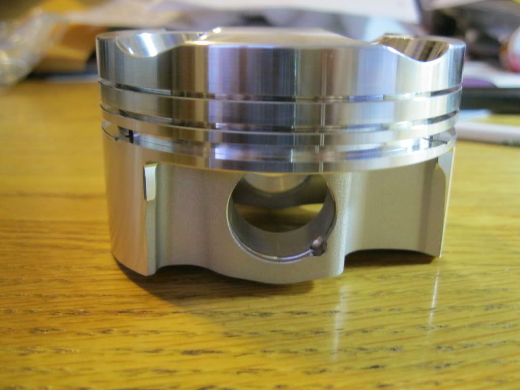

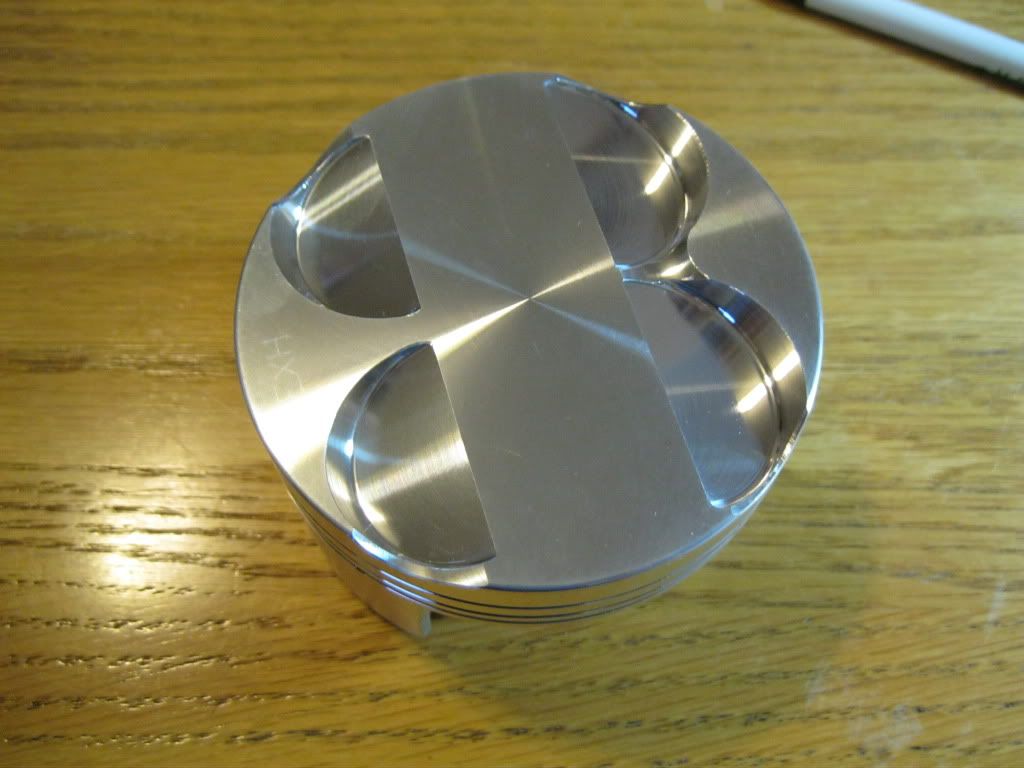

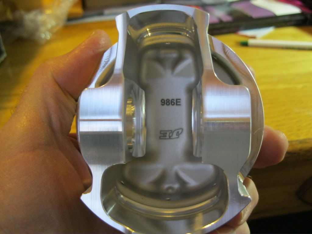

The latest: The pistons and rods showed up today. I snapped a few quick pics. They will be going out in mail tomorrow heading for Fargo. I don't know the weight of OEM pistons, these weigh 335 gms. They are the JE flat tops, and Manley rods.
Now, another 3 weeks and we will be ready to reassemble. Too bad we have a long f**cking MN winter ahead. We will take our time. A lot of small things to check.
