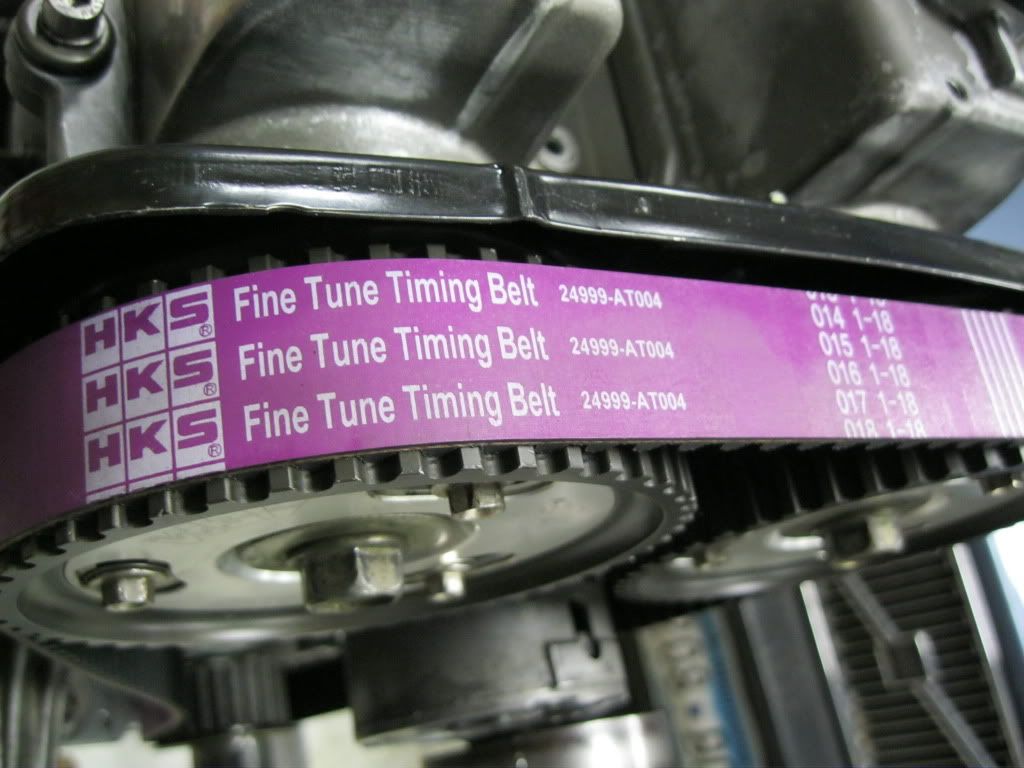

I have an HKS belt. Sure is pretty. Should have more pic's to post up in a day or so. For right now, this will be my coil set up.

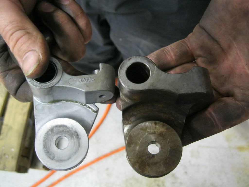

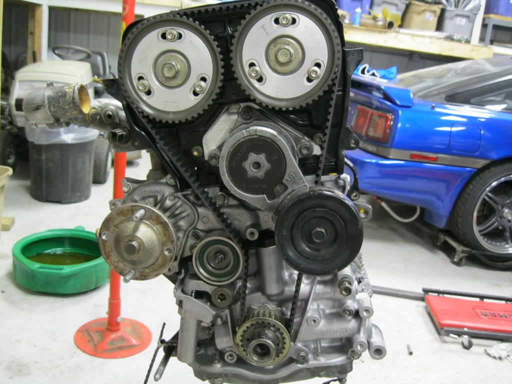

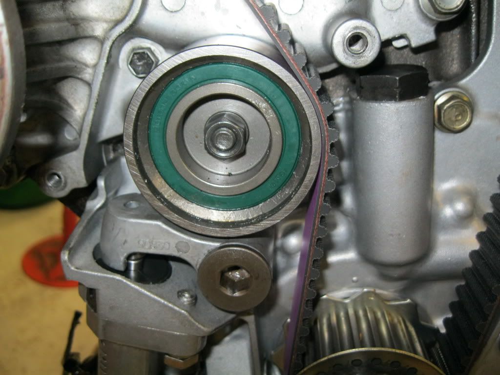

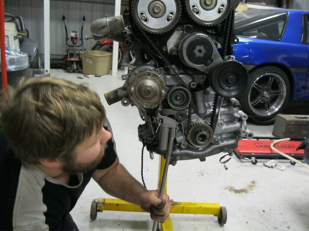

Tonight Sean and I worked a bit on the 2JZ. We had to remove the Crank pulley to install the billet timing tensioner bracket. That mother was on there tight. 239 lbs of torque. The tensioner should have been put on during assembly, but I didn't find a deal until we already had her back from the machine shop. The billet MVP bracket is a heck of a lot heavier than the OEM version.
We also played around a bit with the mount for the LS2 coils. I really liked the brackets and set up of the previous web site I mentioned, but price was too high for what you get. More on this later.

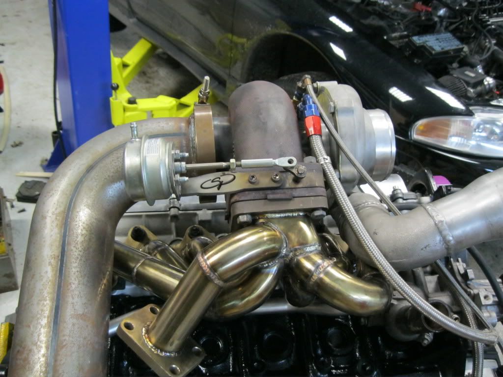

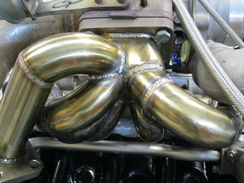

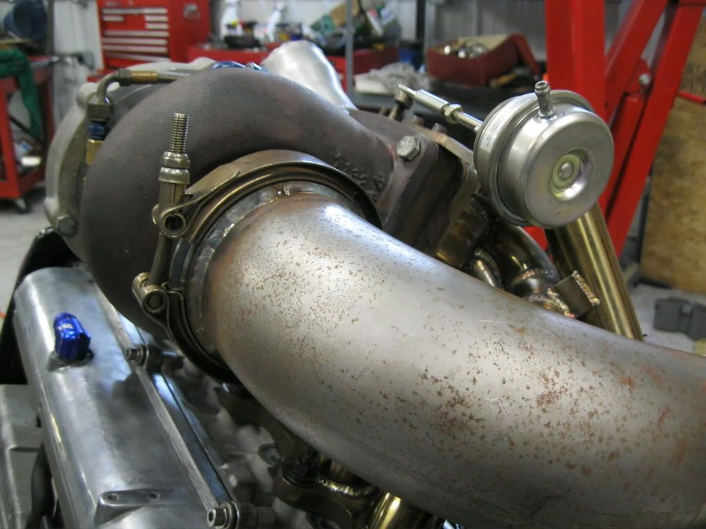

A couple of pic's of the new manifold and what we are up too:
I snapped these after I got home from the clinic. Sean has the new manifold bolted up, we are mocking it up because we are trying to figure out the new position of the wastegate. This time we will put it under the manifold, instead of above. This will allow us more room around the spool valve and more room near the 4" down pipe.
Sean plans on dropping the engine in tomorrow, taking measurements for where the tubing will need to be cut and tig welded so the WG is out of the way, plus make measurements for the downpipe.
