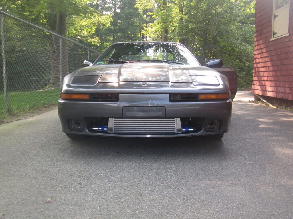

thats the kit i got, it says s13 s14 s15 etc, but its just a universal kit. i had to cut and weld a few pieces. i just cut one u tube in half and spun one half around, this was PERFECT for the tube coming from the turbo outlet.
got everything together and running today, the turbo spools a lot quicker, and it just looks fuckin MEAN.
too dark out now, i'll get a front shot tomorrow.

89supraa;1378369 said:
Were you able to leave that steel bumper bar with that intercooler? By the way awesome build,looks great!
yup, i had to finesse the pinch point in with a hammer a lil bit, but this was just to give me clearance in case the IC flexed for some reason, i wouldnt bend any fins. a 4" could easily fit w/o modification to the bumper beam, but the coolant res would have to move.
Yeah, I had to move mine. It's cool though, the smaller size battery I'm using, gives me just enough space to sit it beside it. You can just glimpse it in my build thread video.

i've noticed that the intake side of the IC stays COLD, and got about 500rpm faster boost.
got my tial wastegate in yesterday, gonna try bolting it up today, i might have to order an adaptor flange for it though.
