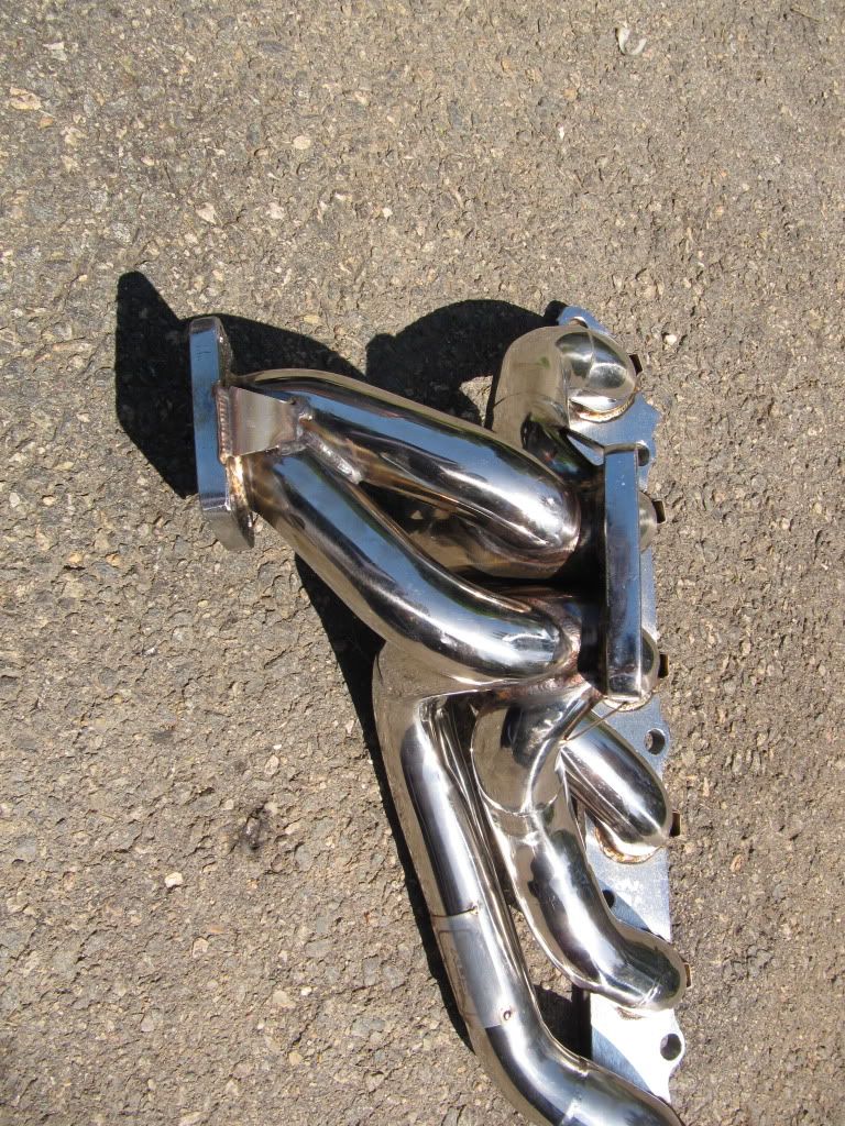

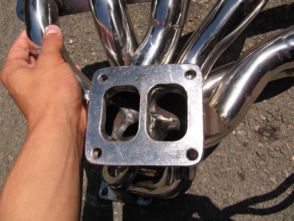

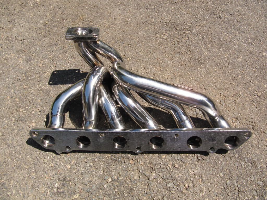

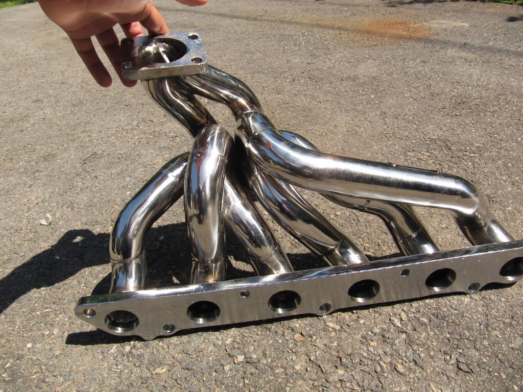

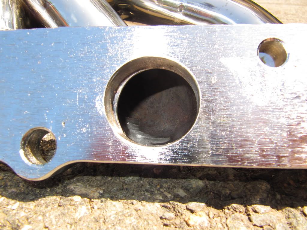

oh and believe me, pics will DEFF come when it comes in. i can rarely find any good pics of the ebay manis, so i'll supply em.

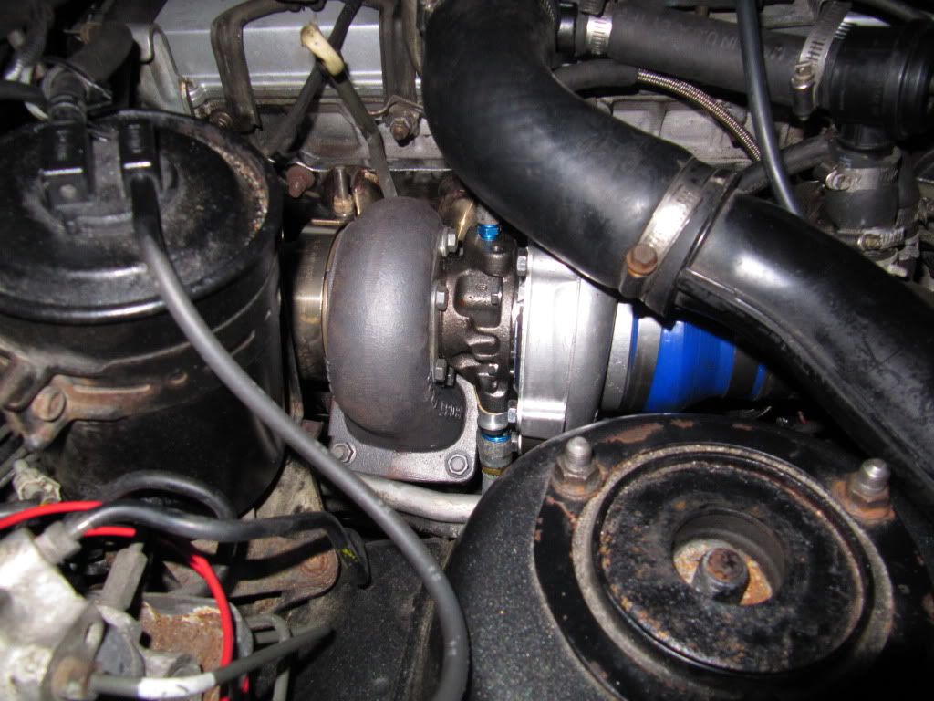

well picked up the mani this morning, prolly took me about 5 hours to finish completly but i alread had everything removed from the car.
i love it!!! the boost does come on kinda slow, but i prolly just gotta get used to it. its set about 8psi now. i had to jury rig some of the stock IC piping to get it to work, after blowing off a hose, and breaking the plastic angle piece near the fender. now it runs smoothly.

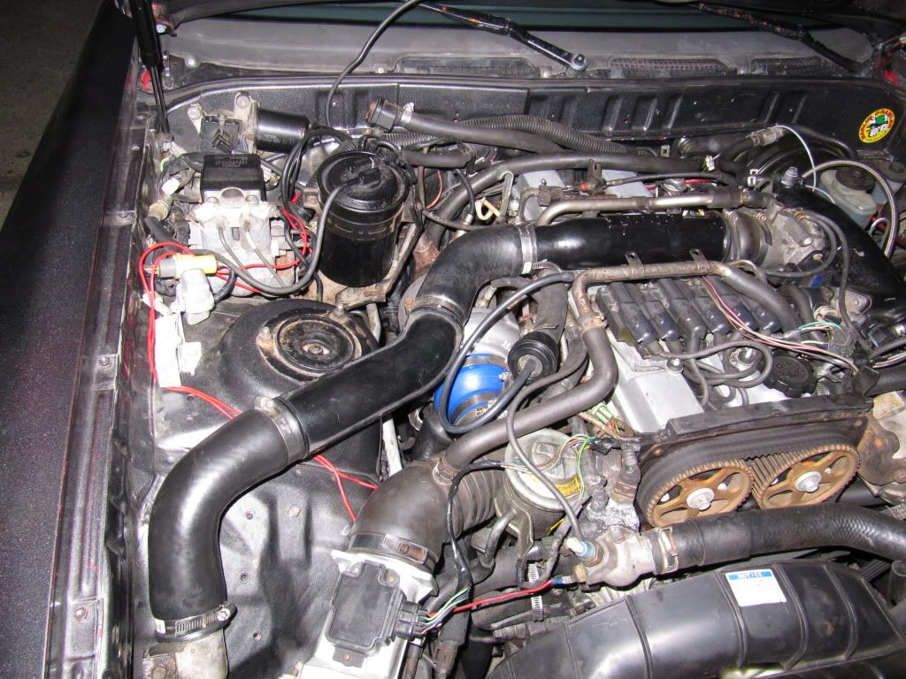

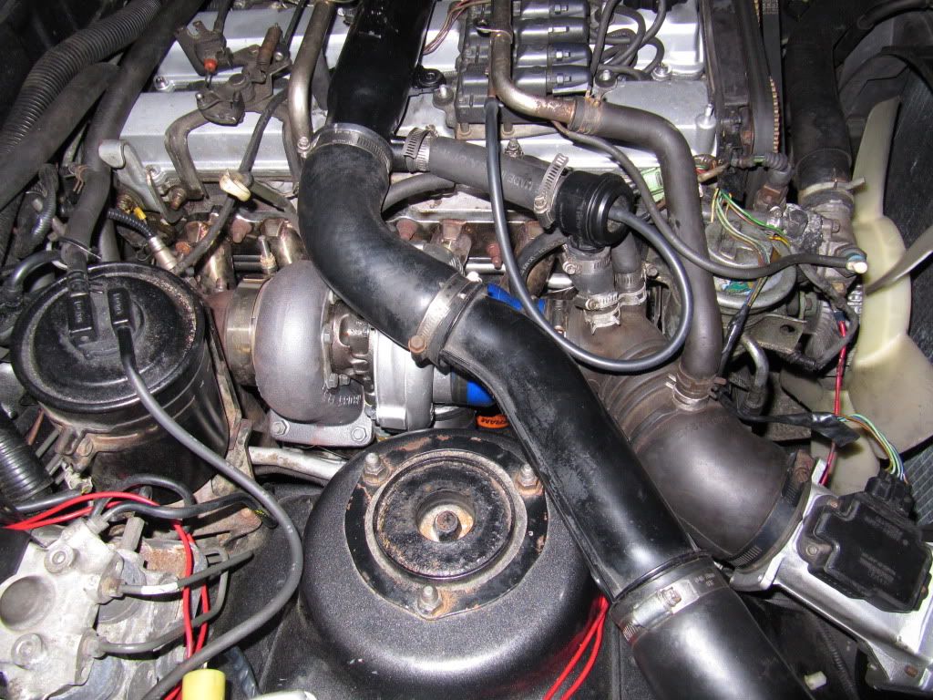

some pics for ya'll followed by exhaust sound clip.

hey rick.i guess everything went smoother then i thought it was gonna.nice to hear it running again.
the wastegate is working good?

thanks, it did take a lil bit of grinding and some light hammer work to get the turbo to clear the mani since i didnt have a riser, but it did fit good. the damn stamp on the mani caught on the oil filter housing so that came off.
the wastegate does work pretty good, im happy with it. my BC wont bring the boost up for some reason, im gonna see if i can try my buddys EBC next week.
thanks for all the tips. they helped out a lot.
