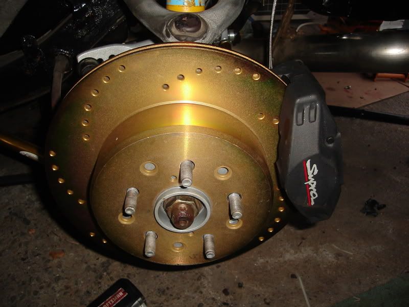

.i bled the brake's with a left side caliper on the right side front.long story short,autozone kept giving me the 90 n/a 28mm 300zx caliper and it doesn't fit over the 350z rotor.i ended up getting one from advanced auto,but that was a left side in a right side box
.i got another today that will go on to the right side,once i get some more motul brake fluid.the brake's feel great,but the master might not be enough for the caliper's.i am a little low on fluid in the resivour,but honestly don't think that's it.one pump of the pedal and it is nice and firm.
