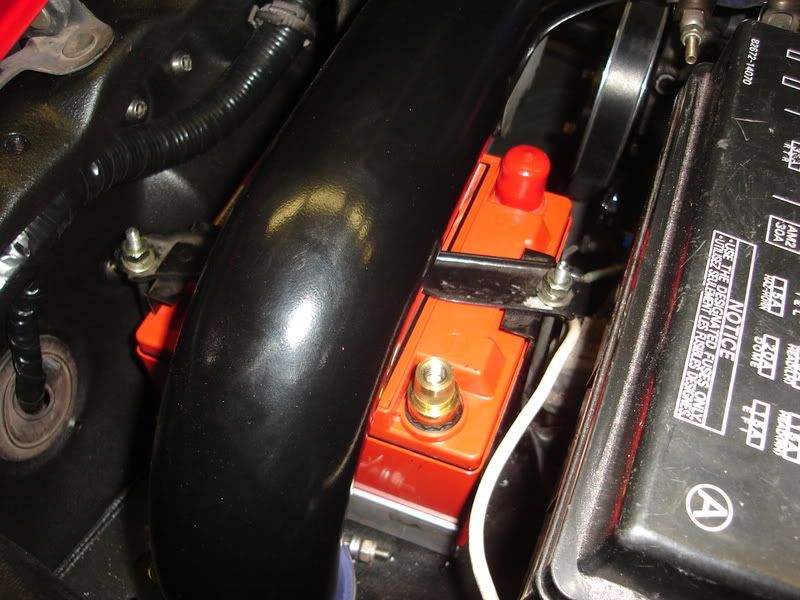

today i mounted my dp,which took all of about 2 minute's.i also mounted the odyssey pc925mjt under the ic pipe where the battery tray once was.i used some angle iron to hold the battery from sliding side to side.i used the factory hold down bracket to keep it held down tight.

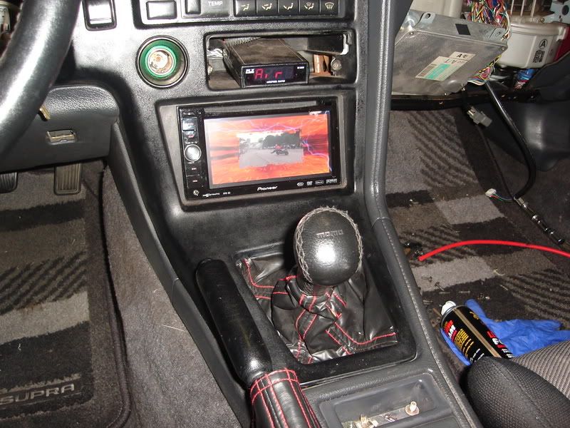

i now have my diff and driveshaft bolted back in.i filled the r154 with some redline mt90 and bolted up the v2 shifter w/momo knob.

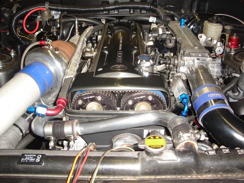

i did have a problem with my upper radiator hose leaking.the 2j waterneck sit's lower then the 1j and 7m,making the hard pipe go up to meet the radiator.the worm clamp's wouldn't tighten up enough to stop the leaking even with the motor not running.after i hear the motor run and i'm confident,i'll address little thing's like this.i might just get a set of silicone hose's,but for now i got some little t-bolt clamp's to help seal it up.i was kinda nervous cranking down on the plastic end tank with them though.
in this pic you can see the angle of the radiator pipe and the little t-bolt's
another pic from a little further back.the 1jz's look great in the supra bay,but the 2jz is even meaner looking.the motor sit's so high in the bay it fill it up nice.once the hood is on it should look huge:)

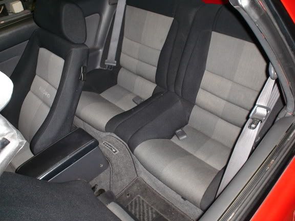

i started putting my interior back together.i ended up using uncle sam's tax brake check to buy something for the supra;).this thing fit's like a glove and bolt's up with the oe metal bracket's.

i bought the recaro interior back in 05 and love it:).i do have the five piece set,but never installed the fifth seat belt.

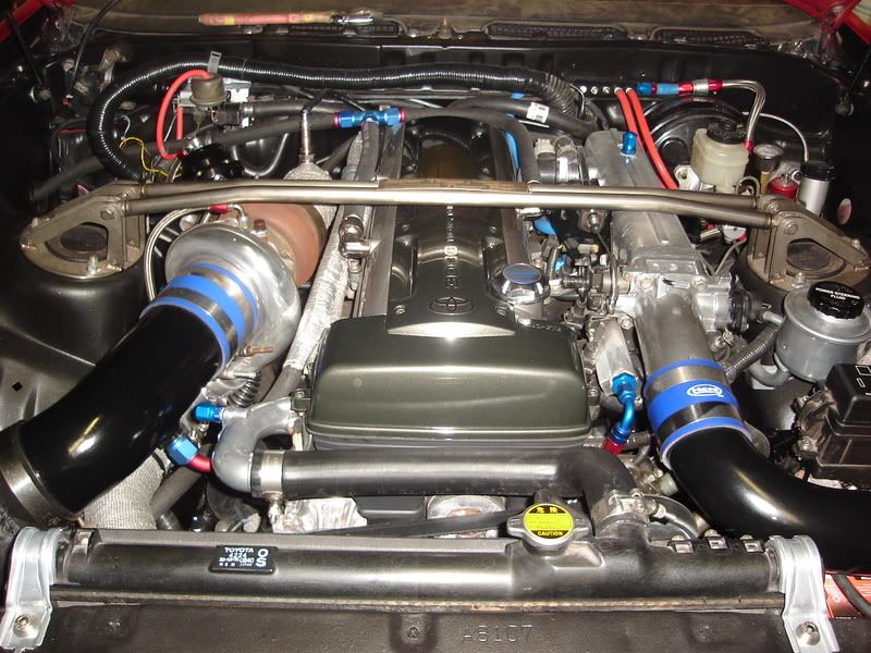

well,i'm pretty much done with under the hood.really just need to scrub it clean and polish up a couple of thing's.i got my intake pipe and mid-pipe back from the welder.i powdercoated the intake pipe after work and will most likely get the exhaust together tommorow.no more open dp and i might actually get to run it for awhile without filling the garage with co2's;).i have some new cv boot's and wheel bearing's that should be in tommorow from yota,so i can get the rear together.i should also have my front caliper's bolted up with the new goodrich brake line's i got today.

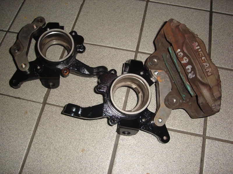

i got my exhaust all bolted up.i started it up and she sound's nice,but still got a leaky radiator.i thought it was the upper hard pipe,but it's got a hole for sure.i do have a cuople of spare's to replace it ,just didn't want to pull it all appart again.
i'll be playing around with the brake's tommorow.i need to grind the "nissian" off the caliper's,then paint them up.there reman caliper's,so not much prep work before paint.

Yota knows you by name? If you weren’t doing the swap that would be a really bad thing!
You said you were using Nissan brakes, what are they off of?

yota built my car back in 92 and now it's growing more powerful;)
91-92 nissian 300zx.they do need addapter bracket's.this pic is of the core's bolted to the mkIII hub with the addapter's

This is something I am going to have to remember as big brake kits are way too expensive! (but you can also go mkiv brakes right?)
Is the adapter bracket something available to purchase?
