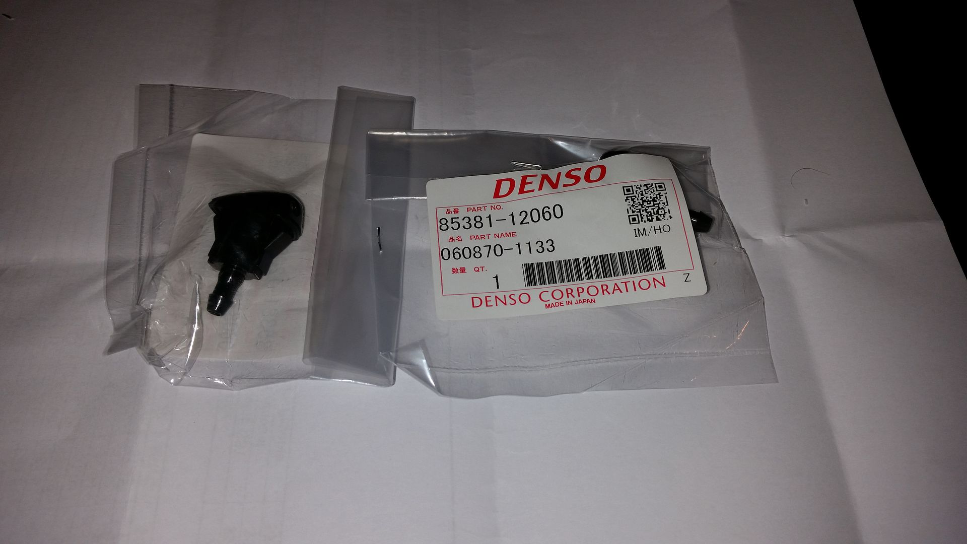

Some windscreen washer nozzles from a Camry / Landcruiser et. al. which I am told work well.

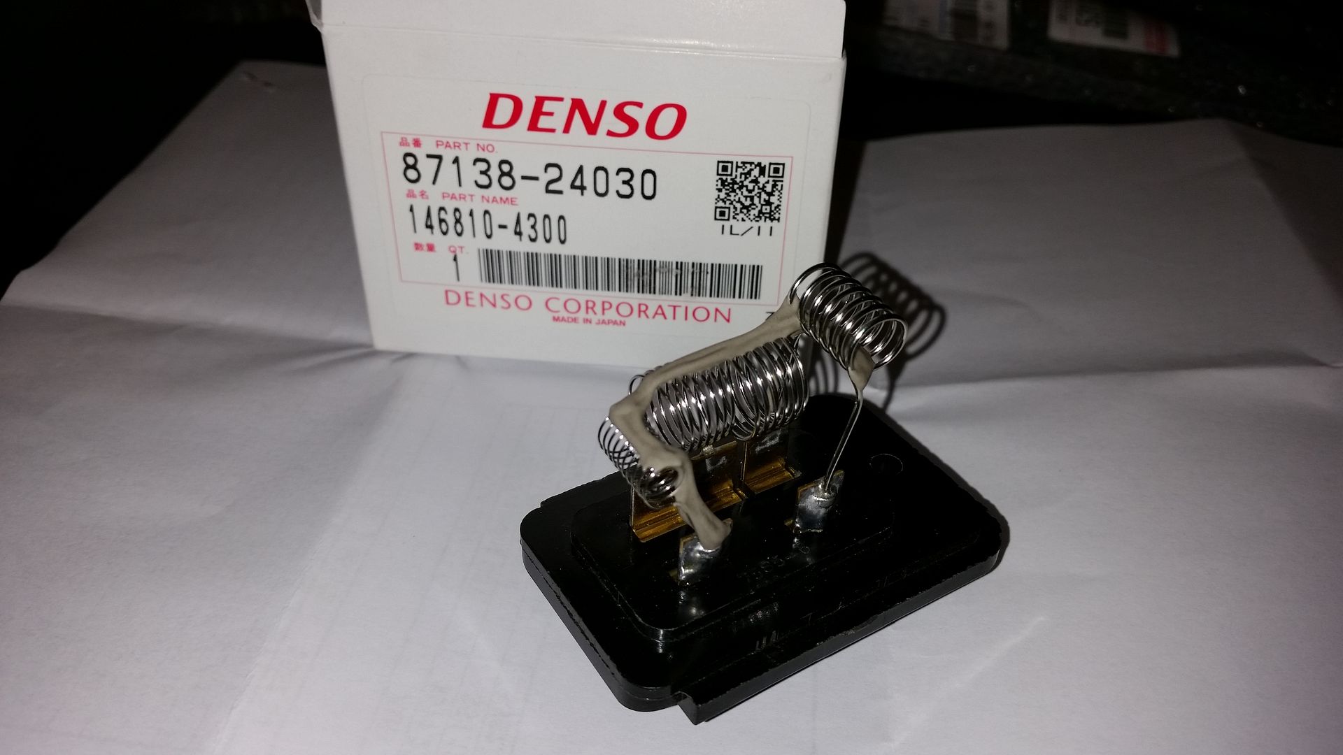

Heater resistor block. I repaired this on my previous car, but a new one wasn't too expensive.

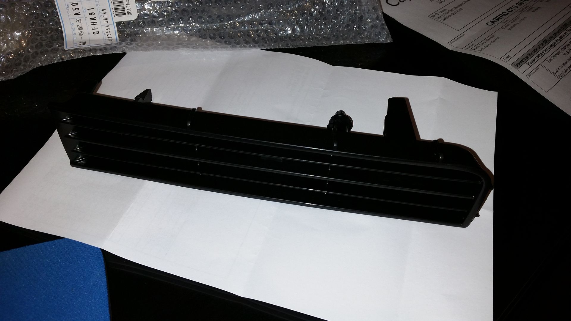

New front grills. So damn shiny!
This I didn't need, but the one on my car was messed up... so...

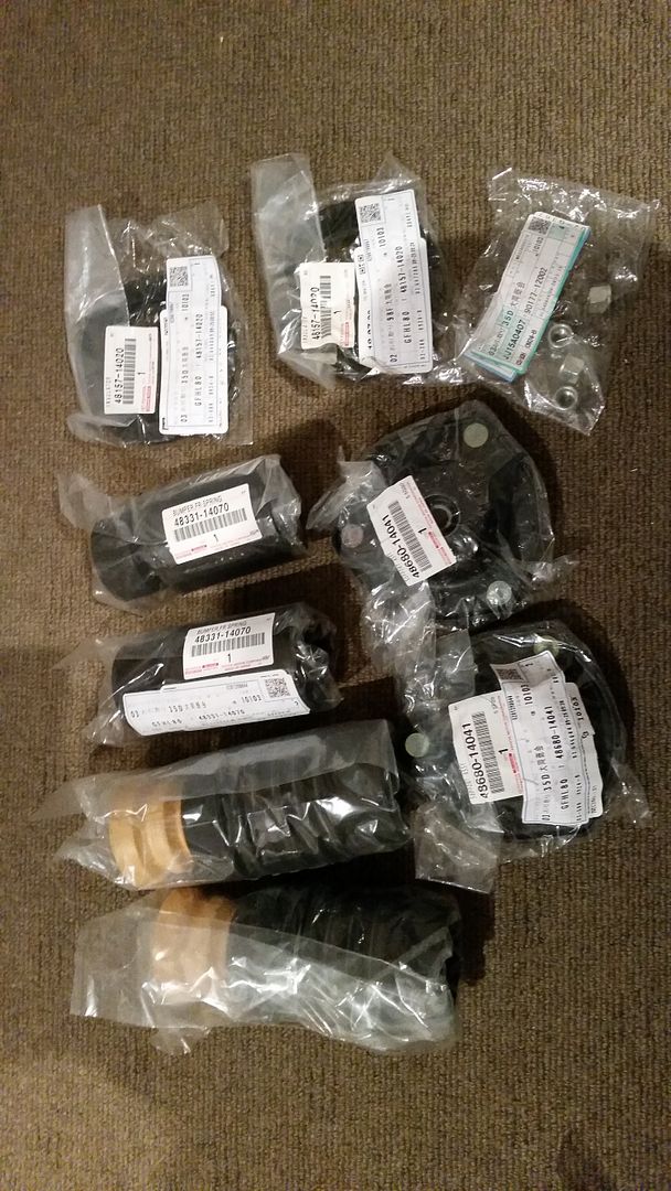

From the onset I've been clear that my goals for this car were not to compromise comfort or reliability of a street vehicle. Thought I would share a little of how I plan to get there.
Comfort sans squeaks and rattles - OEM suspension where available. I'll be running poly bushings but hopefully that does not take the NVH up too high.

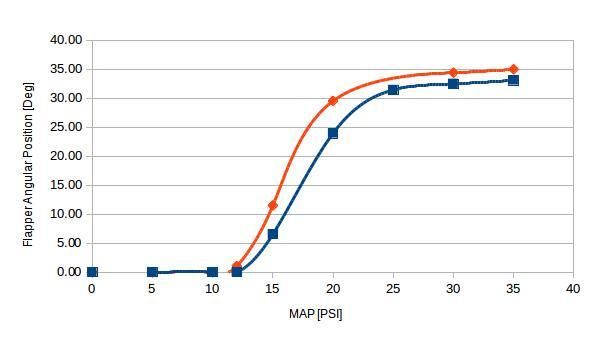

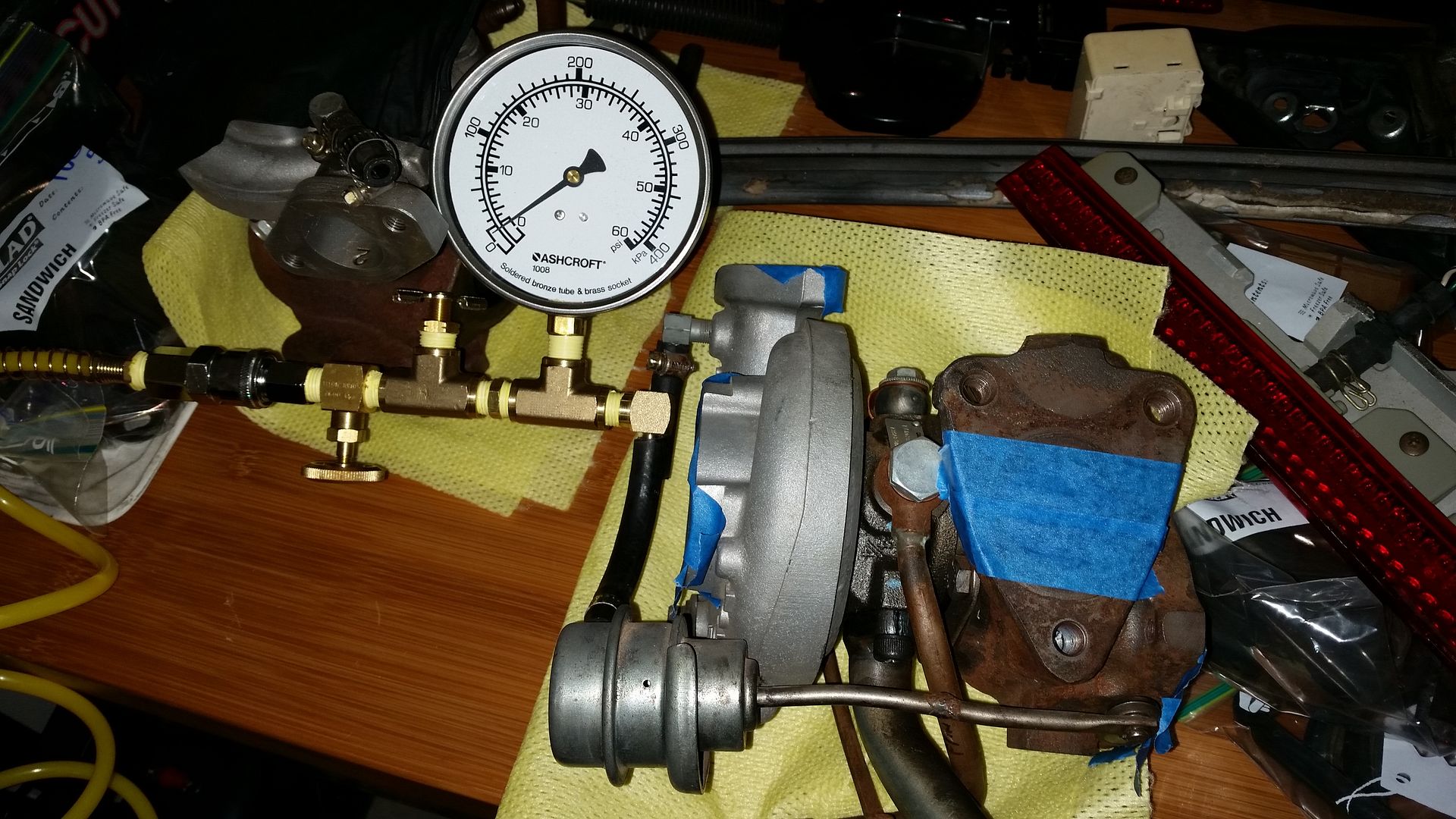

Have not really posted about the turbo setup yet, but few quick tests so far suggest that control issues are in my future if I do not replace the actuators.

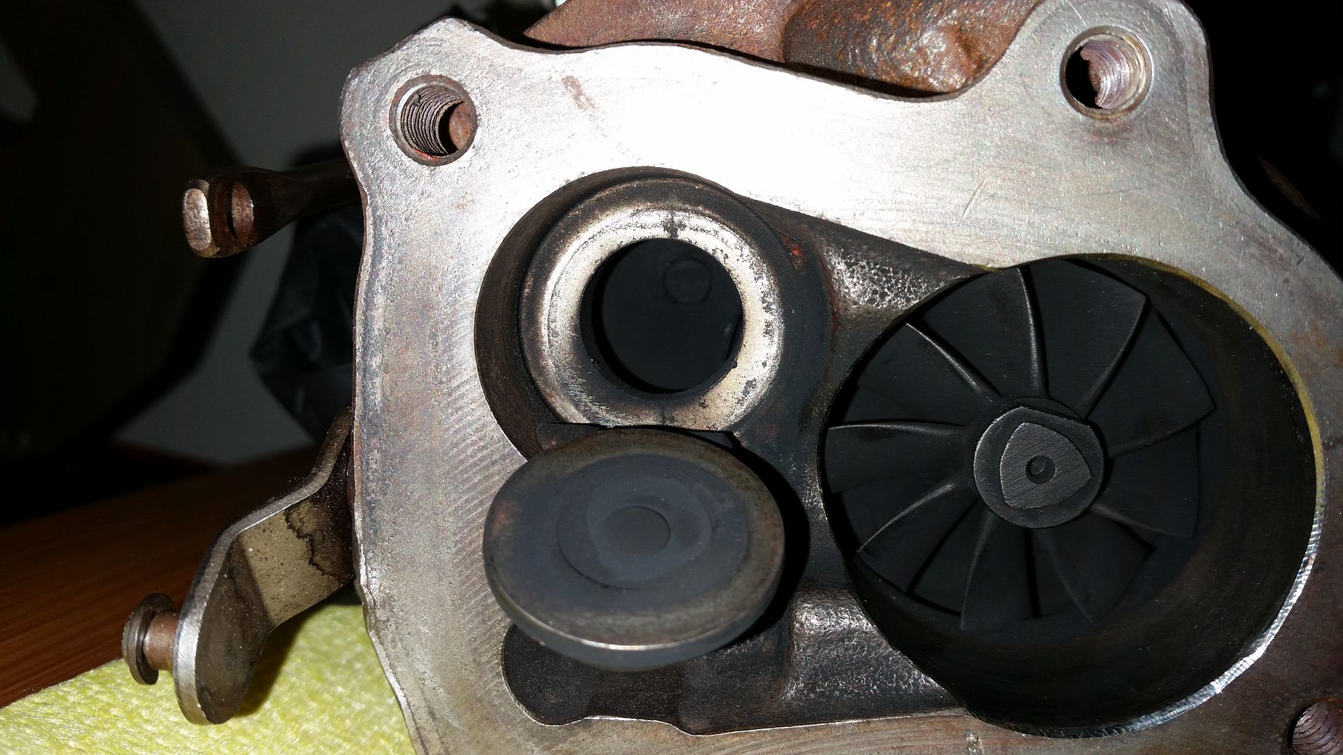

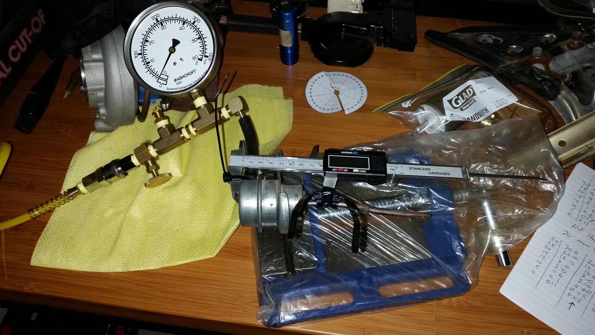

Turbo details are Garrett GT2860RS in the factory CT12A housings.
All credit to Hybrid and ATS for creation of the turbos. Rest assured they will be used to potential.
Others have run similar setups since these were built, with some development opportunities identified along the way. With this in mind, I will be putting my own stamp on things before bolting them on.
I invested some time to understand wastegate and actuator options. Developed some testing to benchmark the factory units.

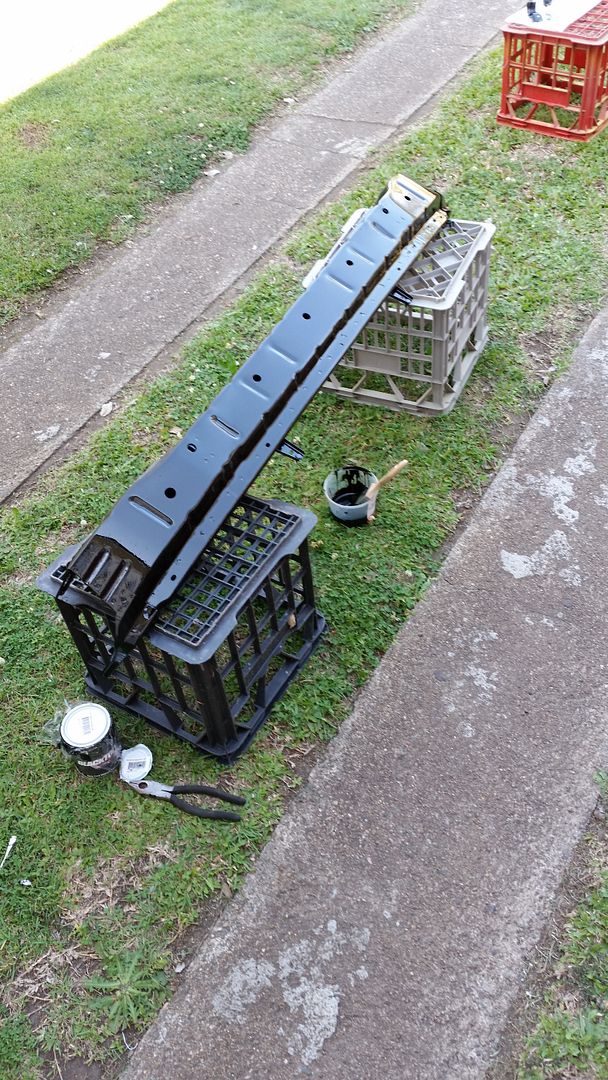

We had a public holiday on Monday, with some brilliant weather. Spent that outside keeping rust at bay.

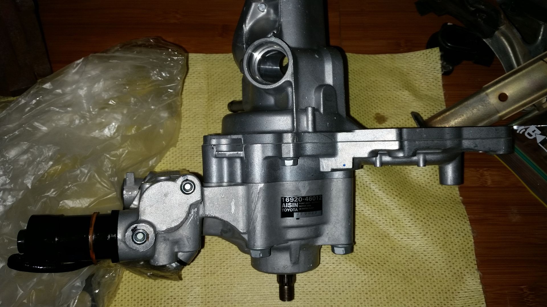

New hydraulic water pump also arrived. Most of the parts have arrived now, should start to see some real progress soon.

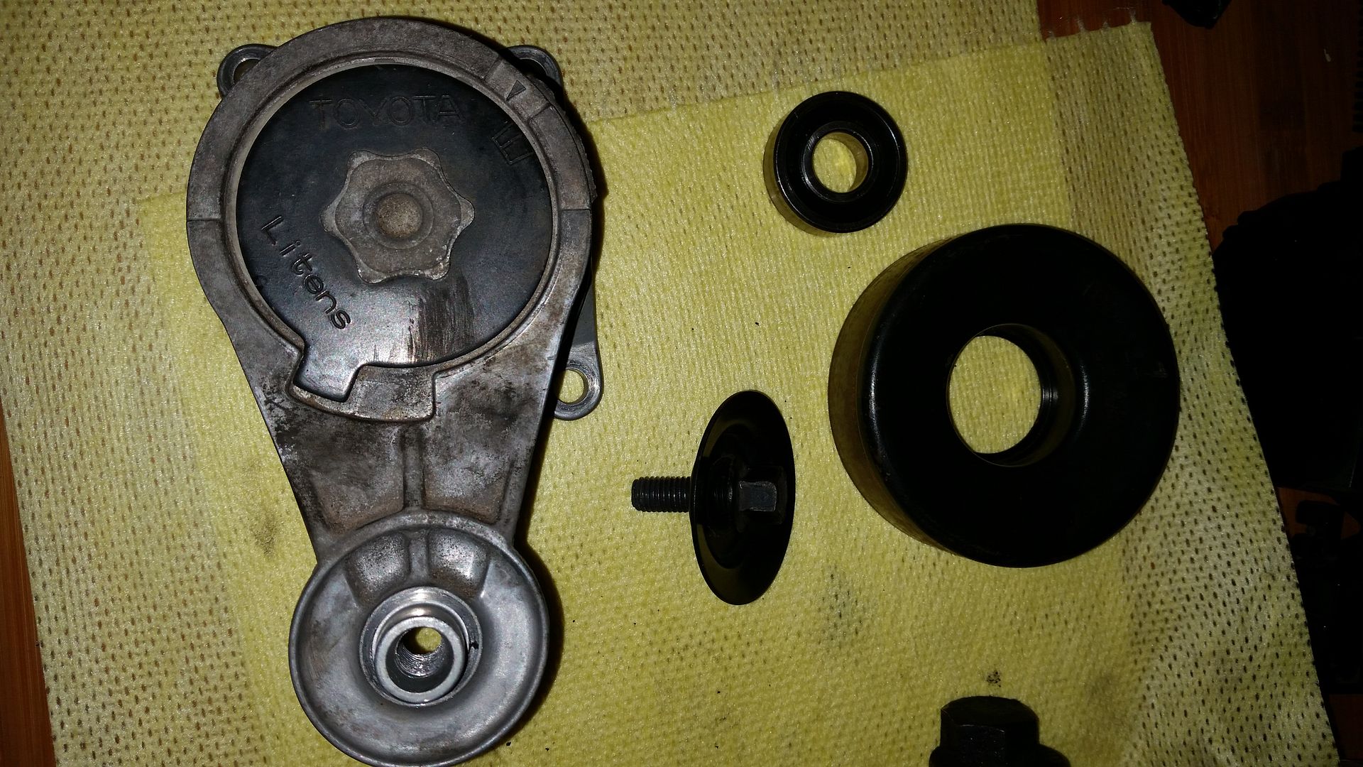

Still chipping away at progress here. I couldn't bring myself to spend $350 AUD on an accessory belt tensioner, so decided to investigate the spare Hybrid was kind enough to send me. Pulled the thing apart and found the only wearing part is a bearing. Like all standard bearings it had part number on it, and $6.38 AUD got me a FAG 6203 RSR which is the same as what was in there.

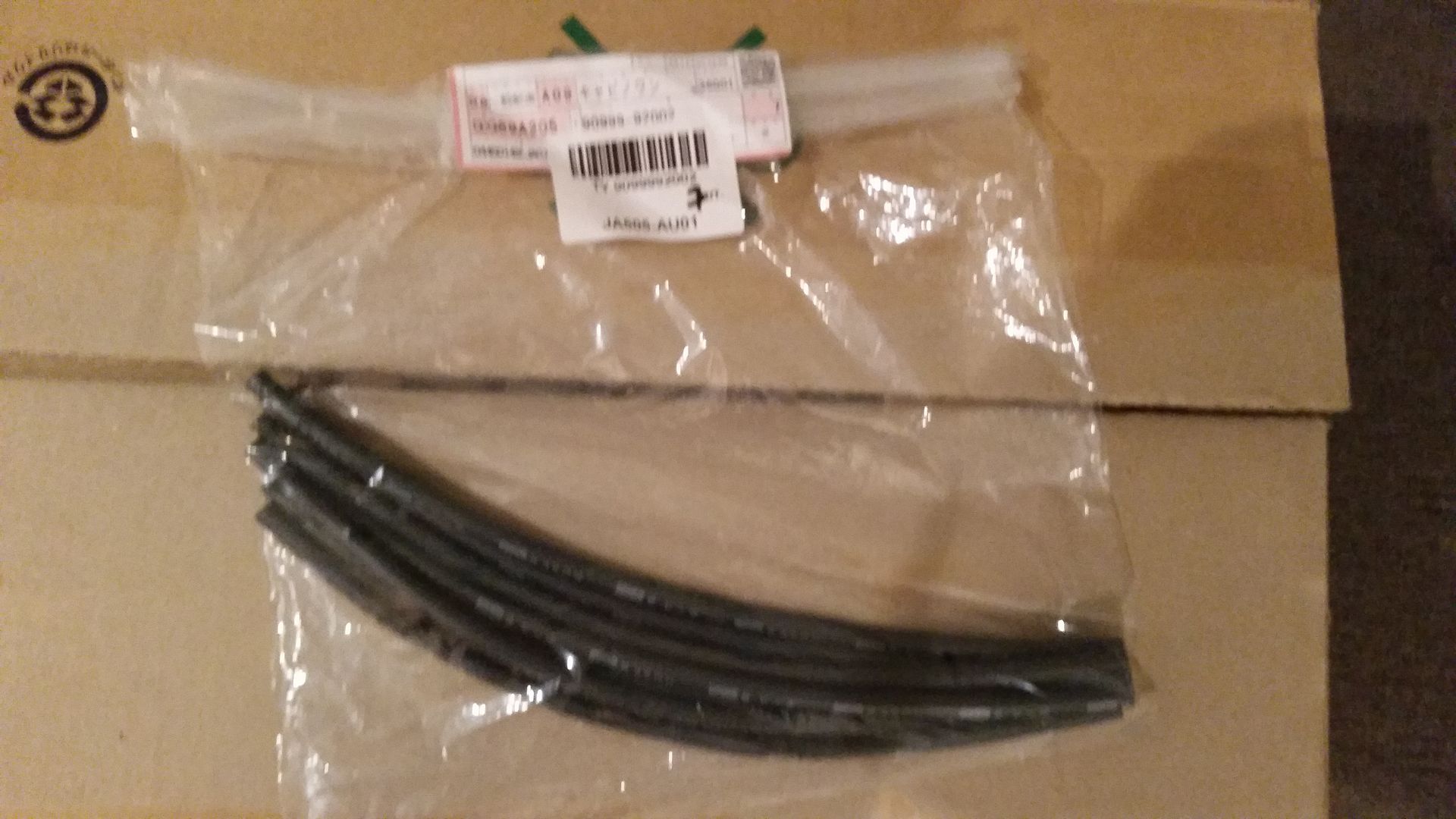

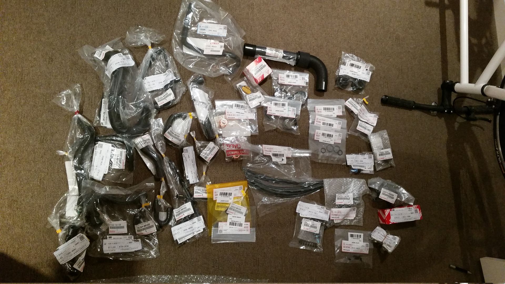

A huge box of hoses and assorted stuff arrived. Had a bit of a fail with vacuum line. Does anyone know the proper way to order this by the metre? I appear to have done it the expensive incorrect way...

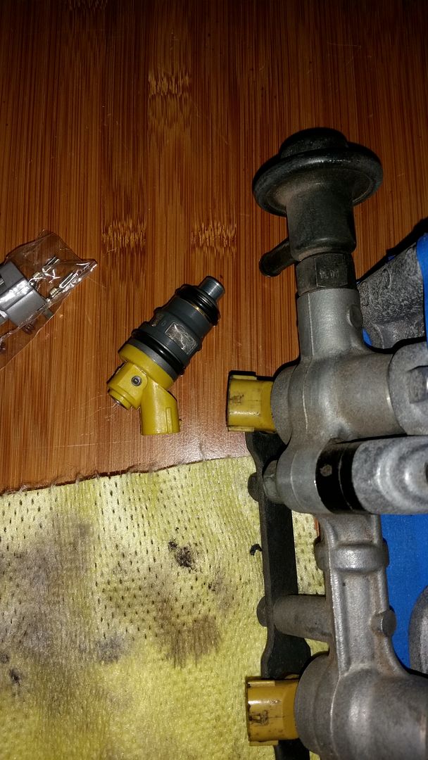

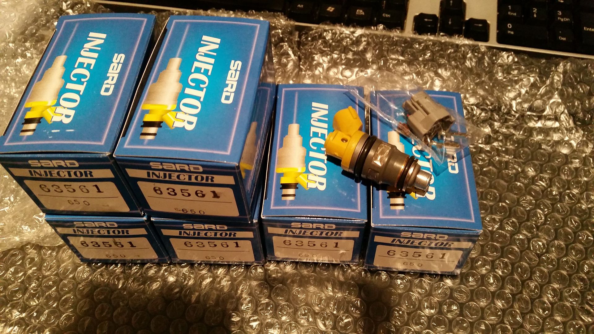

Drop in replacement injectors arrived. 650 cc.
I will have to be careful not to get them mixed up with the stock items :)

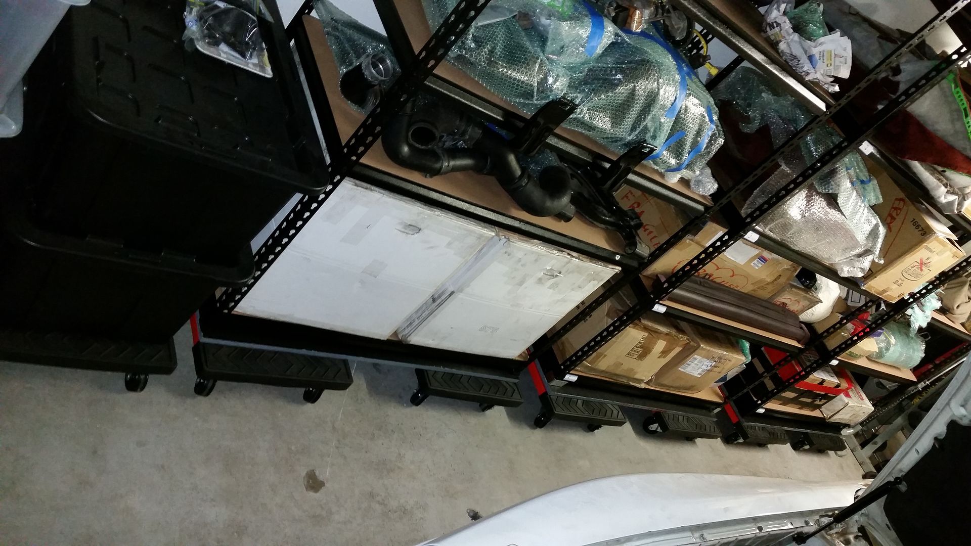

Getting the garage ready. I put everything on wheels a while ago, which is paying off now.

I couldn't find the correct size locally here for vacuum line years ago when I replaced mine. Of all the places I looked the Nissan dealer was the only place that had it and the guy said he hadn't sold any in years and gave me a bunch for free haha

HKS_TRD;2060810 said:
Where did you get the part number from for the vacuum line?
I anticipate a local Toyota dealer was zero help with this?
lol.. well I got it from internet Toyota. I gave up on Australia Toyota a long time ago. I feel like these is some subtle detail in the Japanese bit which I am missing :)
jugodegolf;2060812 said:
Enjoying this build. Great attention to detail.
Thanks at lot. I don't know you, but your red car is actually one of the builds I have saved as inspiration and motivation. I remember reading as you were fixing it up, the quality at the end really blew my mind. If you can get yours to that standard, I'm sure I can have a go at half decent.
Hybrid;2060853 said:
that is pretty funny what they did with the vac hose. I can only imagine the Japanese person on the other end going "oh well if that is what they want who am I to question" haha.
Well.. yeah.. it is funny in hindsight.
Cheers I will go that option if I can't crack the Toyota code.

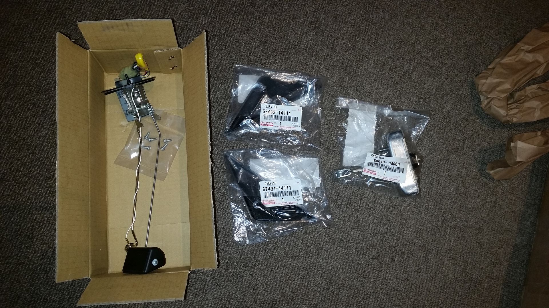

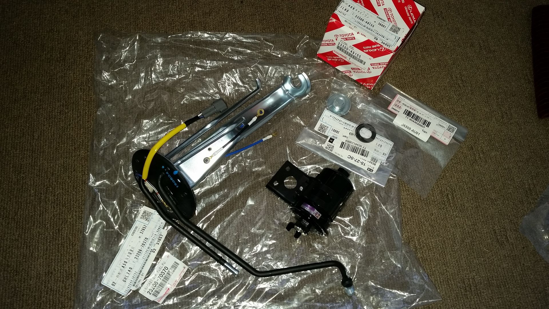

Good news is that after an excruciating wait, the last part for fuel tank arrived. Tank itself is used, but it has been cleaned, externally coated, and everything in it will be brand new.
