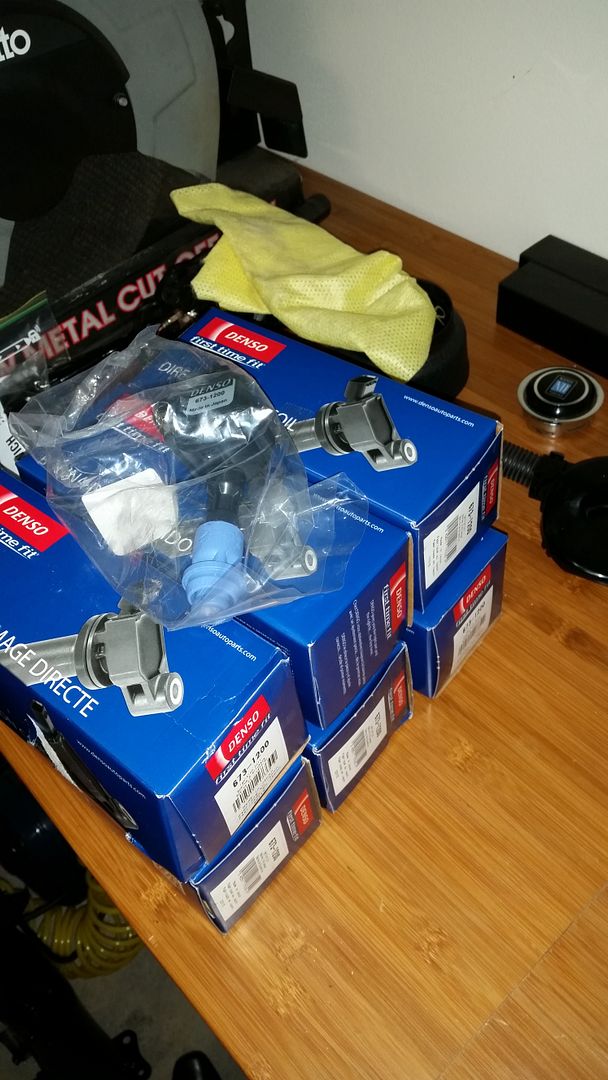

I had a hell of a time finding part numbers when I did my restore. I think it's safe to say that we should create a page with part numbers listed for everything anyone has bought in the past or present. I've tried using the EPC, but it's very time consuming finding most of the parts.
Another example of this is you have the denso numbers for the stock coils wihch I just found on amazon for 62$ if you bought from toyota it would be closer to 600$

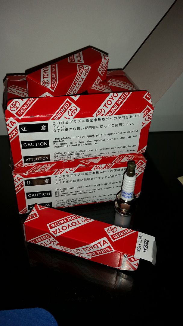

DeSloth;2059202 said:
Building pace on the car, so parts are starting to roll in. It is a real goal to keep the car reliable, so don't want any ignition gremlins.
I bought my supra very! cheap just for that reson. the engine didn't run, changed the sparkplugs to original denso, purred like a cat when i started it
I used to work in a lokal Toyota dealer (sweden) and a common issue with problem with any Toyota is wrong sparkplugs.

huge inspiration!!! I actually bought a jza70 limited edition that I'm working on. Was having some ignition breakup that normal plugs didn't fix so ordered those same denso coils. We'll see how it works out. But yes your car is amazing and ive referenced this thread a bit already.
