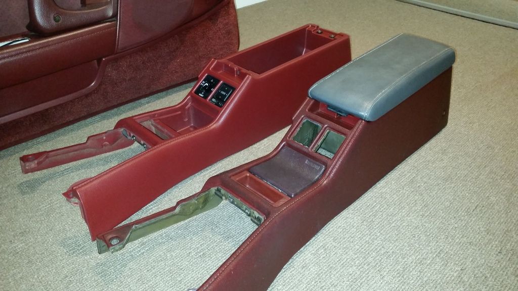

Open to all options at the moment. First preference is to find a dash in the right colour. If that doesn't happen I'll price an OEM vinyl recover vs leather skin.
I've also got a spare centre console in grey which I may get painted to see how well the colour and wear characteristics stack up to OEM. I'll test on that first to avoid pulling dash any more times than necessary.

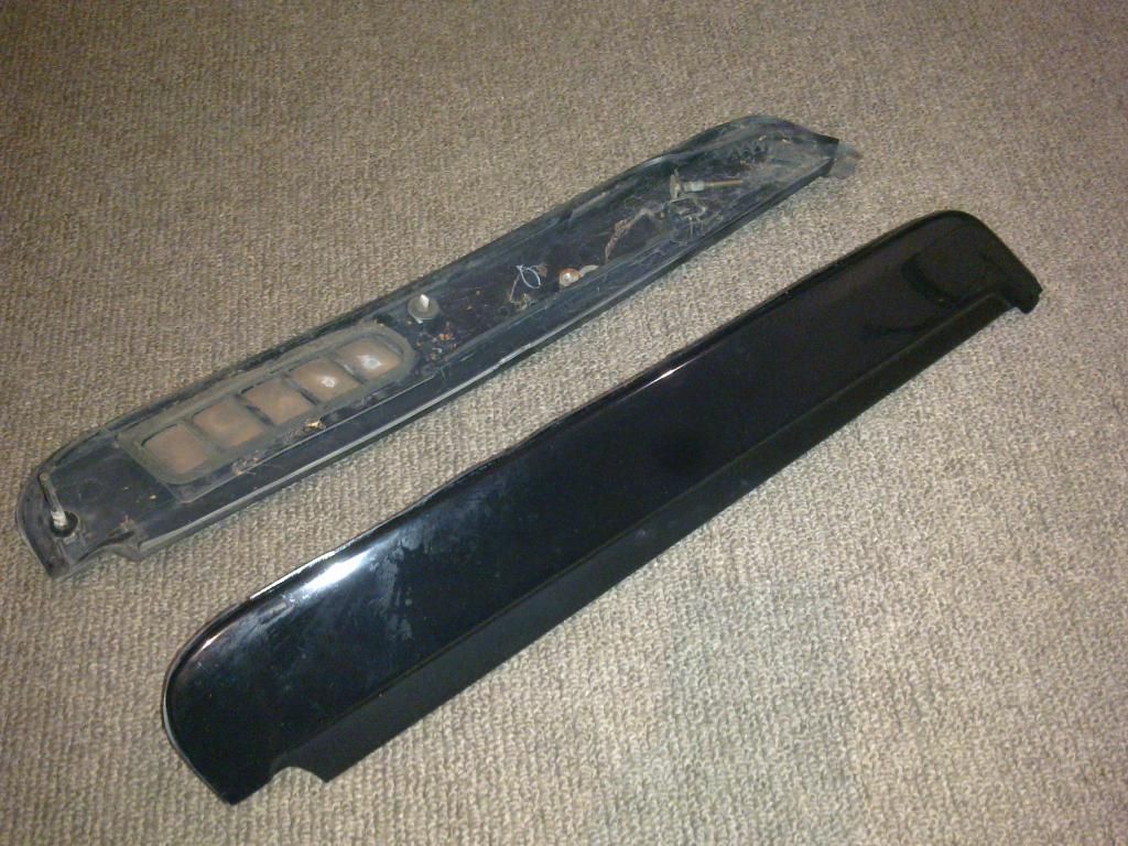

I haven't had much time to work on the car, but have been making some progress on 'very' difficult to find items.

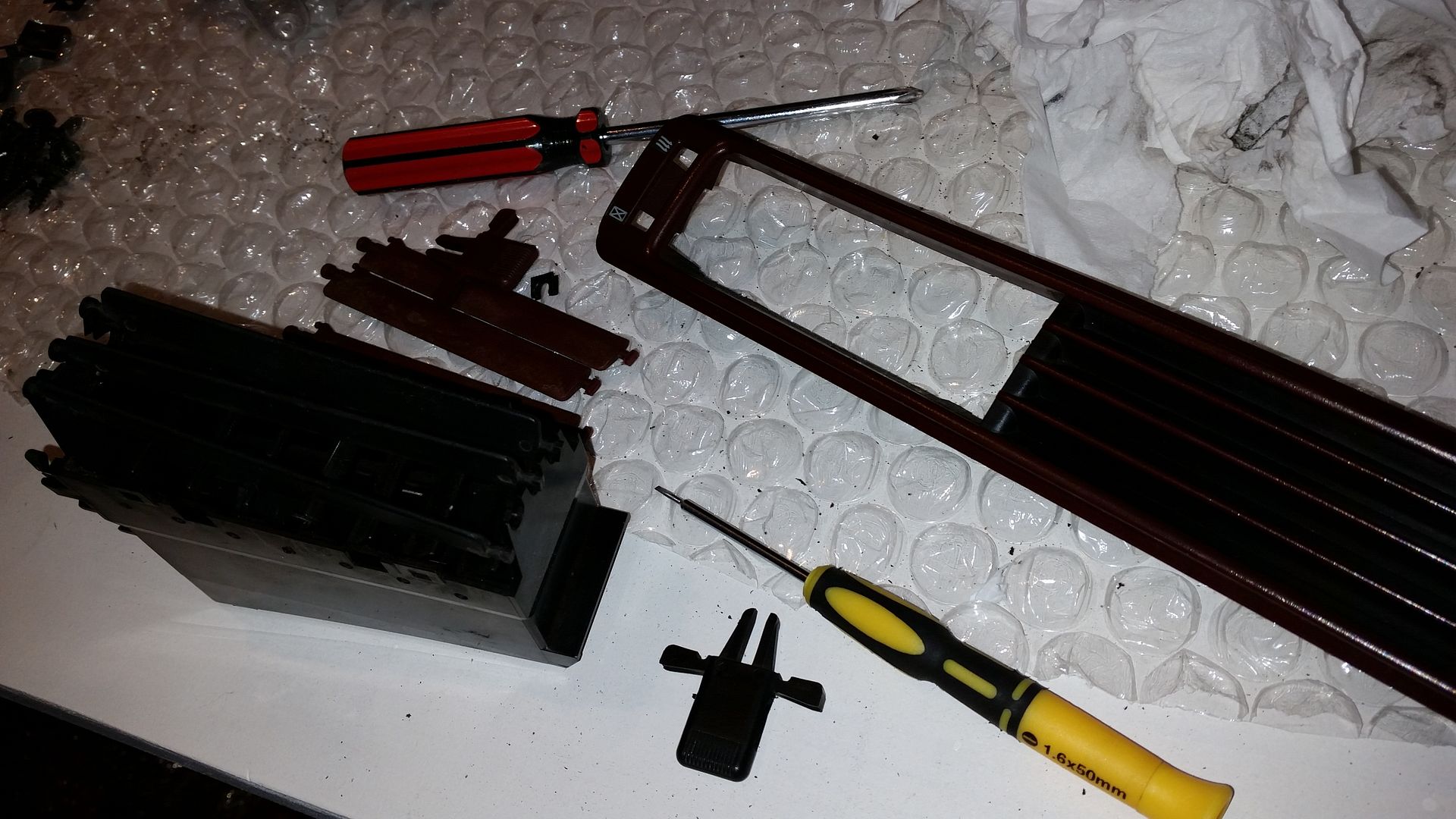

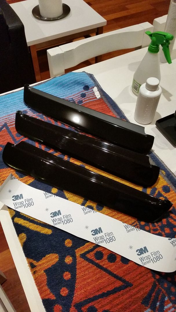

I lost an auction for silly money on new OEM ventilation louvres, and gave up finding a new set.
So I resigned myself to painting, or wrap in vinyl. I decided to try gloss black vinyl wrap first, and was very happy with the result. The item at the back is a brand new OEM unit for reference.

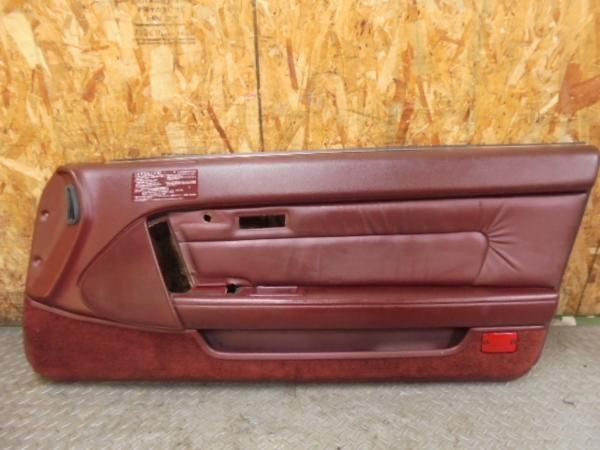

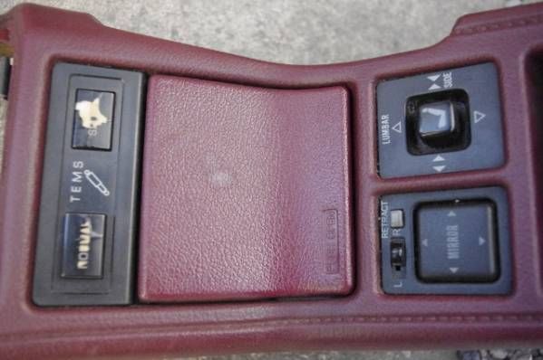

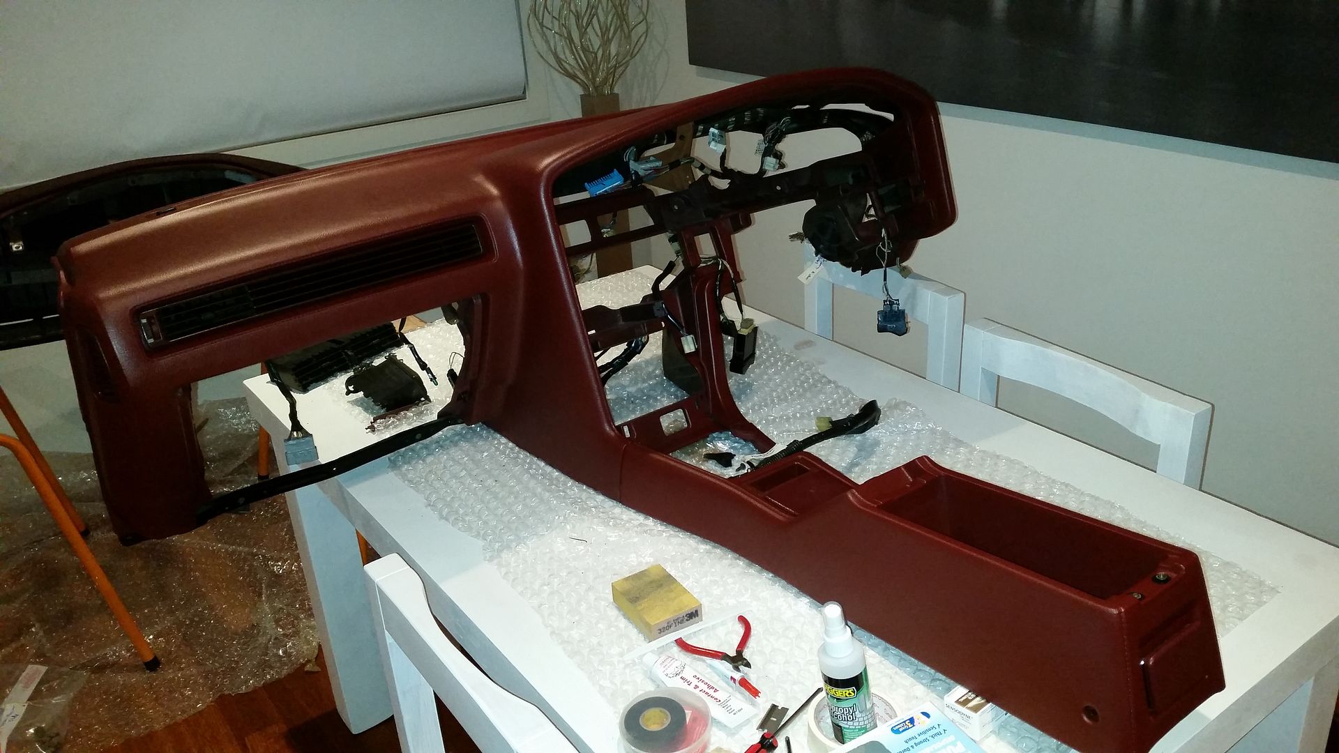

In spite of a lack of posts, there has been some progress. I got a dash along with some other parts redone in red. More to follow.
DeSloth
Jun 24, 2007
220
Australia
Thanks, was tough to find a clean dash. Impossible to find a clean red one.
FernandoDLT;2047850 said:
How did you have them redone? What process was used? Those look amazing! Good Job!
Fernando
The parts were professionally sprayed with plastic / vinyl dye.

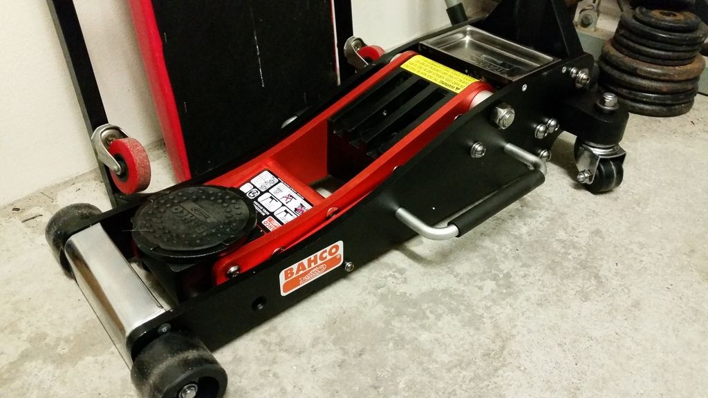

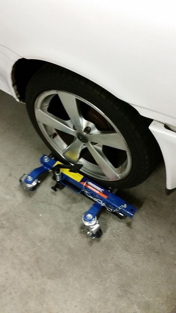

I have some new toys which are helping with access, so there has been some progress on the car.
Rolling tyre jacks
And a low profile aluminium jack

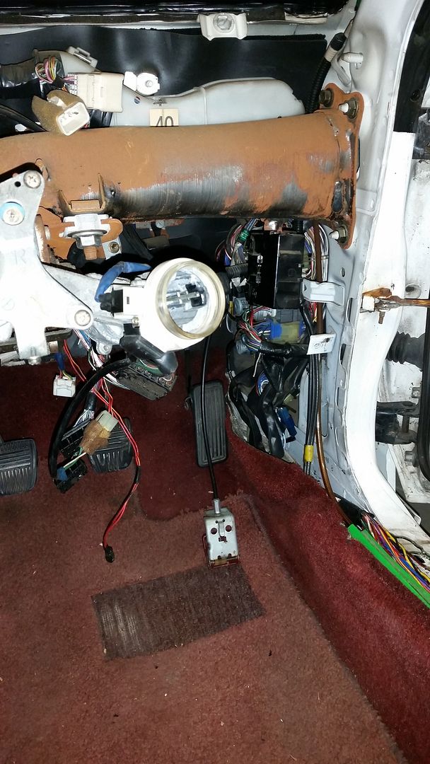

Trying to keep the plastics as original as possible, especially in wear areas.

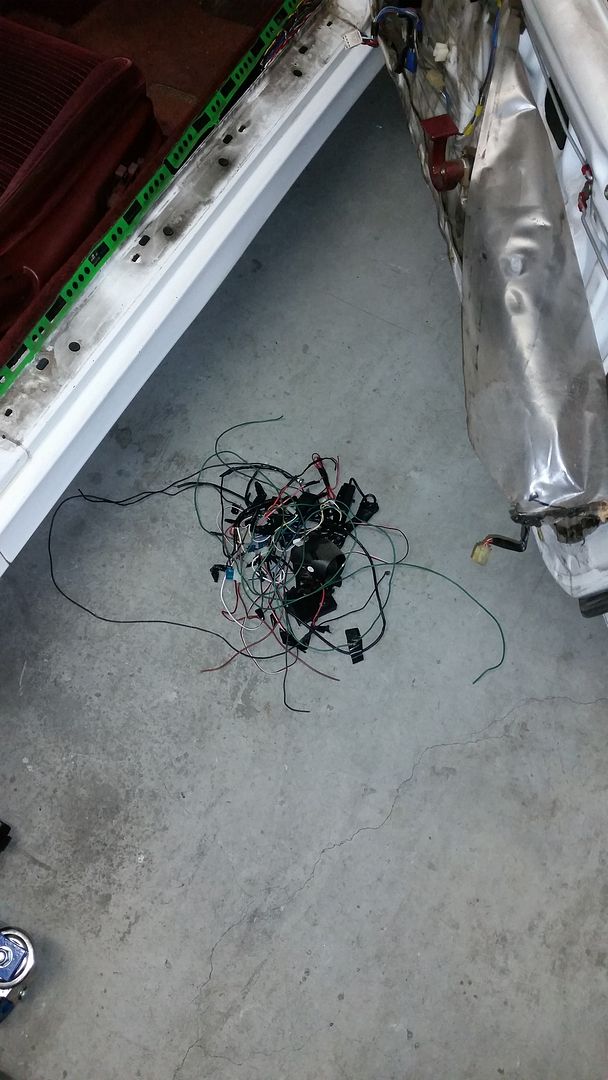

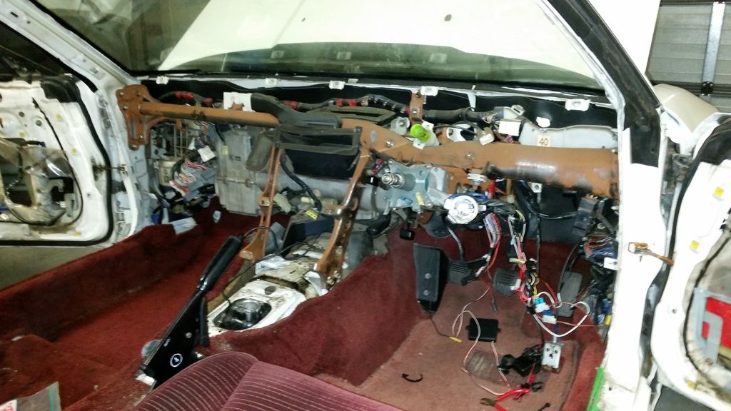

So I got the dash out, which uncovered the remains of at least 3 alarm system 'installs'. I'm surprised this vehicle hasn't caught fire it was that bad.
Some of what came out..
Better :)

I spent the weekend going right over the restored dash fixing damage, re-glueing areas of the vinyl skin, and swapping over the ventilation ducts and wiring harness. Very time consuming, but trying to get everything back as it once was.
Had to mess around with this for a while

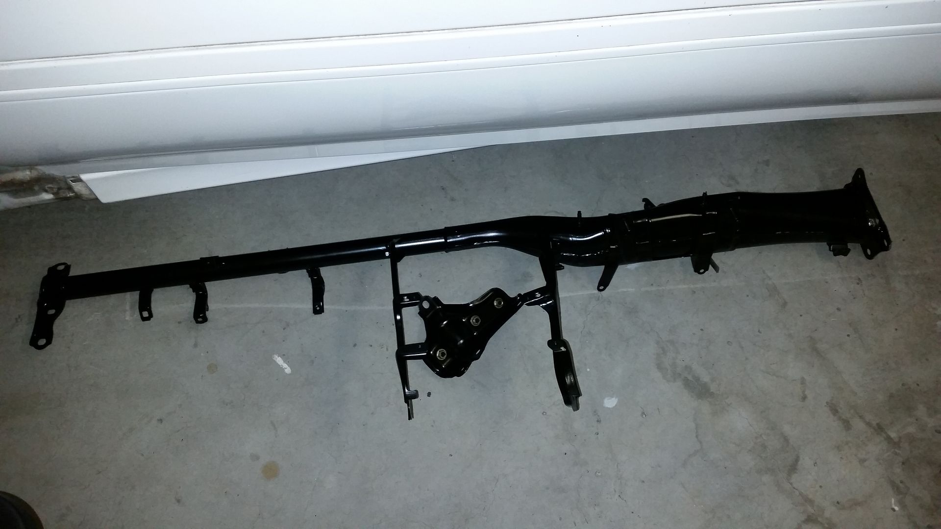

I also pulled out the dash support bar and painted it. Totally unnecessary but it looks so much better.

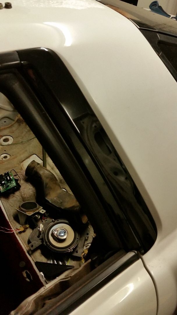

Hey Dan - yeah that was me with silver MA70. I'll try to find some pictures and email them to you.
For my JZA70, the JDM hatch glass has an antenna in it. Purportedly the antenna on the glass is enough for a radio signal on its own.. but we will see :)
P.S the side pod is FRP and the area I shaved cracked on me... twice. This time I will be handing it over to a pro.
