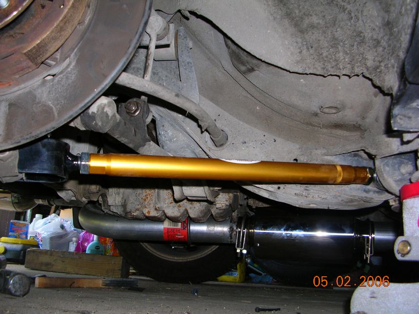

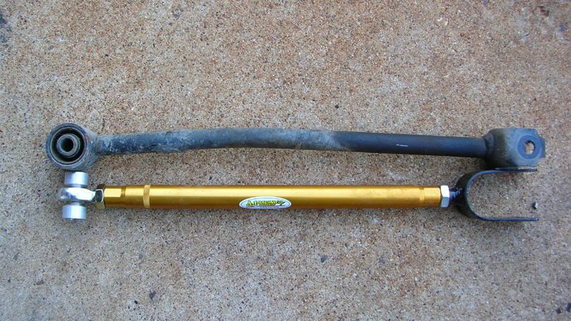

Alright more goodies, A1 arms. I noticed while putting on the teins that my stockers were arched.
I also picked up a hand full of hub studs today at Toyo. So I need to get these arms and the studs on this week so I can make it out to the meet this weekend that Matt put together.
I will get more pics this week once I get these on, I'll also get some of the teins and the new stance.

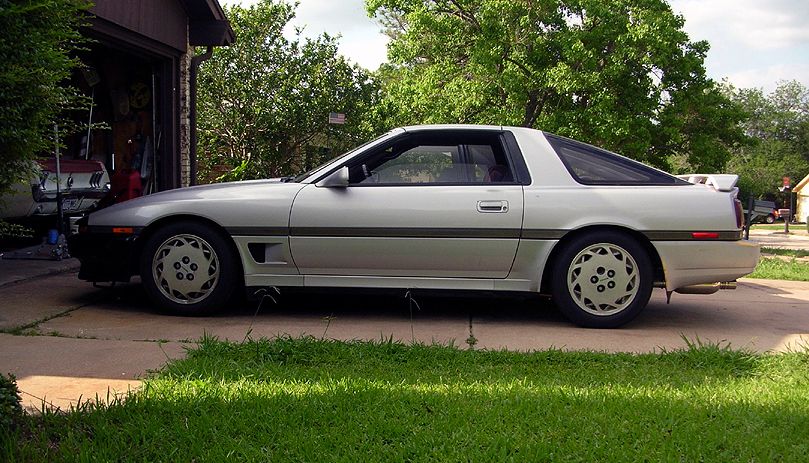

Alright, I got the broken wheel studs replaced and the A1 arms on. I also put in a 185* T-stat, I was running a 195* and didn't like seeing it hit 205* on a 75* day (my temp sensor is on the block side of the T-stat housing, so I see the fluctuation of the temp from the T-stat) "Normal" I suppose but I live in TX and 110* summer is just around the corner!
So I took her out today and the highest the temp would go was 195*, lowest was 185*. While cruising it would just sit at 190* (as opposed to 200* before) So that took some of the stress away while driving the Sup. It also dropped the under hood temp a lot!

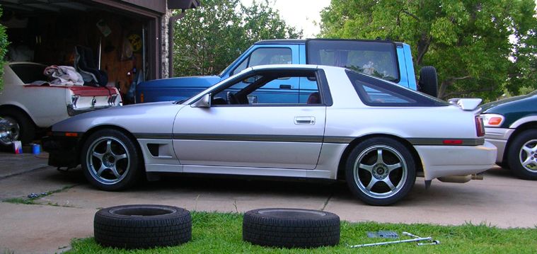

Well here are a couple pics I took,
The way the car sat before the Teins:
The way she sits now:

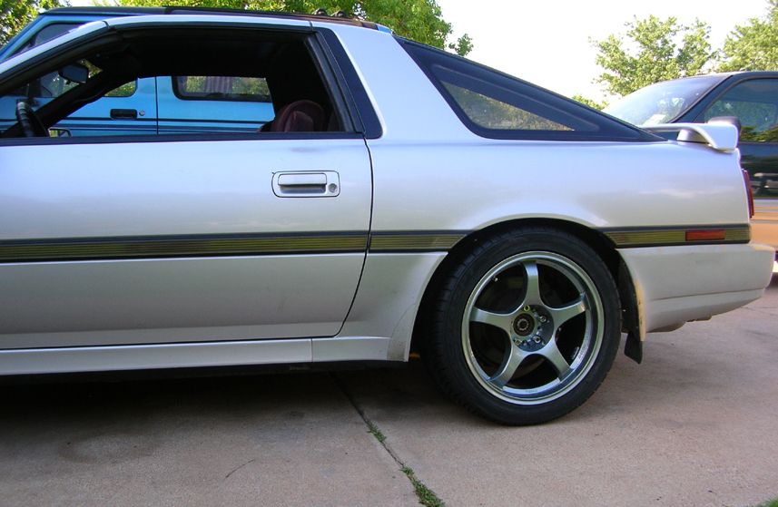

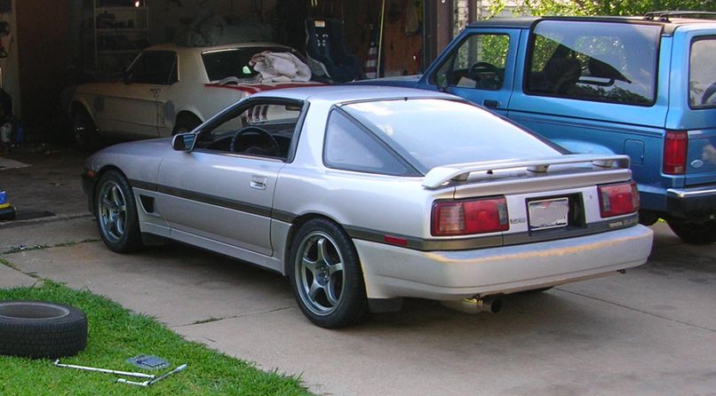

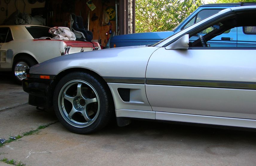

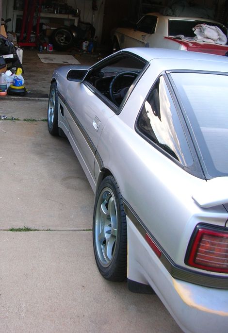

Thats right, new rims and tires for the sup!! 17x9 27mm offset, running 255 40 17 on all four corners. I first started looking at these rims about a year ago, seems a lot of cobra club racers run them without a problem, as seen here: *LINK*. I think they fit great! I do need to get some "hubcentrics" made up, to make them easier to mount.
No gay ass "teaser" pics from me, I give you full on action shots:naughty: :

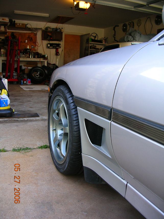

JIMI! WTF... Whats that? Oh wow! Thats sweet! I never saw a Supra with that side vent... I gotta go through your thread and find the info on that... I like it, alot!
