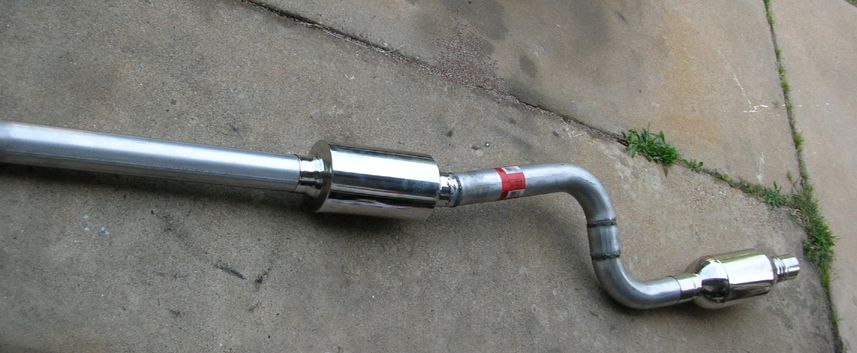

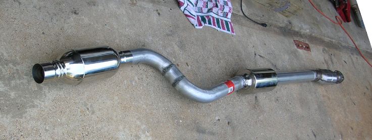

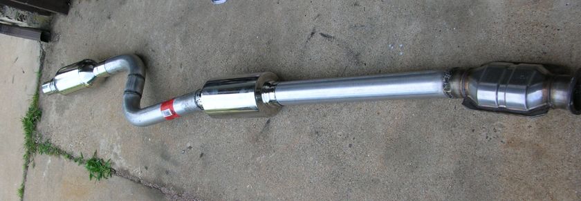

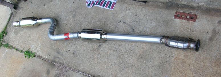

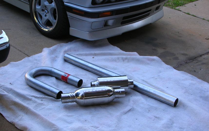

Ok, NEW update! Haha, I finally got my cat-back made. It's 3", mandrel bent, the cat is "high flow", the resonator and muff :)biglaugh:) is straight through. Fits great, once I get the hangers on and the car out of the garage, I will get pics of it on the car. The res and muff I have not seen anyone run, I found the company while "googling" and thought I would give them a try. The brand is Aero-Turbine,Link 1 Link 2. The piping is from Jegs (I also had some bends left over from making the DP), and the cat is from summit.

Excellent choice using the AeroTurbine muffler. They are excellent quality pieces. I was gonna buy one, but I'm keeping my exhaust semi-stock for license-retaining purposes. lol
No harm in running a cat, Jimi! As long as it's High Flow. Then, you're off the hook.
I'd be a bit nervous about that "resonator" having clearance issues... time will tell. Altogether, sick setup though, man. Looking very good.

Kurt: Thanks, Ya, I thought they seemed like good quality stuff, I've got the res tucked as much as possible, but yes that is a concern of mine also.

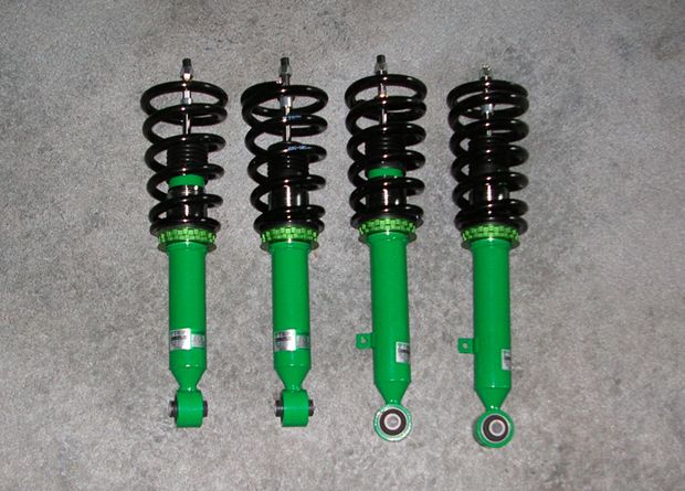

New goodies on the sup. These are new Tein SS, thanks to Simon (AKA: sarichmond) I don't have any pics of them installed. The bat went dead in the camera while I was trying to take the pics.
Also no pics yet of the car sitting, I was already missing one lug stud off of three of my hubs, the only hub that has all five is the driver front. But on the pass rear I snapped another one off while removing the rim, it just disintegrated like it was glass :nono: So I was not able to pull the car out of the garage for a test drive and for pics. So more pics will come next week once I'm able to swap out and replace my studs. Pisses me off, all that work and I have no clue how it rides........
I do know they will be softer than the set up I'm running on the bimmer, I can not make the bmw move when I put all my weight on the front of the car and press up and down. The sup still moves when I press on it, thats the only reference I have right now :biglaugh:
Here is the only pic I was able to pop off before the bat when out:
