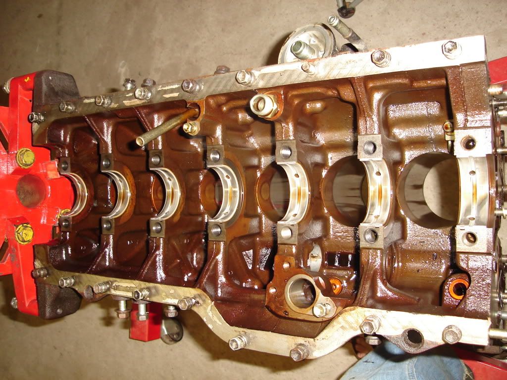

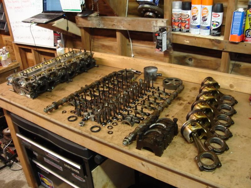

Ridiculous that this thread has not been updated...
My engine is finally ready to re-assemble as soon as my clevites come in (hopefully today). Cylinder walls at 100K miles looked flawless, with a crosshatch still visible.
One of these days, I will make a huge update with pictures of it all. So, for now look at these :)

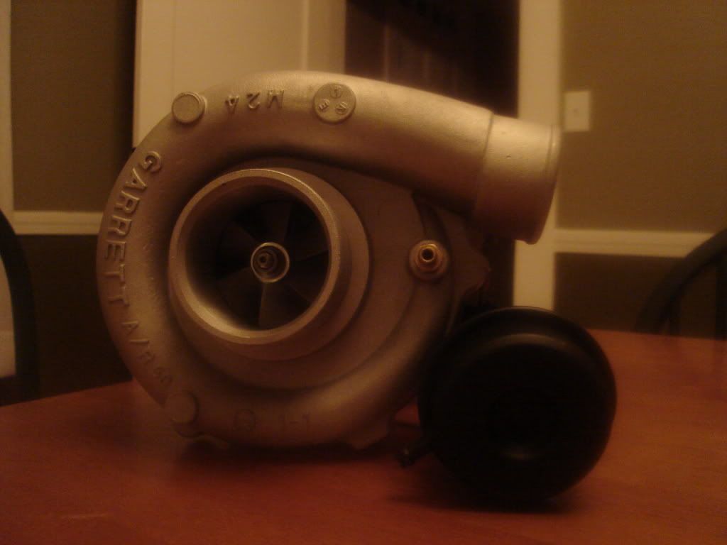

^ HKS Sport Turbo, 57 Trim !!! (thanks, Aaron!)
