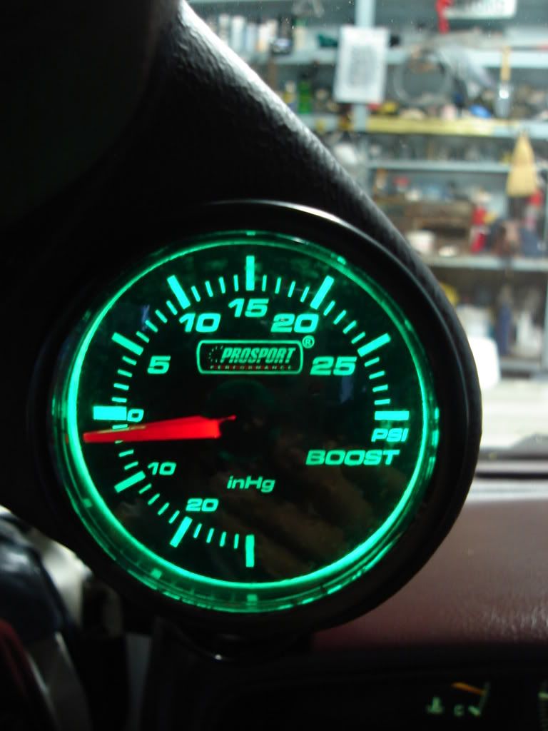

The silver bezel on the prosport gauge stood out, so I painted it black. Masking tape and satin black FTW.
I gotta call prosport - it reads 1 psi too low. The second prosport i've had that did this.
The gauge was too bright at night to be that close to my face, so I used static-cling window tint (2 layers) and it worked awesome. It's almost the same green as the factory dash lights now.

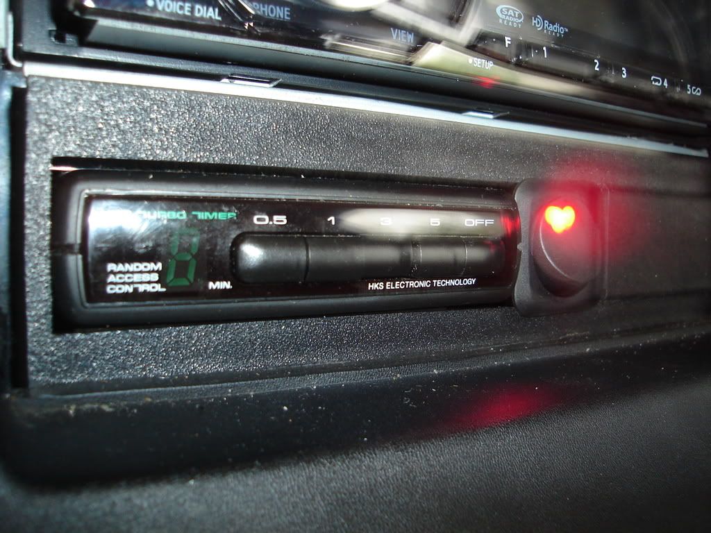

I then wired up the switch for my EGR solenoid. I'd P'shop a picture of the setup, but i'm not in the mood. I HIGHLY recommend this setup. It's VERY inexpensive and totally F&%^$ cool.
I put a vaccum tee after the turbo pressure nipple. One line to the solenoid, one line through the MBC and into another port of the solenoid. The solenoid then has one port out to the wastegate. Give it 12V and it switches ports. Works like a dream.
I used this switch so I see a red LED when i'm in hi-boost mode. It fits perfect next to the HKS TT.
Light off, boost low.
Light on, boost high.
