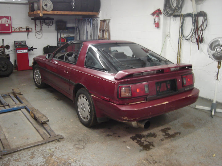

The car needed to be towed home due to a bad slave cylinder. I went through the basics of the car (slave cylinder, valve cover gaskets, fuel filter, plugs, wires, oil change, etc) before driving it to bring out its real flaws.
Big surprise, it had a BHG. I didn't know enough at the time but it had all the symptoms. No power at full boost, overheat after long boost periods, etc. It was just the beginning, next to leaking oil seals, leaking transmission, bad paint, etc. I added one pic of the car - it's more than enough to see why it went up for sale after two weeks. I even traded it for the mustang shown below - it was a beauty, but not the MK3 turbo I still wanted (yes, even trade. don't ask).

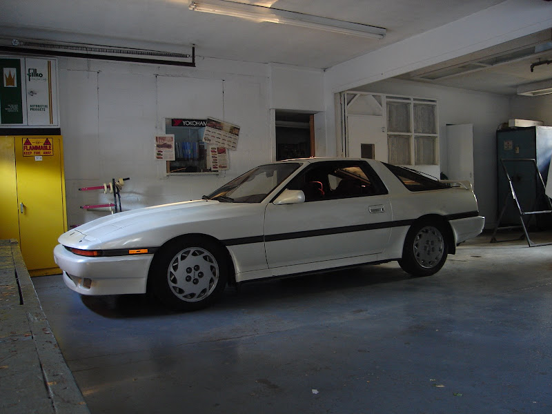

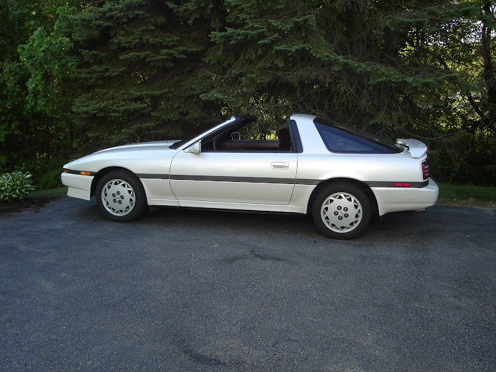

1987 Pearl White Turbo, Targa, 5-speed, 92k miles, bone stock. Naturally, it needed a small amount of work. The previous owners were in their 50's and had the car very well maintained but it had sat for a few years before being sold. It needed tires, a timing belt, and some other drive-and-discover-what-it-needs work. The front bumper needed paint, although it was excellent elsewhere. The steering wheel and shift knob had wear, otherwise the interior was flawless.

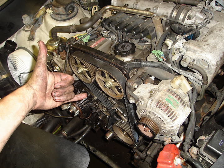

The first week I got the car, I replaced the timing belt, did a tune up, valve-cover gaskets, and fluids.
I painted the front bumper and in-doing-so, noticed a split grille and cracked fog lights.
I drove the car for one week before it went away for the winter. At this point, I knew very little about the car, but it ran EXCELLENT. Quiet, smooth, and I think it made every bit of power it made back in 1987. It was clearly never abused.

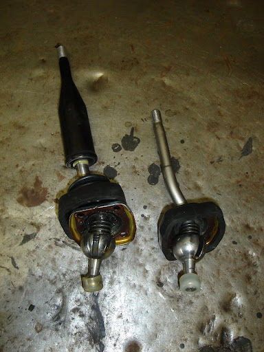

Over the winter, I acquired a few goodies that began to make their way on to the car. First, K&N intake. It made the wastegate and BPV tastefully audible. Next, SOGI short shift with new Marlin Crawler bushings. By far the best modification that can be made for <$100. It's short and very ratchet-like.

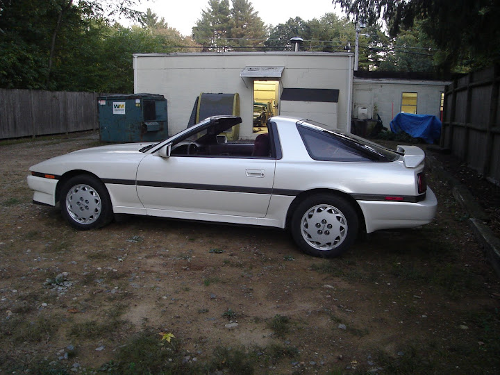

I had a set of 16" all-seasons on my subaru, and I threw them on the 'blades in place of the dry-rotted tires on the supra. I put my new-to-me grille on, along with new-to-me fog lights. Last, the 89+ tails.

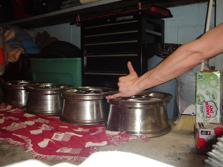

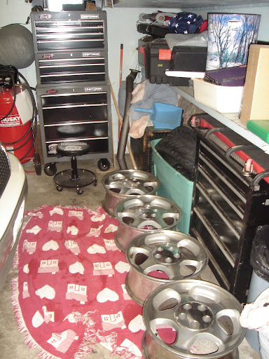

Sawblades FTL, so I found some wheels. I have a soft spot for MK4 wheels on the MK3 and planned to get a set in a couple weeks, but couldn't pass up a recent purchase. (4) OEM Mustang Cobra wheels, 17x9", $150. I found them on craigslist and couldn't pass it up. I plan to go 255/45-17 front, 275/40-17 rear.

Nice man, same color combo as mine and in great condition. The pearl's really shining through on that last day pic. My old supe used to have Cobra rims on it and they fit well. Those look to be the same ones my friend has on his '96 Cobra.

Yea, I think the Cobra wheels will work excellent. From what I have heard, 255's front, 275's rear, shouldn't rub the fenders. Anyone know if I can go wider than that on the 9" rims without rubbing issues? I believe they are +26mm offset - but say so with little confidence.

Great looking car! You should go all the way with the 89+ look, and do the bumper cover later on. Also, a great job on the KX too! Gotta' love the green! I do want to warn you about the Mustang wheels though. Remember that they are not hub centric for the Supra. You probably will not be able to find rings for them also, as most are made for oem bore, to after-market bore. With that being said, you should have rings machined for them, or just be very careful when you torque down your lugnuts. Keep in mind that your lugs will be supporting all the rim/tire weight, and must be aligned perfectly in the holes, and then torqued in a star pattern carefully. You should also re-torque every week or so, especially if the roads are bad where you live. I would just spend the extra money and have the rings machined, for peace of mind. I had a set of Mustang wheels that balanced out really well, but never felt balanced because of the non hub centricity.

I will highly consider this - I have access to a lathe at work and may turn down some ABS cylindrical stock we have to make rings. I have heard of people using PVC pipe. but I would have to get lucky for the ID and OD of the PVC to match.
I will measure the required ring size and see where I can get.
Thanks for the heads up.
EDIT: http://www.1010tires.com/hubrings.asp
http://www.buywheelstoday.com/products/Hub+Centric+Rings.bwt
Worth every penny to me to hit the torerances right without having to arrange lathe time at my work.
