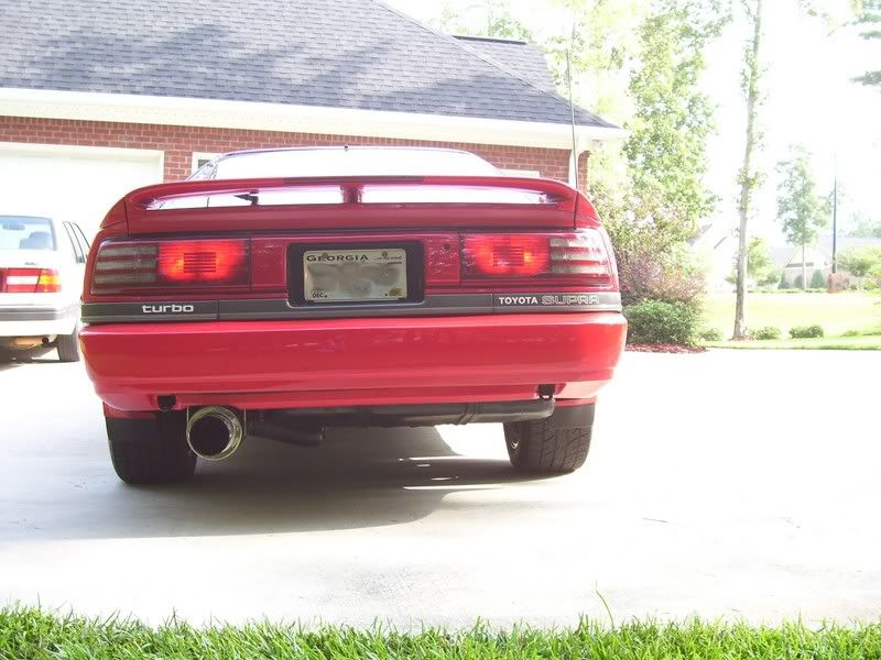

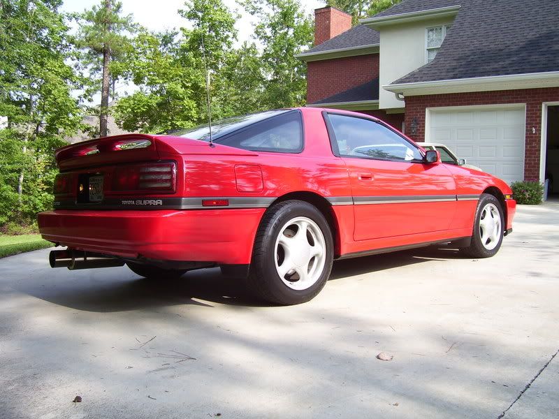

Here are some pics, I put a resonator on the one I have now to make a lil quite. If you want I can bring it down there Fri. because I'm off.

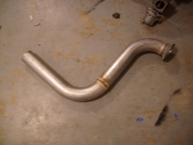

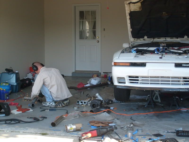

almost done, having some issues making the exhaust. hopefully it will be done tomorrow. stay tuned for a little street video
i'm learning how to weld, so my exhaust is going to look really crappy, but you really won't see it. my buddy is teaching me who is also an amature, lol

things kinda slowed us down today. we finally finished up the front half of the exhaust, getting dark now and don't want to make too much noise.

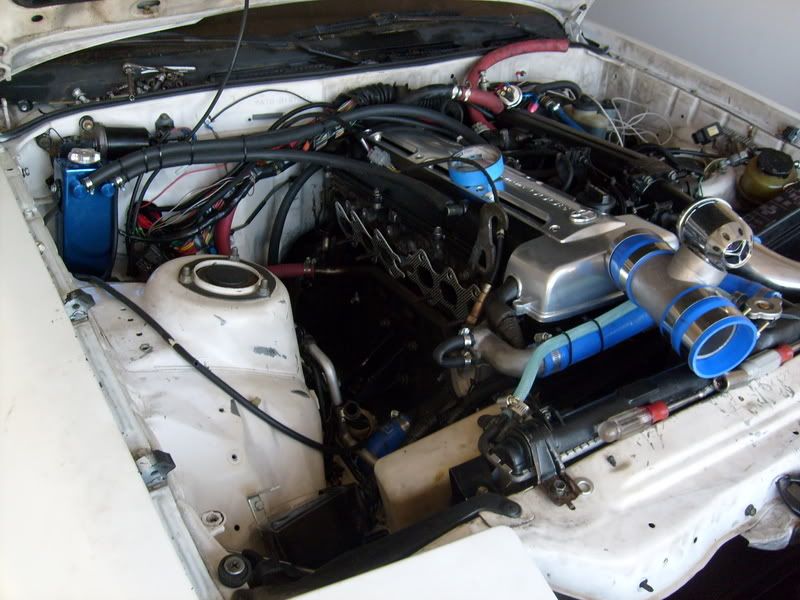

having some issues with idleing. i got the same problem i had before and others have had. it won't rev past 2000 rpms.
a couple things could be causing it.
1: I am using an NGK Wideband O2 sensor which has an Analog output, which I have connected to the O2 input on the ECU.
2: The Greddy BCC needs to go before or after the AFC. Since both use the same input, it could be clamping the signal for the other device.
It is running very rich, it burns the eyes the amount of fuel that's going in. the AFR is around 9.0
I don't want to start messing with the AFC settings yet till i can rev it past 2000 rpm.
I know there are threads about the rev problem but the freakin 4 word search is killing me.
this video doesn not show what i'm talking about. this is before i realized i forgot a filter for the IAC, i went and got one now it idles better, but the limit is still there

I'm not too sure what you did for wiring, but have you tried checking your map sensor? I had a boost check on mine and that didnt let me rev past 2-3k...
