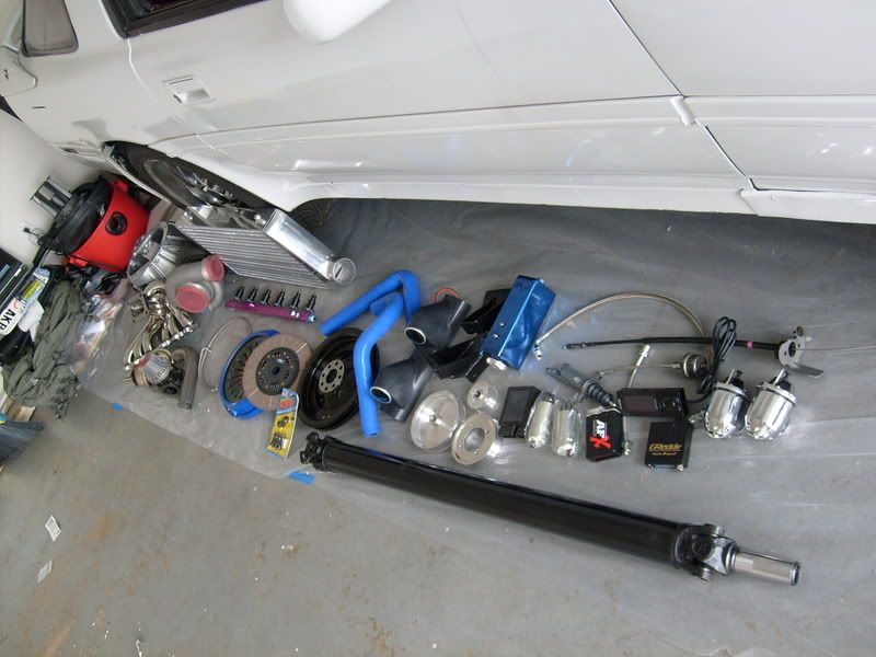

goooood.... i ordered a lot of parts. if you guys could give me some ideas of what to get. i'm having trouble figuring out what i still need. small stuff i don't realize i need till i'm actually working.
this is what i just got
GT45 Turbo
hks 50mm wastegate
greddy injector clips
injector spacers
shift boot
2jz t4 manifold
1jz bellhousing
2jz power steering hose
2jz oil adapter
2jz ignitor
r154 clutch hose
r154 slave cylinder
2jz pulley kit
oil catch can
walbro fuel pump
ngk wideband
spec stage 3+ clutch
greddy bcc
apexi afc neo
1 piece driveshaft
racing radiator
wire to extend harness
and i still need soooo much more stuff.... i hate it all so much!

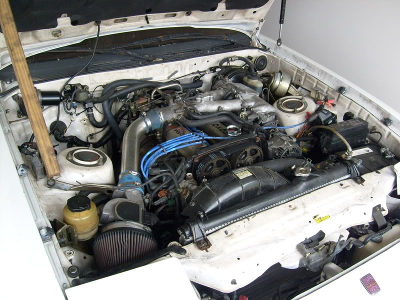

got my short shifter installed. it doesn't shorten the throw, just the height. it kind sucks, it's really notchy and i'll probably miss a gear every now and then
stock
new
and my cold air intake for my truck
it sounds so good

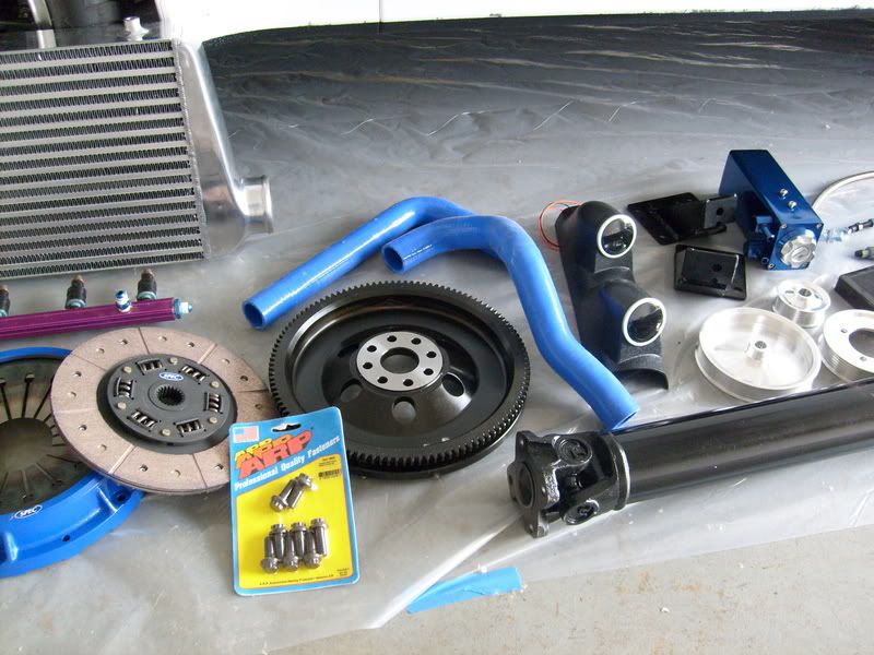

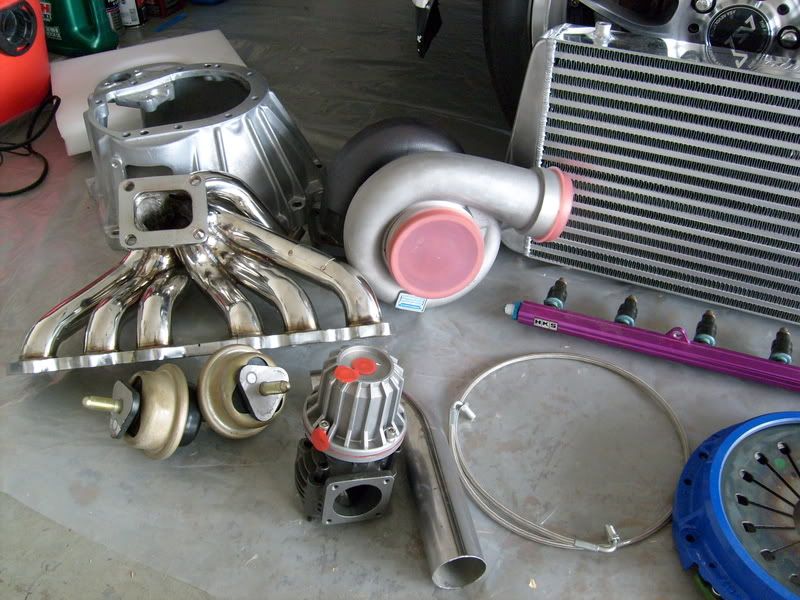

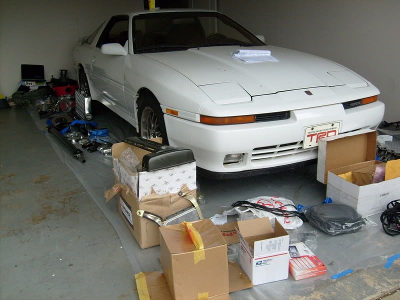

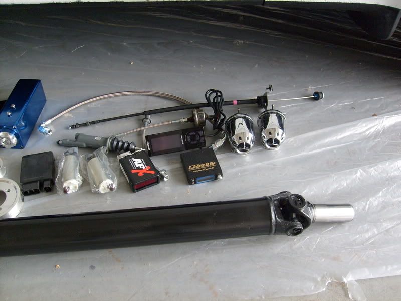

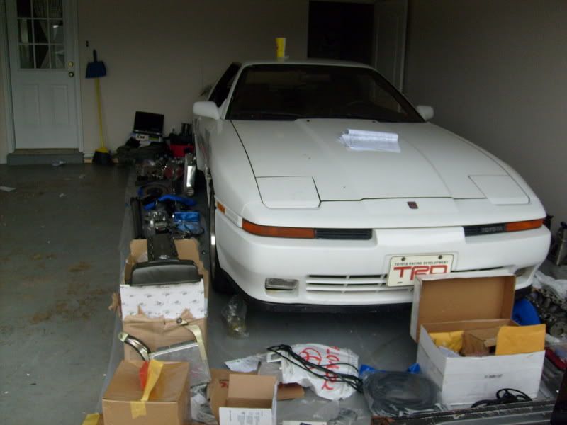

well, i got some things today. a lot is still missing and there seems to be a problem with my aluminum radiator and turbo, they might take a while to get to me.
3" intercooler pipes
12x24x3 intercooler
Prosport boost gauge
Prosport fuel pressure gauge
Greddy Profec B spec2
Spec stage 3+ clutch
1jz Flywheel
T4 manifold
Apexi AFC NEO
Greddy BCC
1JZ ARP flywheel bolts
Greddy fuel injector clips
BIC motor mount brackets

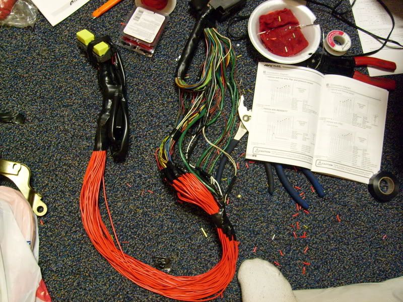

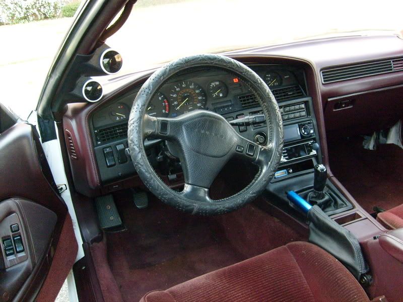

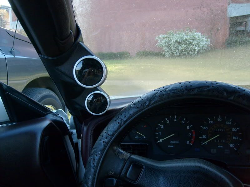

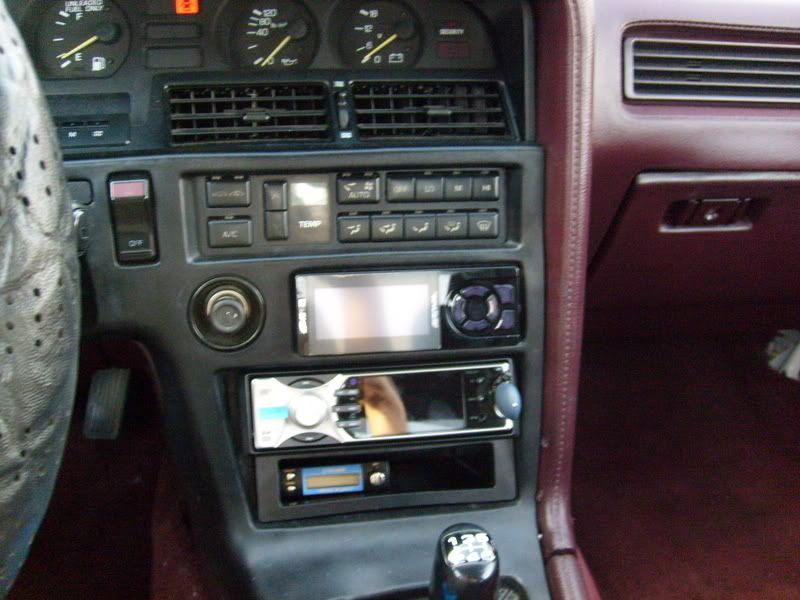

a little preview of what my interior will look like. i still have not decided on what colors to paint everything, that will come in a few weeks.
stock/original
Prosport fuel and boost gauges + Apexi AFC NEO + Greddy Profec
and extended harness. took my about 3 hours. i hooked up the AFC and Greddy BCC.

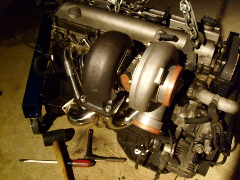

aww man i wouldve given you my ebay manifold for free, see if you can return it lol pay for shipping for mine and its yours
crazysupra2JZ
Nov 16, 2006
740
Georgia

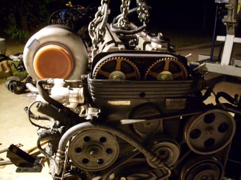

well, that sucks. oh well. i have a problem with it too. i either have to change the flange on the wastegate tube or get a different wastegate.

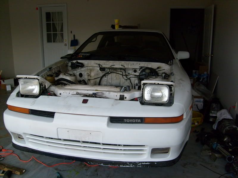

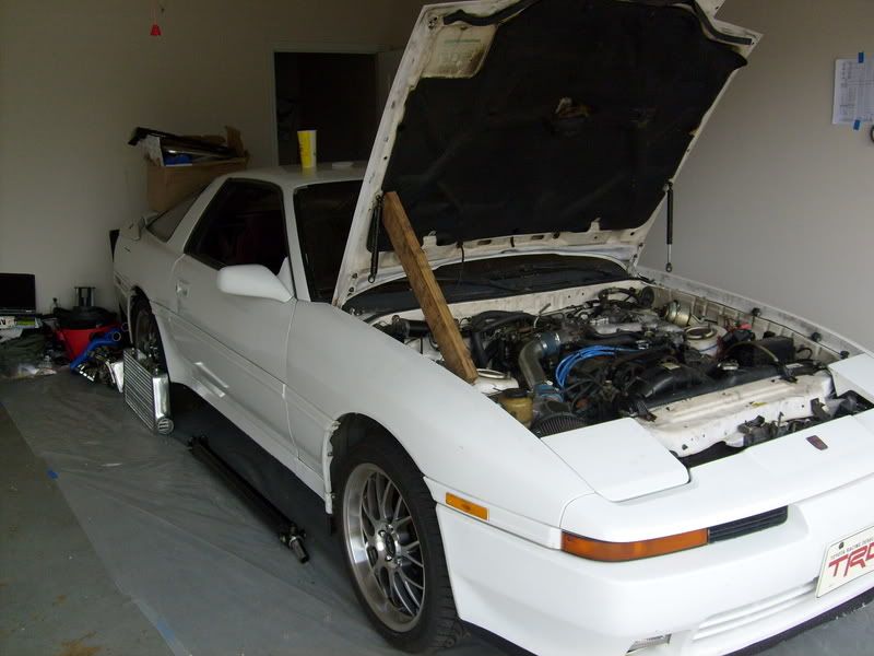

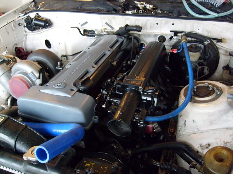

comin along here. kinda debating on what color i want to paint my engine bay. i think i want to paint the car silver.
ok, i have a question.
how do i keep AC using the stock lines? i switched heads on the compressor but the lines are not gonna fit under the power steering pump.

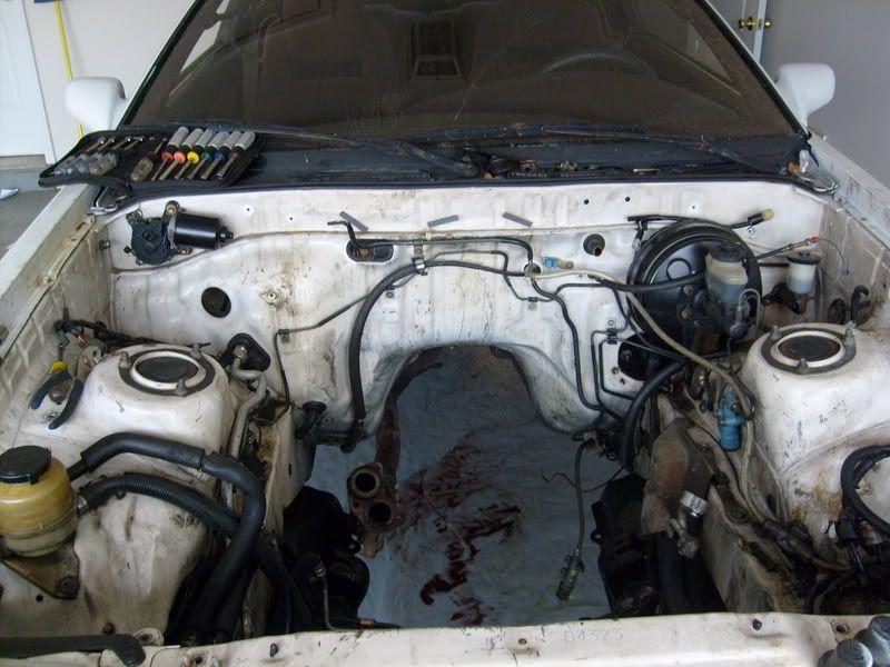

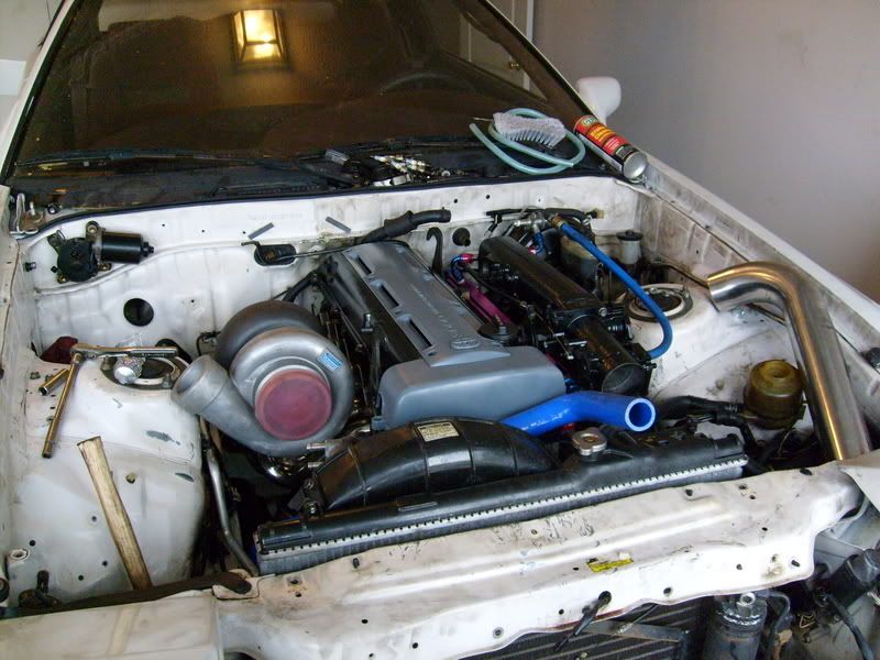

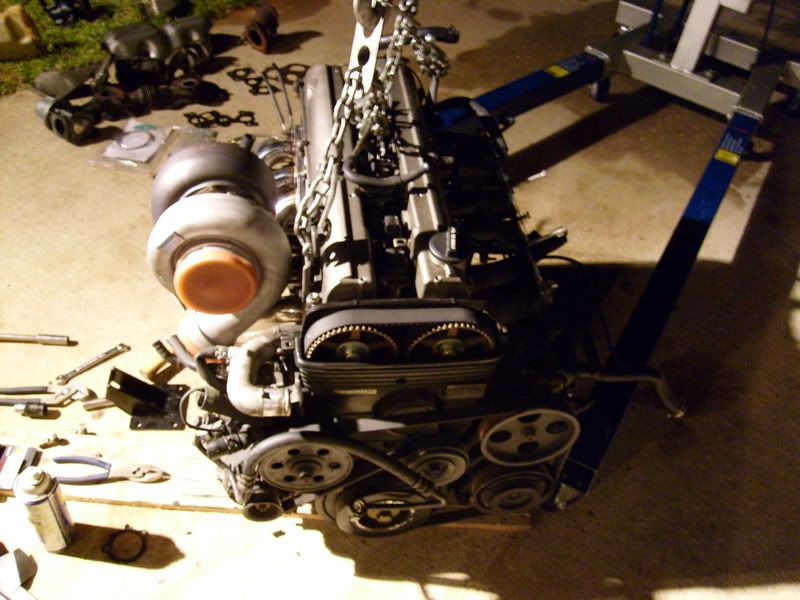

a little update. i have a few things to do.
i need to run a return line for the fuel, i used the return line for the second feed for the other pump
i need to get a tight bend 90 degree coupler for the turbo, which barely fits in the bay
i need to get a big fan for the radiator
tonight i pulled the rear diff out to swap in the LSD unit. i pulled out the fuel tank to put the two pumps in, which barely fit. took a little work to get them in. i changed the plugs for the NGK 6097's.
i also took out the flap for the traction unit and put in a fitting for the brake booster. i think i did a mighty fine job!
