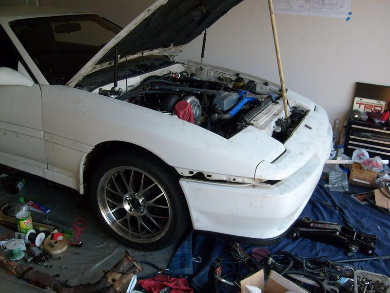

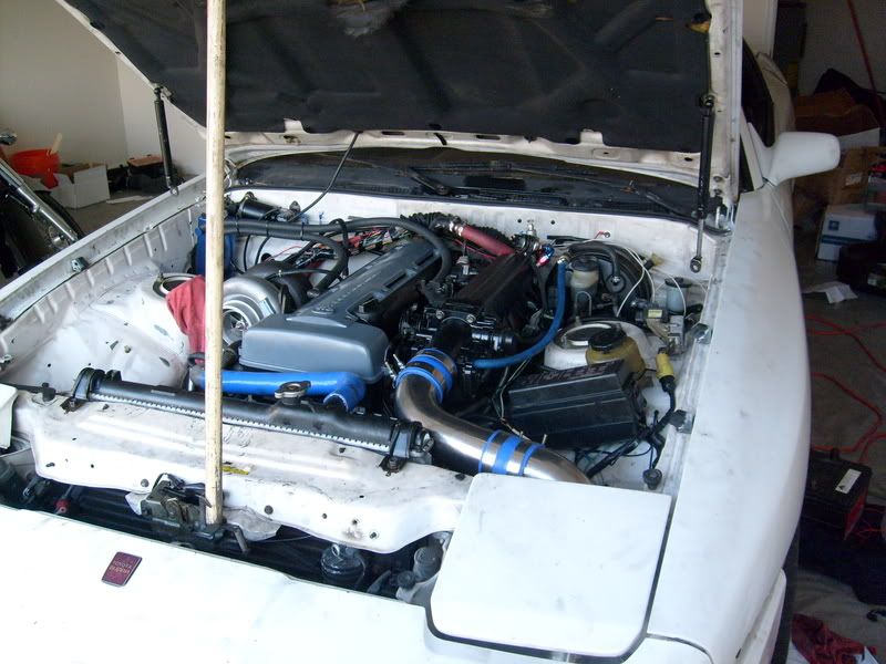

got a little bit done today.

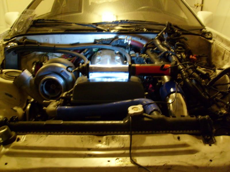

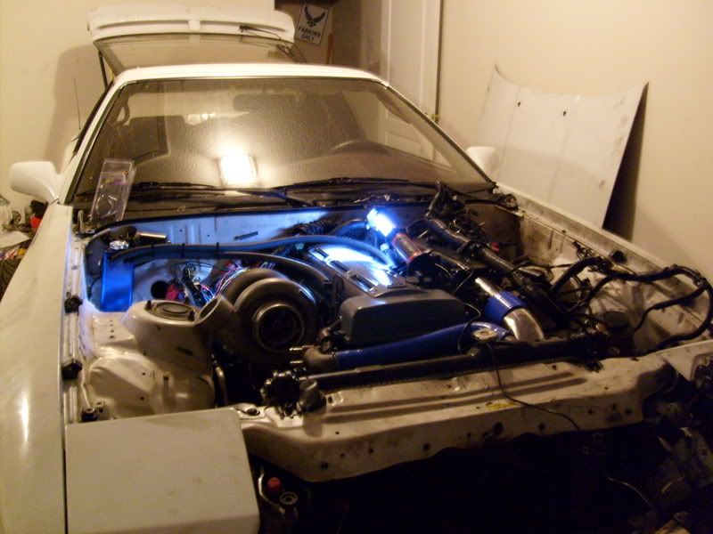

mounted the intercooler, wrapped the manifold in heat shield stuff.

ok, i am almost done. i just ordered all the fuel line fittings i need so all i have left is exhaust and a coupler for the turbo to the intercooler pipes. due to the limited space i have to get a tight bend coupler, i don't know if i need 90 degrees or 130 degrees, which one would be best.
i just got most of the wiring done. the engine does crank, but can't start just yet.
i also finished the interior and all that wiring

Beautiful build. It's always nice to get all the parts together before the engine goes in the bay; makes life easier. :D Lookin damn good though. Subscribed.

hehe i think its a common mistake when learning to ride :) it looks good - too bad the turbo is so fucking big Lol makes me want to do another 2j swap.. oh wait i am teehee :sarcasm: and a 1j!
looks like you got your engine out of a 91-92?

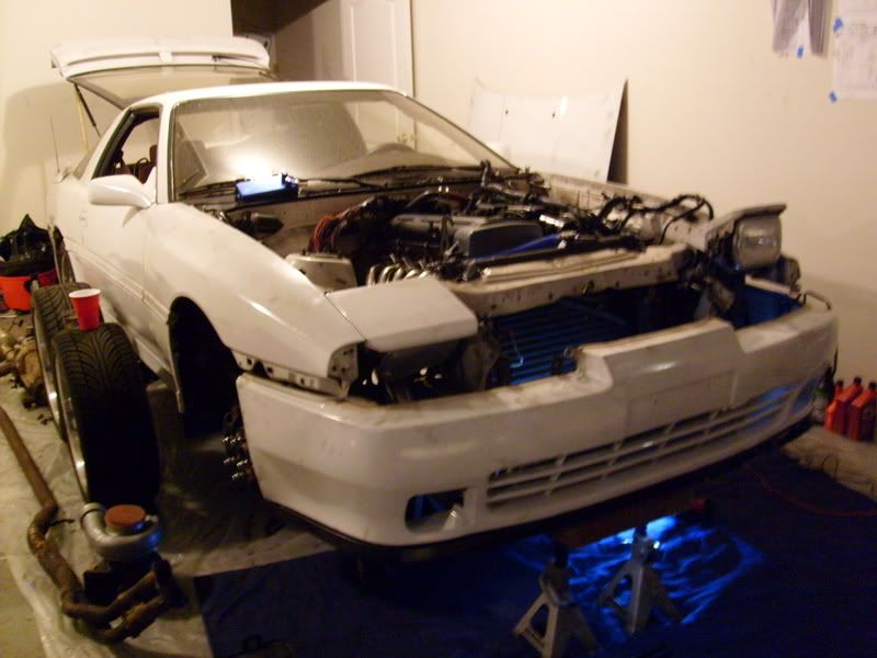

ALMOST DONE!!!!!
all i have left is to make an exhaust and hook up the oil feed line. and figure out a way to get the stock lines for the A/C to fit on the compressor. i already swapped heads but i can't get the lines on. the PS pump is in the way. and i can't get the pressure relief valve on with the nut on which hold the compressor to the engine. oh and i still need to wire the boost controller and run power lines to the trunk for the battery. and.... get a coupler for the turbo and put in the BOV's
geeze, still a lot to do

:love: Seeing this makes me wanna go single asap! what you doing for the downpipe? custom?
i'm gonna build my own exhaust and downpipe. i know 2 guys who have welders and know how to weld. i'm gonna be gettin a bunch of pipes from summit racing, cheapest way i know to go. then get a cheap nice looking muffler on ebay.
