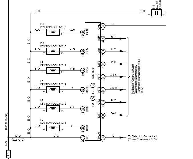

here's a diagram
suprastanger507mgte;1019906 said:
The black and orange wire that goes to the filter is the same one that supplies power to the ignitor. Its the thick black one. The white is the ground .
the one that feeds +B also goes to the filter which also goes to each coil. then the white wire you speak of goes to the other end of the filter, does it matter which way it's hooked up? i have 2 of them, so if i damage one, no big deal

suprastanger507mgte
2x88+2x89+1x91+2x92=ME
3,148
Hayward , Ca
crazysupra2JZ;1019956 said:
here's a diagram
You said you are using the 7m noise filter, correct? I don't think it matters. The 7m one both wires as black i believe.I can check my EWD and confimr later today.
