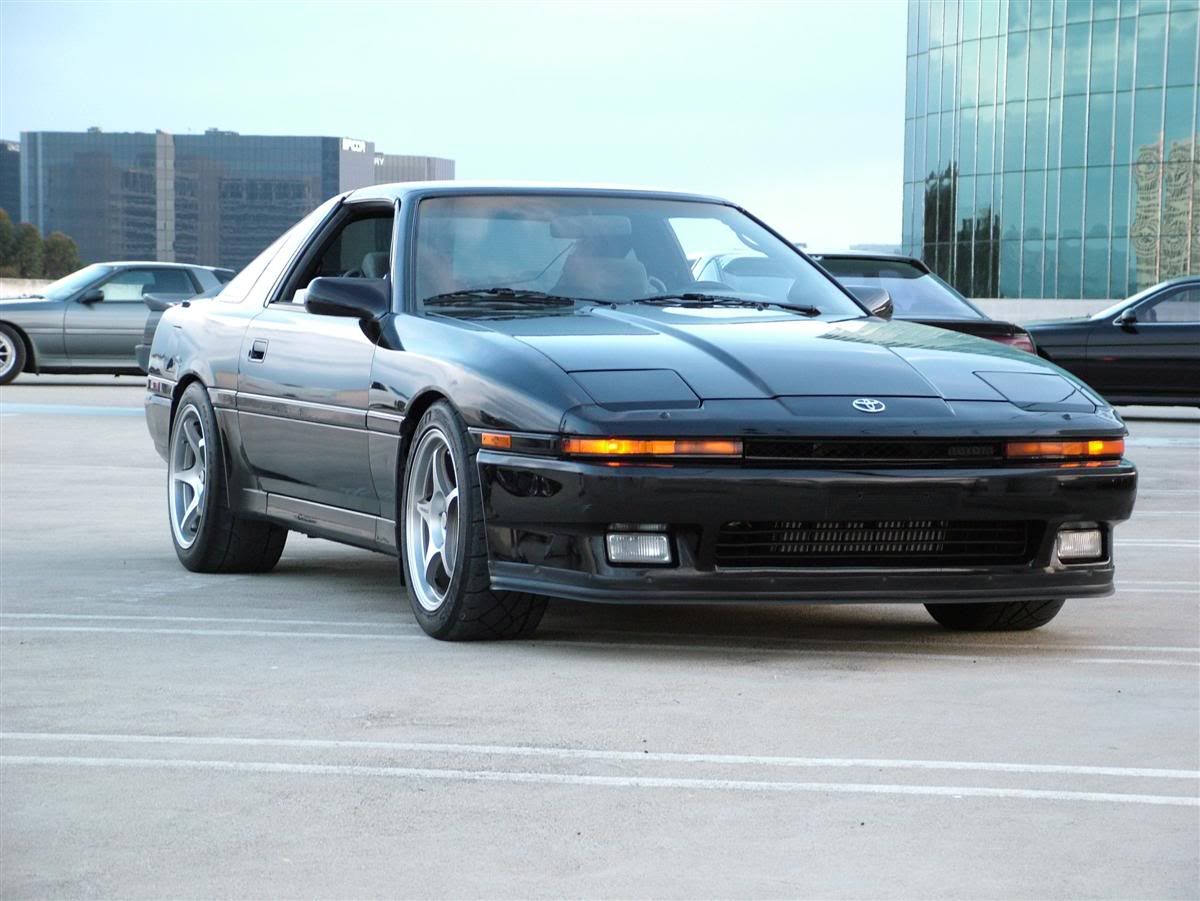

looks sweet to me! i'd do this if my bumper and lip weren't already fuxed to hell and back :icon_evilbigaaron said:I submit my entry for the Home Depot lip contest:

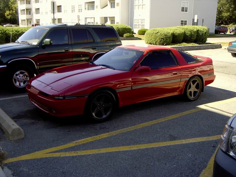

theWeezL said:http://home.comcast.net/~theweezl/lip1.jpg
http://home.comcast.net/~theweezl/lip2.jpg
http://home.comcast.net/~theweezl/lip3.jpg
Some people laughed and called it ghetto. While that may have been true, it looked good to me and that was all that mattered.
The files that showed the process have disappeared so Im afraid I cant show ya whats behind that. Its a simple support structure made from steel strapping and angle brackets. The covering is refered to as "cove base" and it is held in place with 3M heavy duty indoor outdoor foam tape. The cove base comes in limited colors but gloss and matte black are available. Had it up to well over 80mph with no ill effects. It did however make the car a pain to drive in and out of driveways and such.
