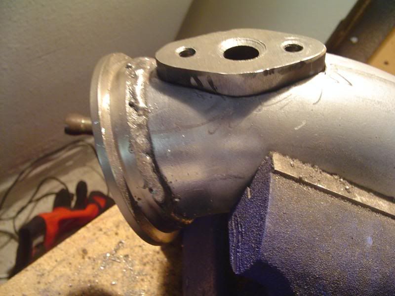

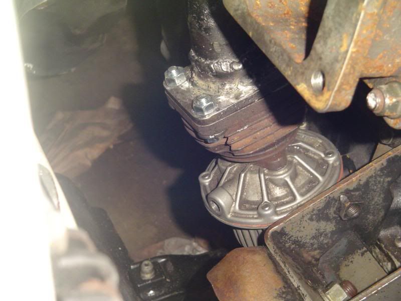

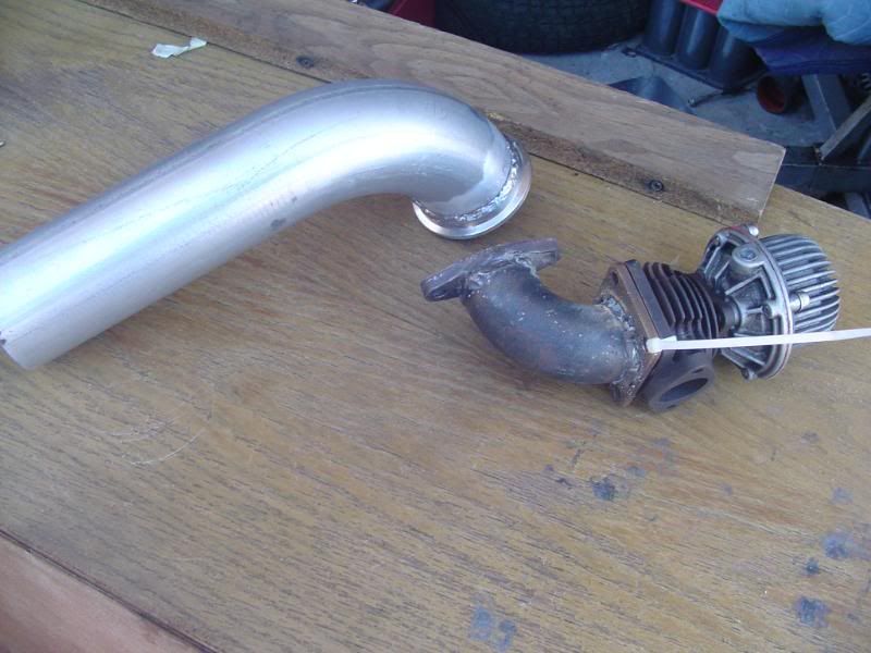

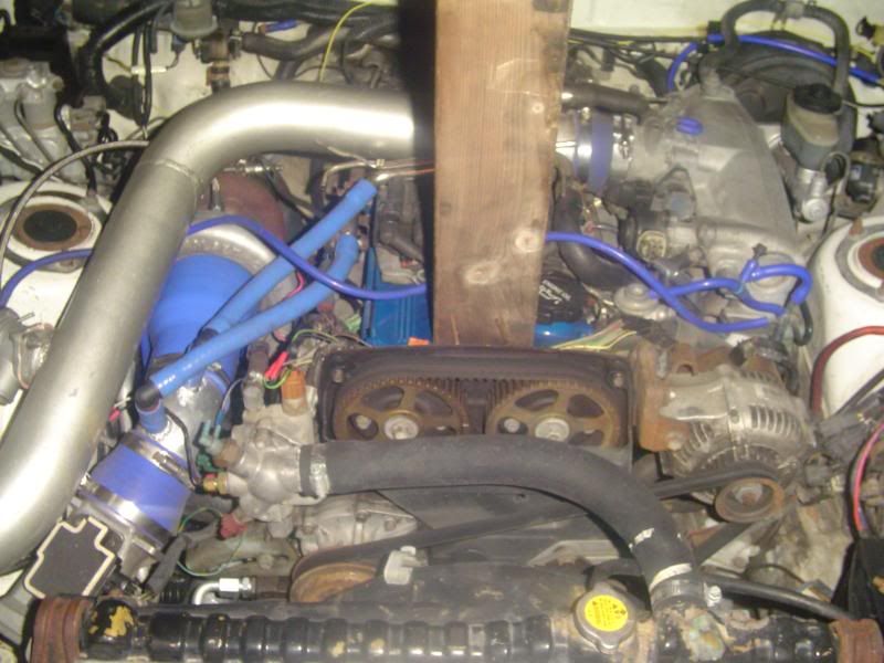

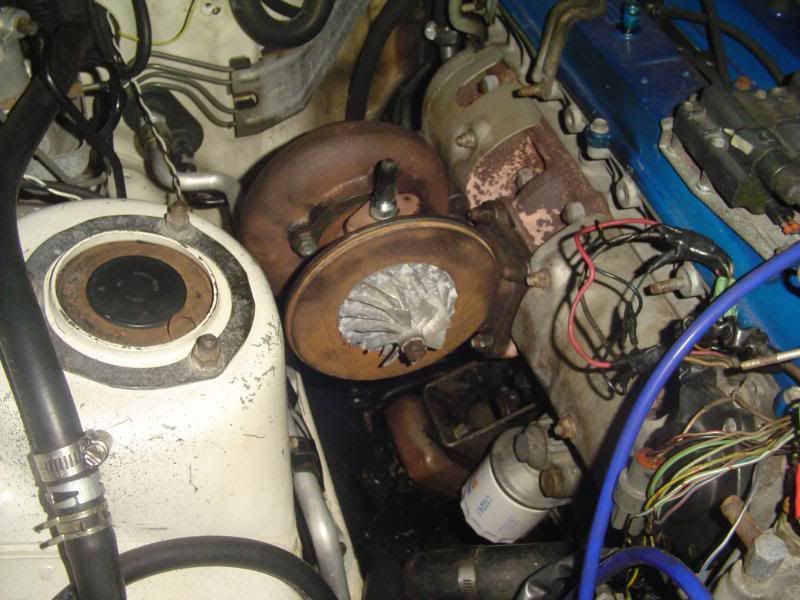

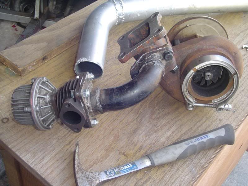

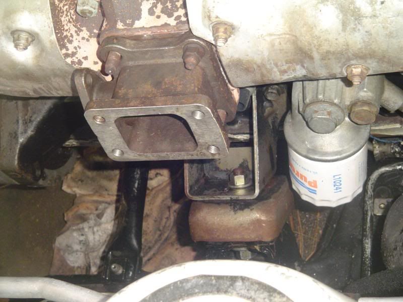

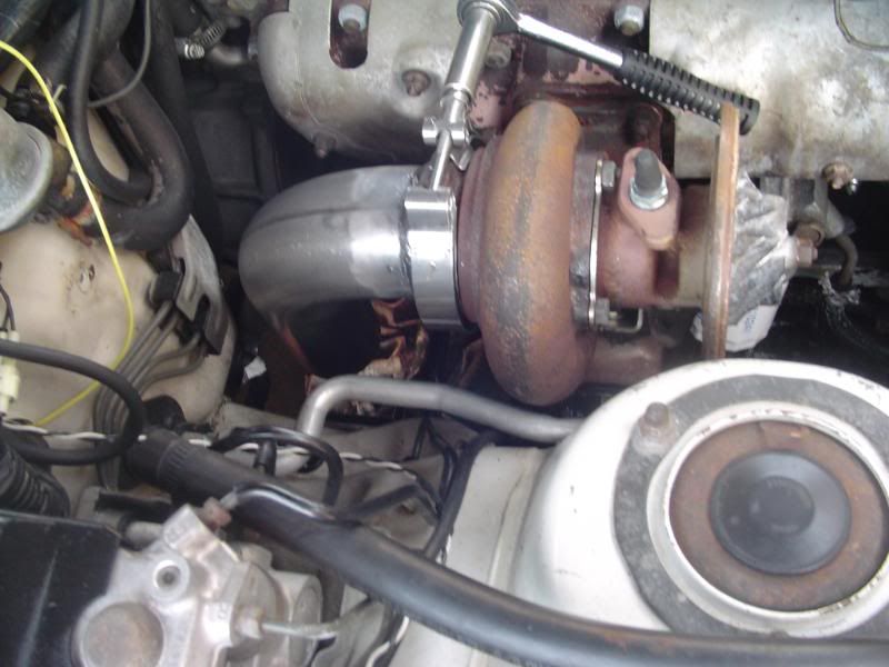

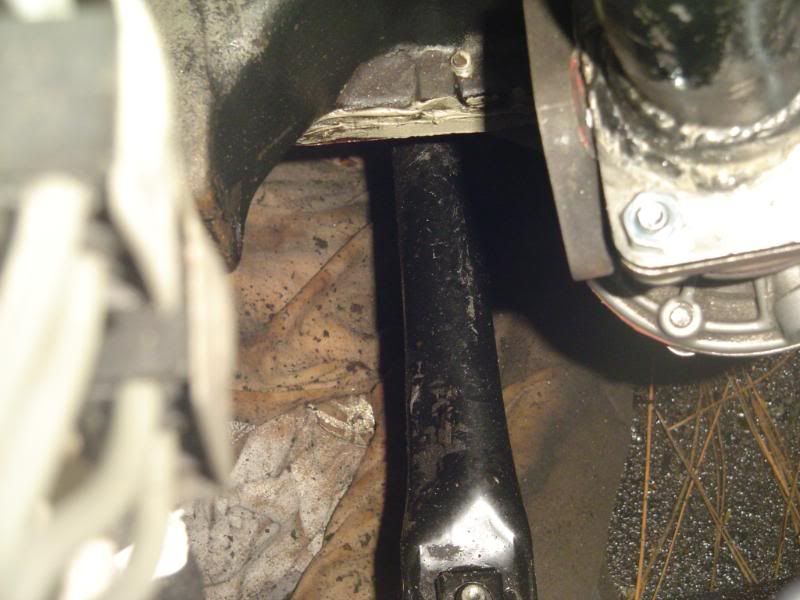

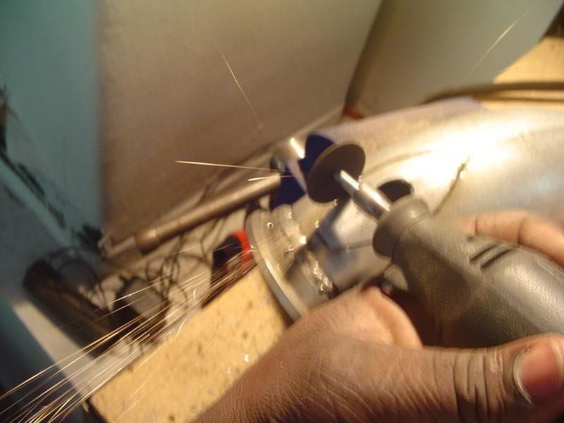

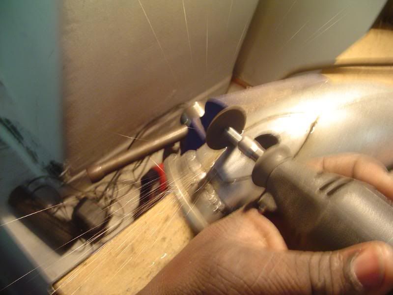

well here are some of the pics i promissed!
[/IMG]
fitting the small turbo!

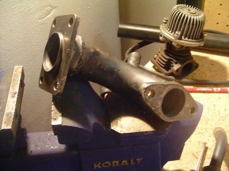

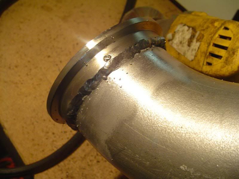

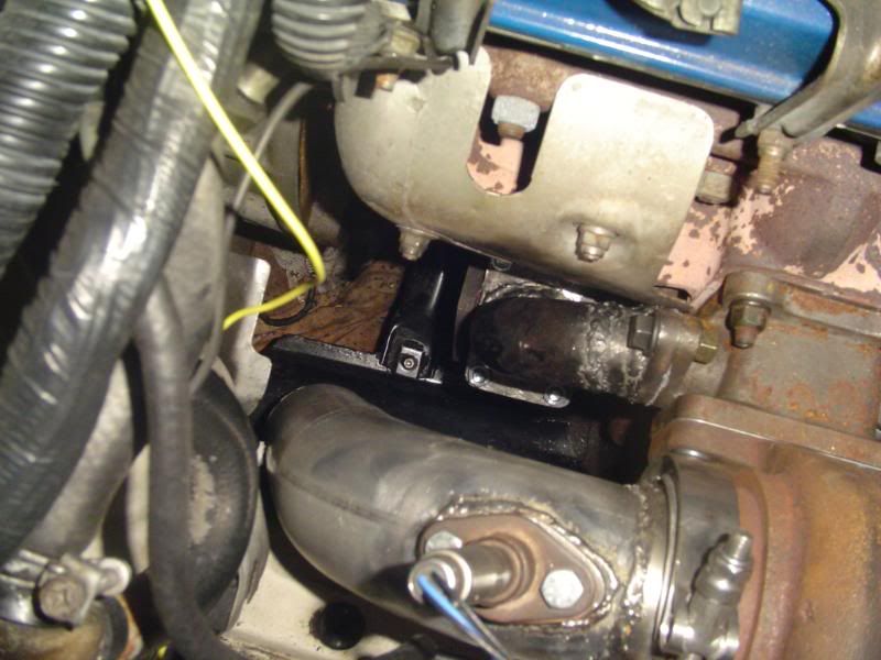

now fabbing up my downpipe! not bad for my first time really welding:dunno:

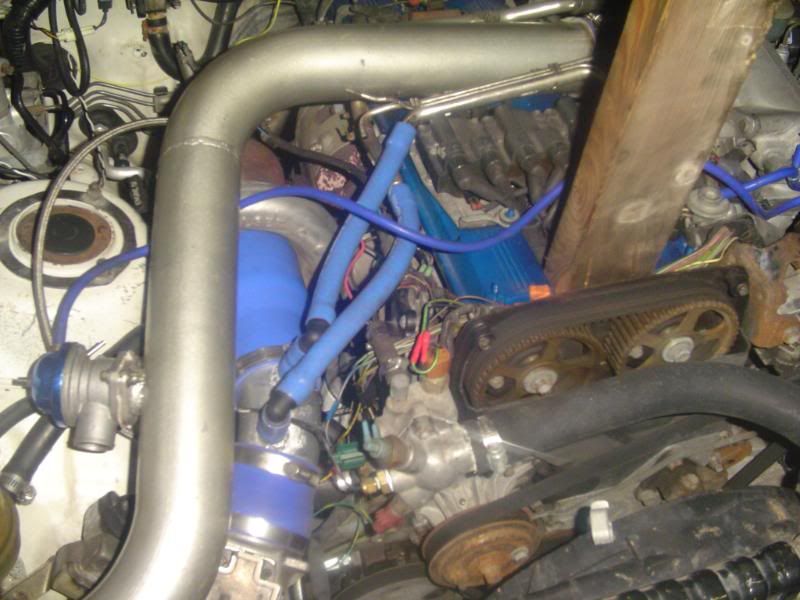

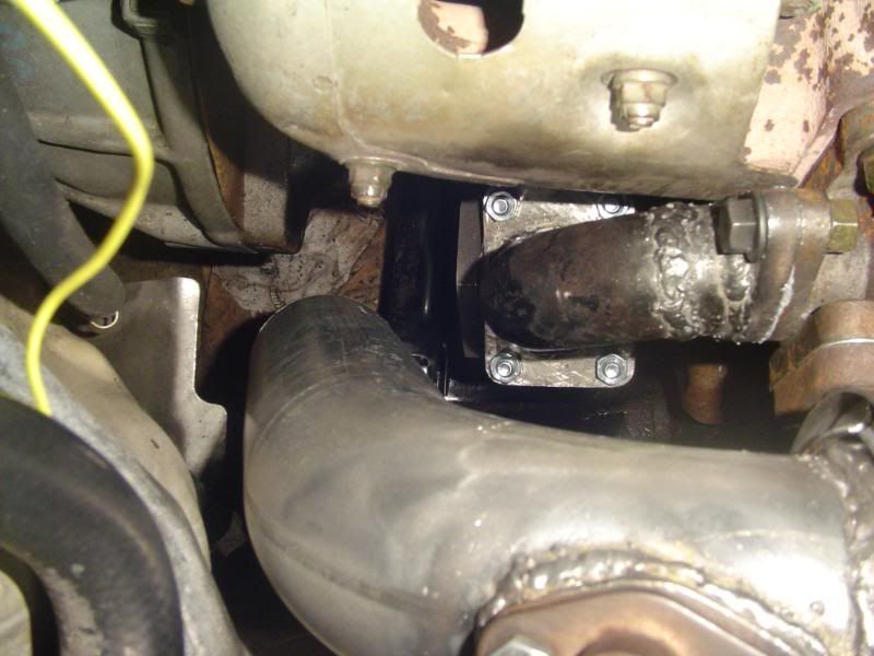

Now fitting the hks wastegate!

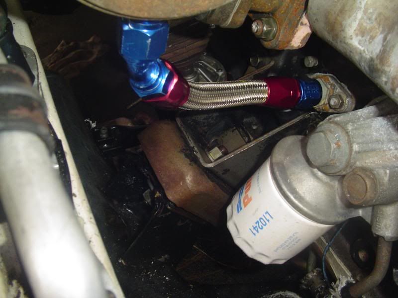

The drain all fitted!

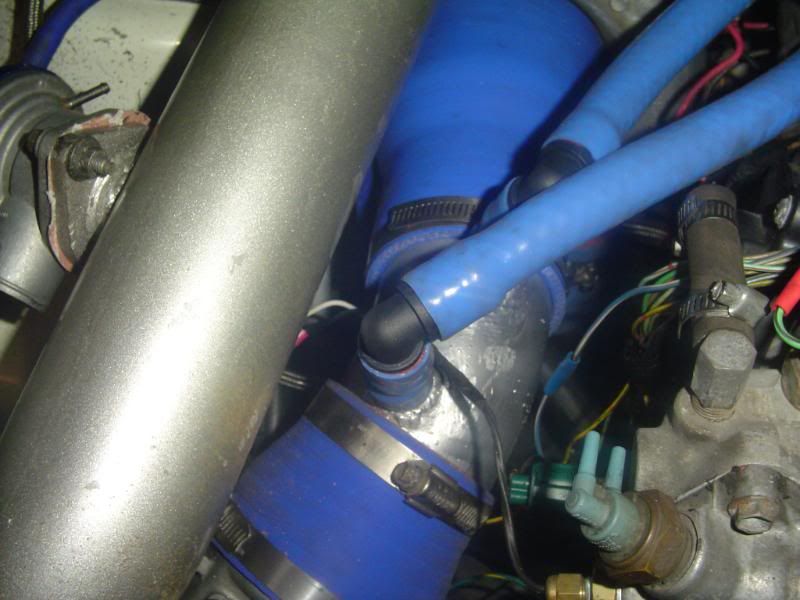

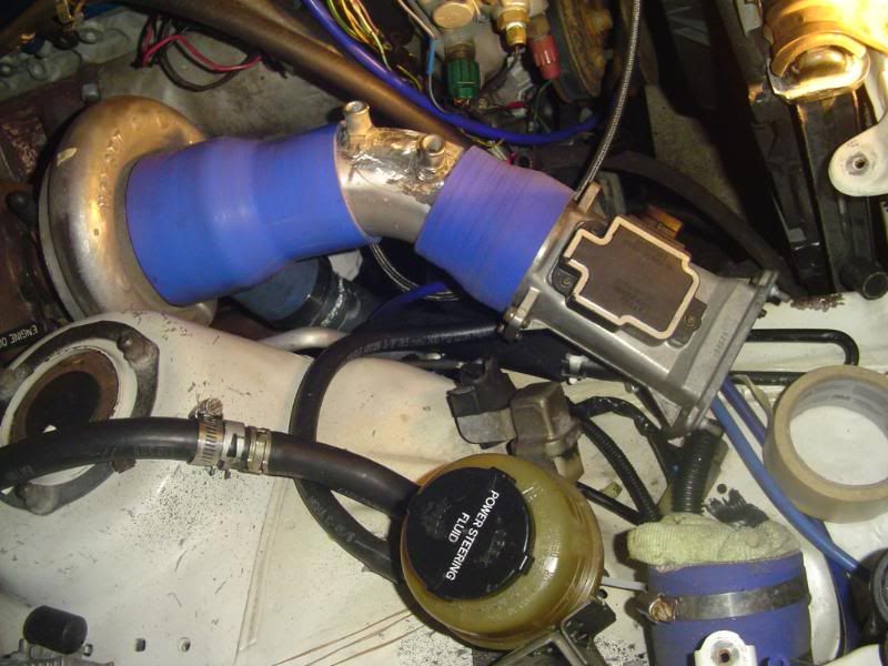

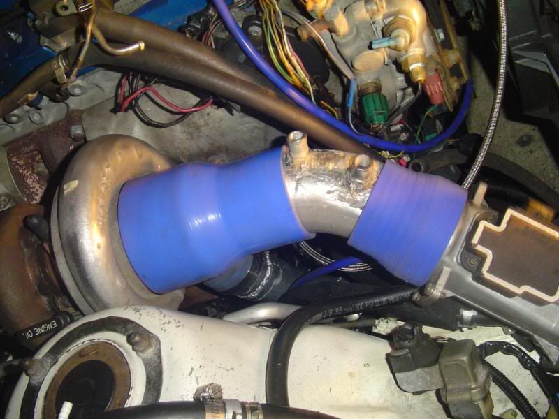

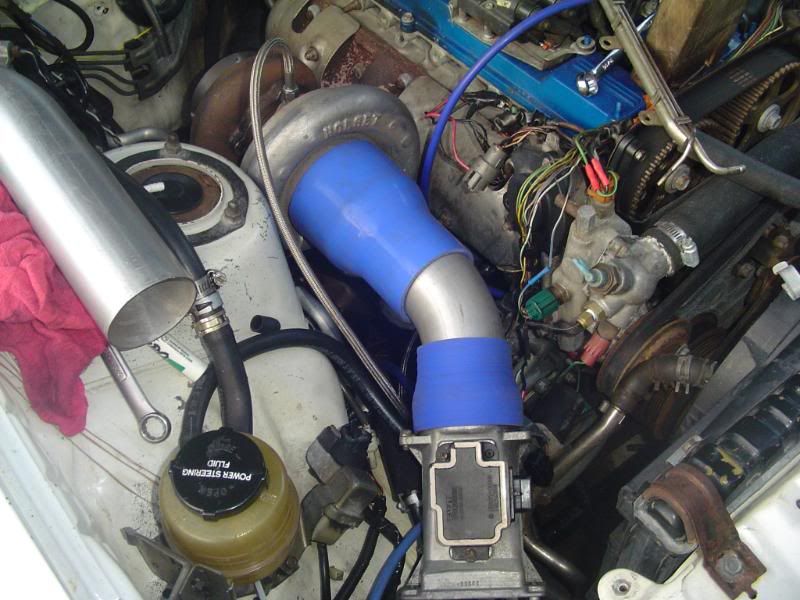

ok this is when i had to make up an turbo intake for my AFM...with out that pipe me car will not run!
so this is when i got the car all put together and it was running sooooo strong. 10psi from a ct26 and 10psi from an hx40 is like night and day. OMG that car pulls and spools so fast, i sware i'm not changing my turbo ever. like they say, don't fix it if it ain't broken.
i know thw engine bay is crappy but all that will be changing very soon!

NashMan;1705444 said:
your gate seams to be pretty far away and may have issues controlling boost
NOPE! th boost is right on! the manifolds from bay that 80% of supra owners uses has longer waste gate runners than my setup has!
NashMan
WTF did he just wright ?
Aug 5, 2005
4,940
17
Victoria BC
yae but they at lest use 2 tubes
in my car my car will do 15 psi on my stock 12 psi spring if remmber right
i just remmber a fellow person out thsi way did some thgin liek that and ahd issue wiht boost creep
