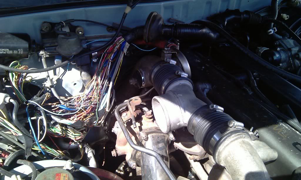

After seeing your pictures, I don't know if anyone agrees with me but the wiring could be your issue and I have no clue where to start....there's so much.
You did your harness?
vIetDrIfTeR
Mar 19, 2010
134
d town
yeah i did the wiring. all i did was extended the ecu wiring which is not hard to do. i did it one by one so i wouldnt get it all mixd up. and match it to the body. and all you need is the ecu fuel and power,ground to get it running. and im getting all of it. i rechecked it like 10 times everything working. only thing is not connected is my tems. which i believe u dont need to start. all my gauges works
i know how u feel. maybe it is my wiring but i dont think it is. im getting 12v to the ecu, injectors, igniter, fuel pump.
i disconnect the iscv plug and igniter. too see if it will jump a code and it didnt. is it not suppose to??

You have issues on that car. The wiring seems screwed. Why, if you disconnect an igniter and tried cranking, you will get a code, I believe it would be 14. Disconnect the IAT, you will get a code without even having the need to crank.
If no code appears after doing that, it has to be in your wiring or computer.

Just because everything getting power doesn't mean the wiring is right.
Try a different ECU. It's known to cause these issues but with your wiring, I am not sure anyone would want to lend your their ECU...

Start going through all of your sensors to see what's up? All of them. Sensors can give bad readings and not trigger a code. I have seen it.
All the specs for each sensor is in the 2JZ TSRM(MKIV TSRM). The link to that is also in the JZ thread in the link section.
A member had the same issue as you and it was his harness being messed up. This was on a 7M but wiring on any vehicle can cause many problems.
Go there and read up. I won't post the links here, the link to that thread is in my signature, just click it.
