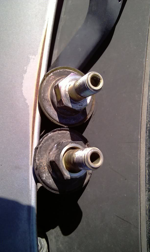

Well, why not bypass the dampener and see what happens.
It's not hard to do. Look at the picture, remove the dampener and get a banjo bolt to hold the top line in.
It's a bolt that is hollow with holes on the side. You might have one in your parts bin. What you could do is bend a stock 7M feed line, it can be done but takes time.

Have you checked the flow after you put the banjo bolt on? Way it bored in the middle and on the sides?

dude i ask like a 10 times how do you test the fuel pressure??????????????????????????????????????????????????????????????????????????there no valve to test it!
yes it did had holes on both sides. and yes the flow is 20 times faster. i got me another dampener too
here how my fuel dampener looks
