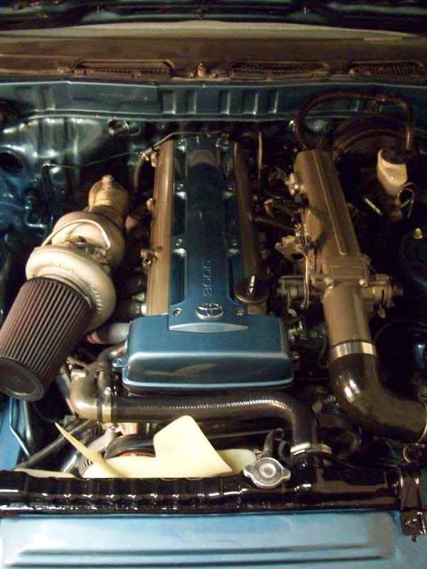

detailed the motor tonight to get it ready for vegas, and finished the clutch.

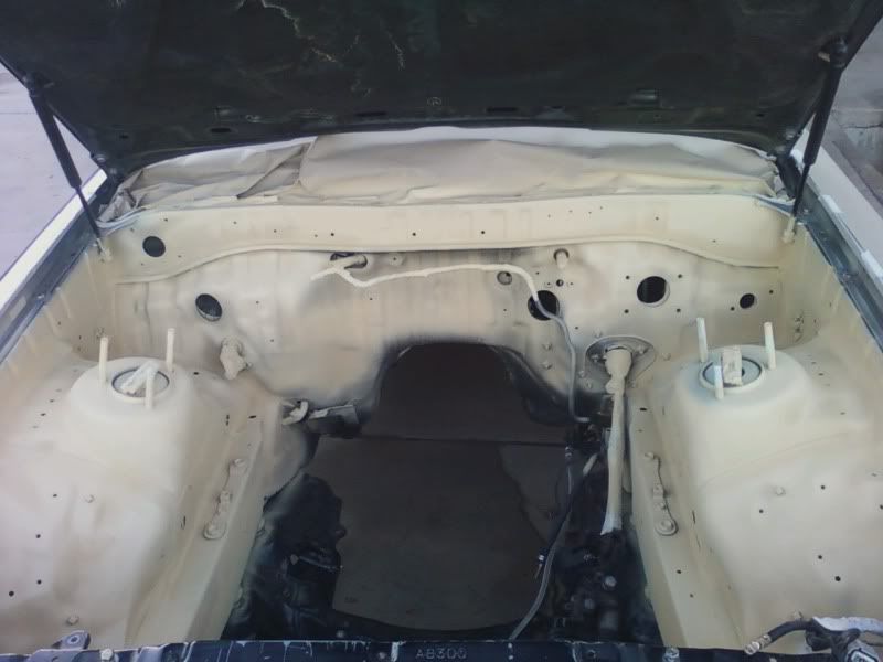

Thats my secret :icon_bigg If you cut a 2.5 inch hole in the firewall behind the intake manifold you can run the harness through the dash behind the cluster and into the glove box with out any extending. This works for both 1j and 2j swaps as multiple of my friends have done it. Makes it look so much cleaner. As for the other parts of the body harness I tucked it all under the fenders.

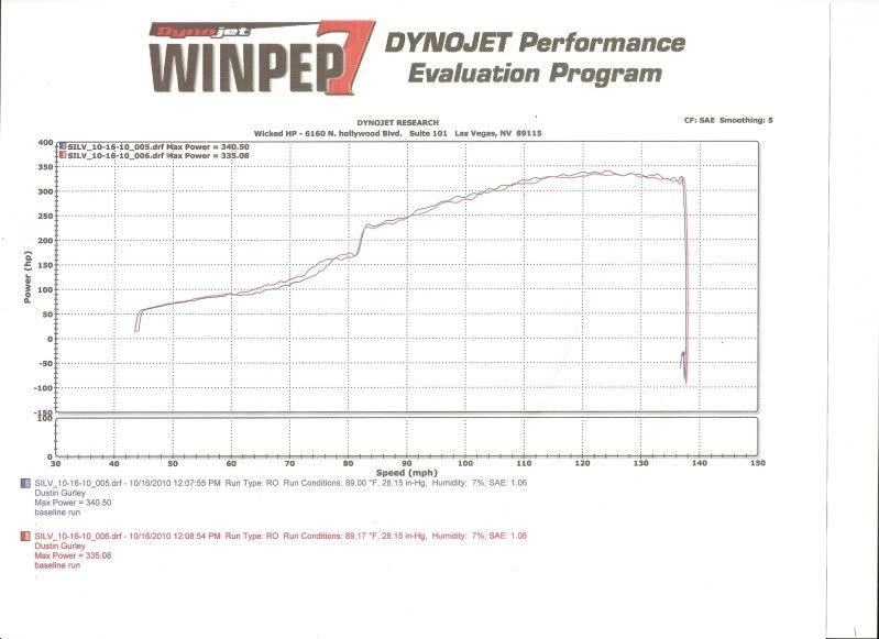

Went to SILV and dynod the car and it made 340 hp at 11lbs Heres the dyno graph and the video.

Nice. Those are some
Good numbers. Still in stock computer and fuel? You can hit 400 easily if you raise the boost and upgrade the fuel. I am not sure but 550's would be enough to run 400 to wheels. I can be corrected.

I am not sure but could you E-Mail me some pictures of the hole you cut in the firewall to route the wiring harness, exactly where to cut. Don't want to make a mistake there. :-/

Looking good as usual. I'm about to go 2JZ as well and just have a question.
When cutting the hole behind the intake for the harness.. does the wire harness fit easily without extension or does it just barely make it where it needs to go? Also, is there any chance of you recalling exactly where you cut the hole? Is it visible at all with the engine in place?
Thanks!
Albert
May 13, 2009
1,710
Tempe, AZ
On my 1jz with a Jza70 and a Jzz30 and also with his 2jz , cutting the hole in the firewall (with is just below and a little to the left of the throttle cable hole) allowed us to run the harness behind the cluster and be able to make it to the glovebox without extending the harness at all.
and No you can see it unless youre back there trying to look for it.
Heres a refrence of the hole:
And with the motor in:
