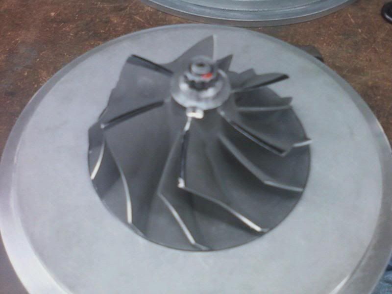

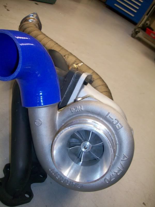

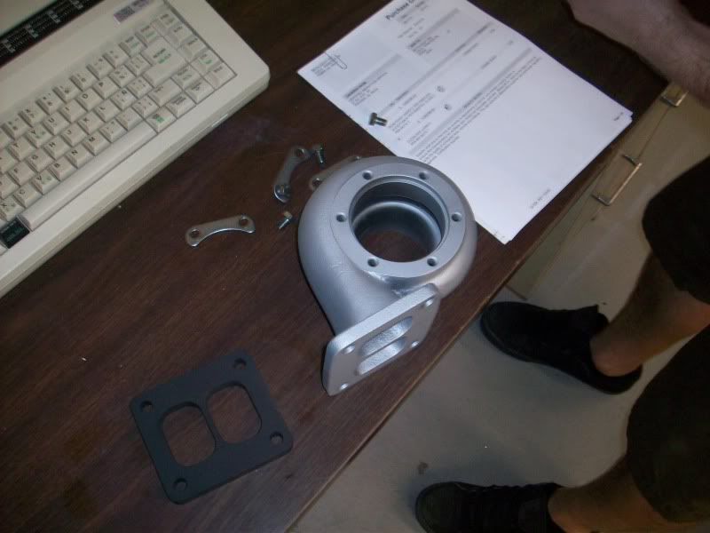

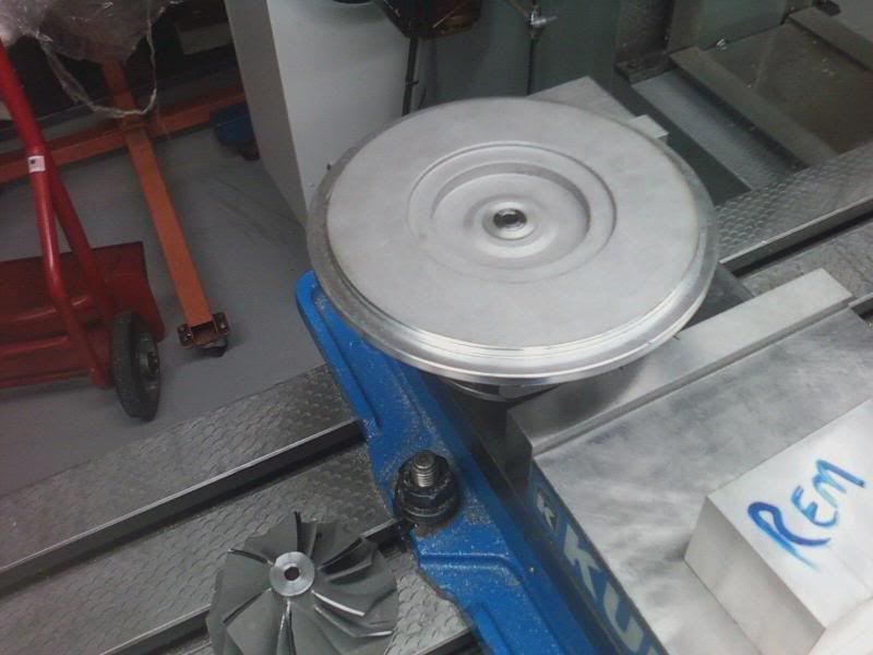

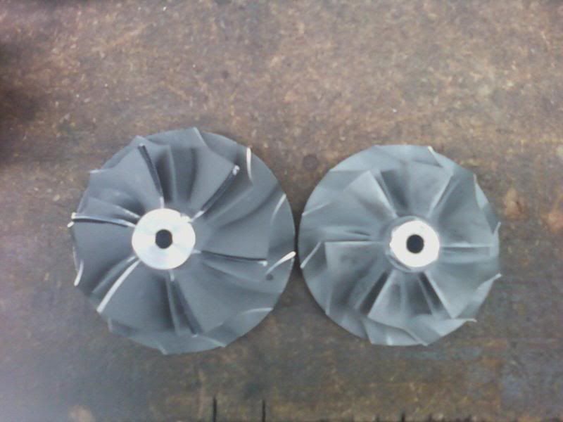

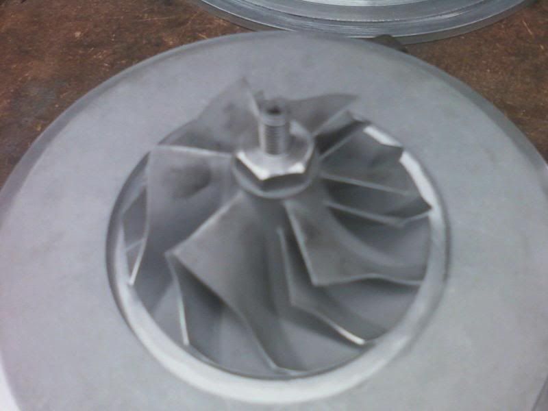

The turbo that I am getting used to be a 60-1 but I am having it converted to a 67mm turbo by my friend who works at a Aerospace machine shop. We ordered a 67mm wheel from Garrett along with a new ptrim wheel. The hot side is a .70 divided housing with a S cover on the Inlet. Here is pics of the turbo being cut.
Old Wheel
Wheel Comparison
New Wheel

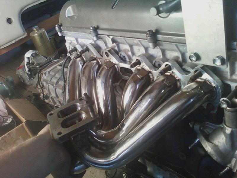

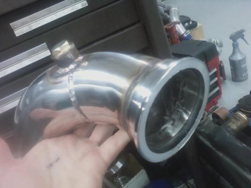

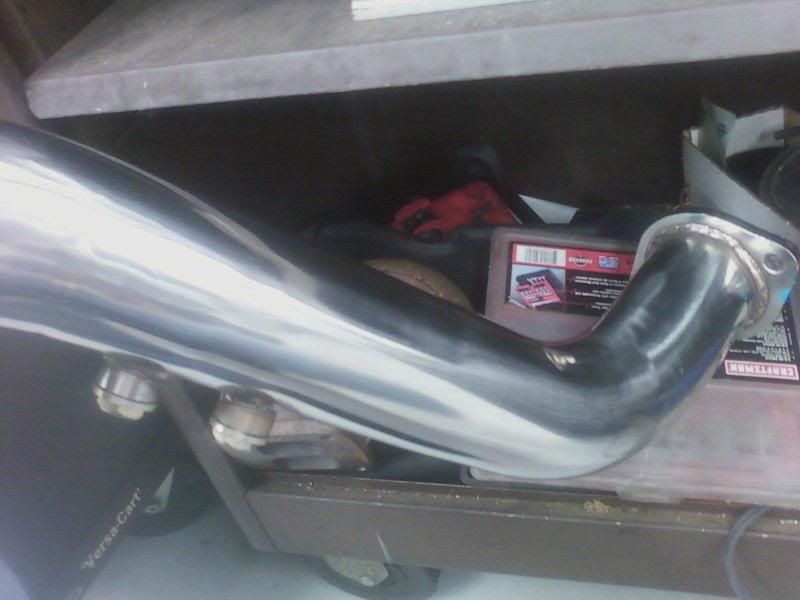

I also picked up a used LC-1 and bought the new sensor for it. As for parts the divided manifold is in the mail and the the down pipe has already showed up. I also installed a RFL BOV and finished the 3inch mandrel bent cat back.
Downpipe

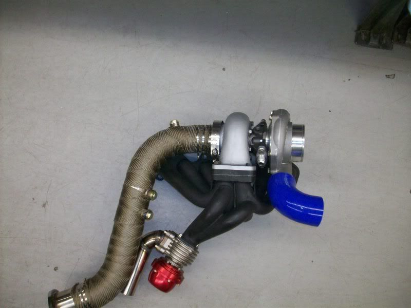

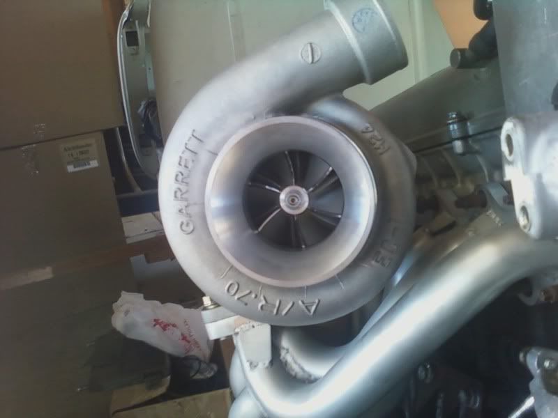

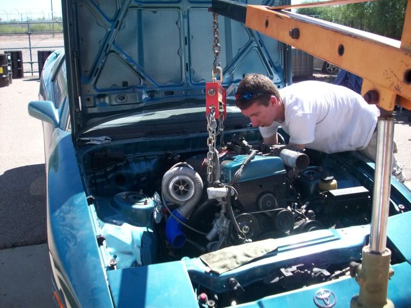

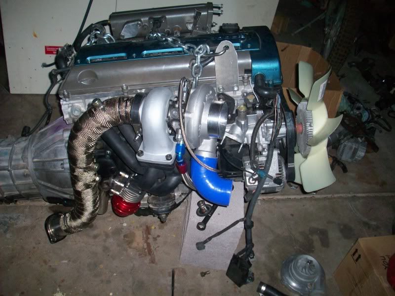

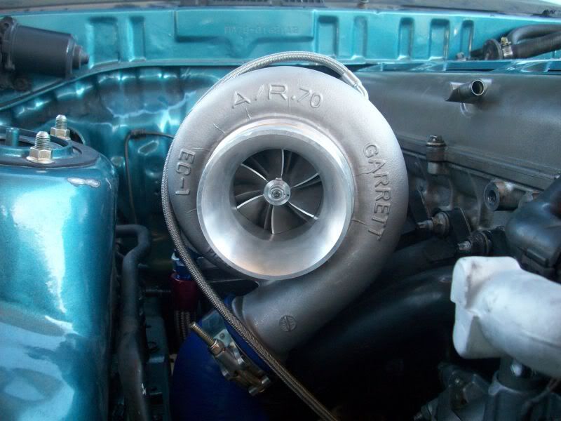

Update time:

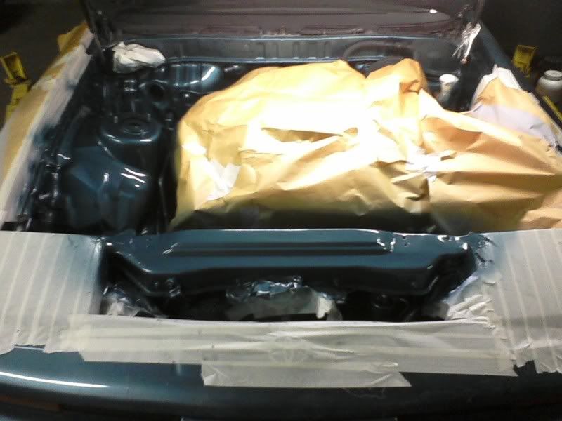

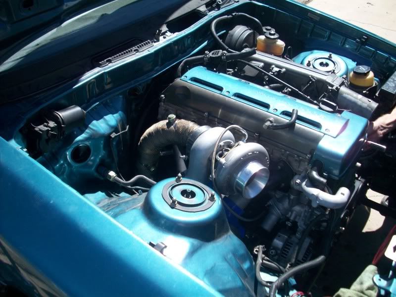

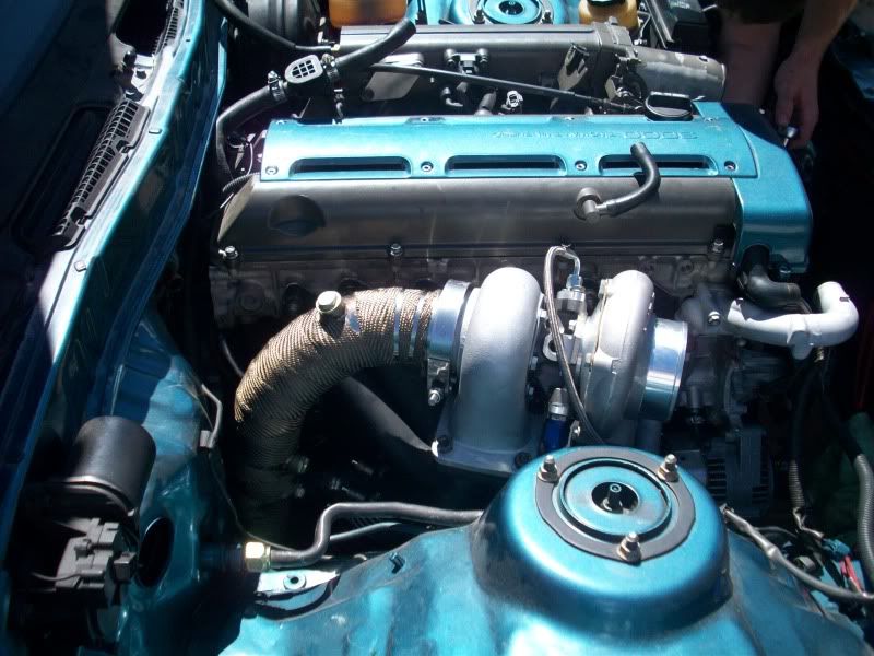

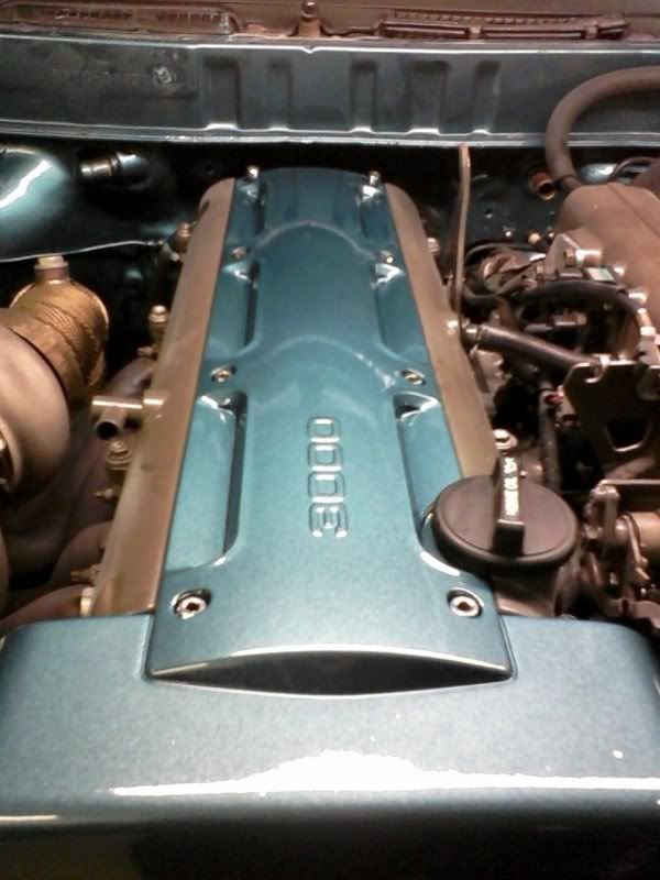

Finished my single swap about two weeks ago and the T67 is feeling great at 14lbs, Here are pics of the install. Im also working on putting in a competition clutch stage 3 ceramic disc before SILV as well as touching up some areas in the engine bay that need to be resprayed. I also got new tires for the whole car, I originally had Falken 452 Fronts: 245/35/18 Backs: 265/35/18 and I now went with same brand but did Fronts: 245/40/18 and Backs: 275/40/18 and the ride is considerably smoother with the side wall change. You can see in the pics that the throttle body has the traction control delete and the water neck was shortened so that the fan does not need to be shimmed away from the motor.
Also have a cast elbow coming in the mail that will be welded to the compressor housing because the silicone couplers cant handle the heat and burn through about every 500 miles. Lastly I ordered all the material to do a full 3'' SS exhaust system, but sadly the materials wont be here in time for me to make the system before Silv, so Ill be on my old crappy system. :nono:
