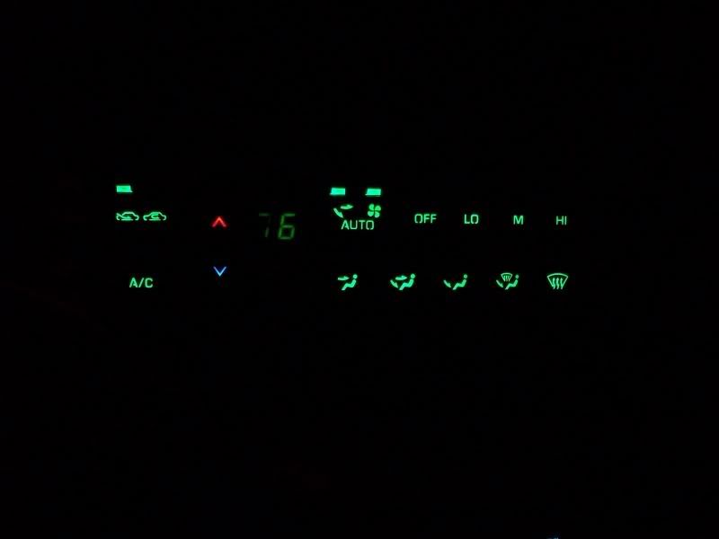

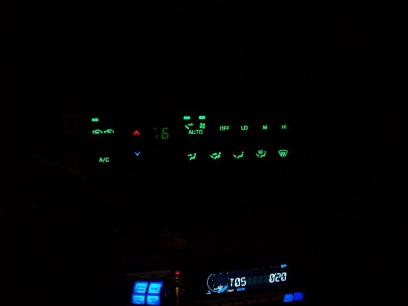

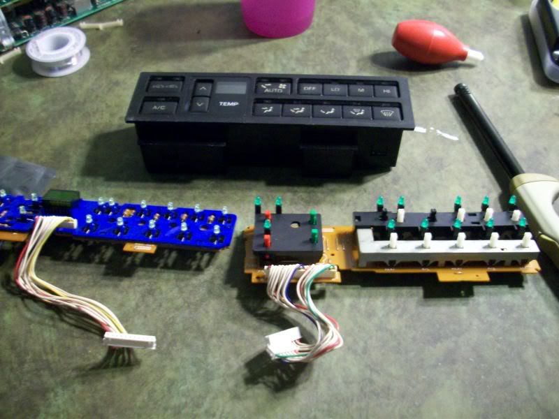

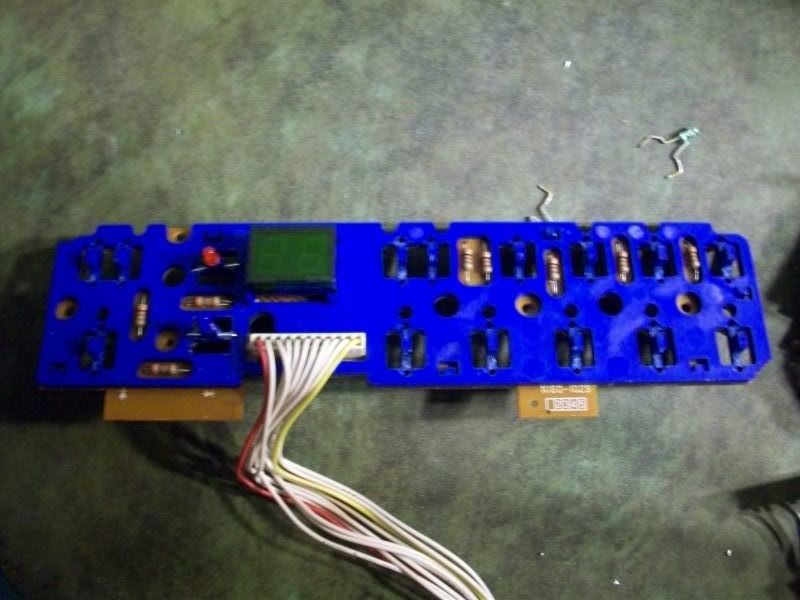

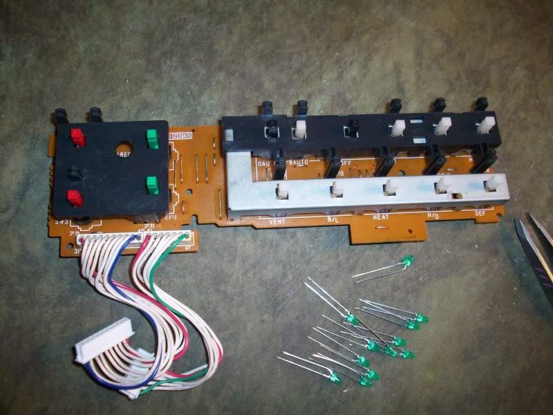

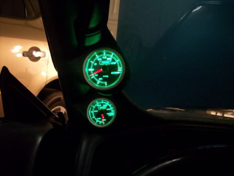

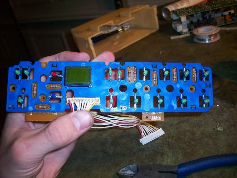

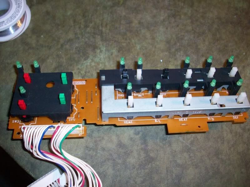

This evening I got in my prosport water temp gauge and the LED's for the climate control conversion. Heres the pics, I love it cause now the climate control matches the prosport gauges. Just need to order the LED dropin bulbs for the gauge cluster and it should be completed.
Heres the process... BTW ive noticed 2000mcd brightness on the LED's are perfect they give about 10% brighter look then stock
Old ones out
New ones in
Prosport gauges

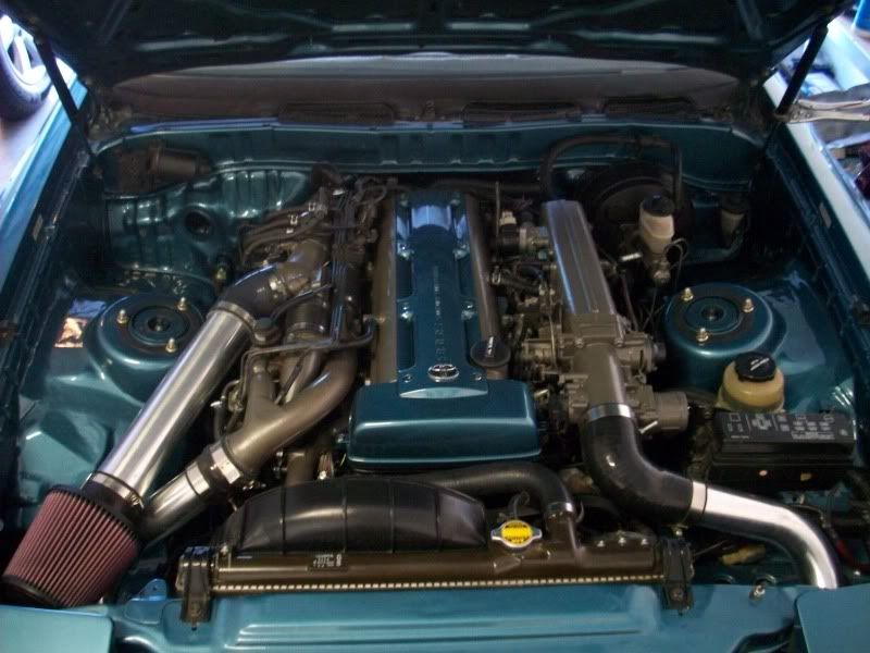

Finally got my harness and fired up the motor this weekend...Heres the video...

What power sources did you use (ign switched and light switched) for the prosports? I have a premium white/green boost gauge that I need to wire in but not sure what to use :)
IBoughtASupra
Mar 10, 2009
4,455
Queens, NY
Tap into the radio. Figgie told me about it. When looking at the plug, holes facing out. It is the first two wires on the right hand top row. One is constant and one is switched. A simple test light will help to determine which one is which.
gurley0916
Gurley=Last Name not girl
Mar 10, 2008
1,138
Columbus,OH
Ya the start up was very nice...for the prosports I used the power from the cigarette lighter and I ran a wire to the 12v source on one of the side markers for the gauge switch to green.

Here's some crappy vids of it running...Im loving the power of the motor and the way TTC feels with power delivery!! Im doing 15 psi now with the twins...
