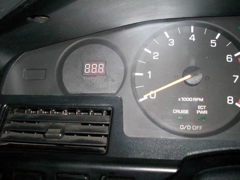

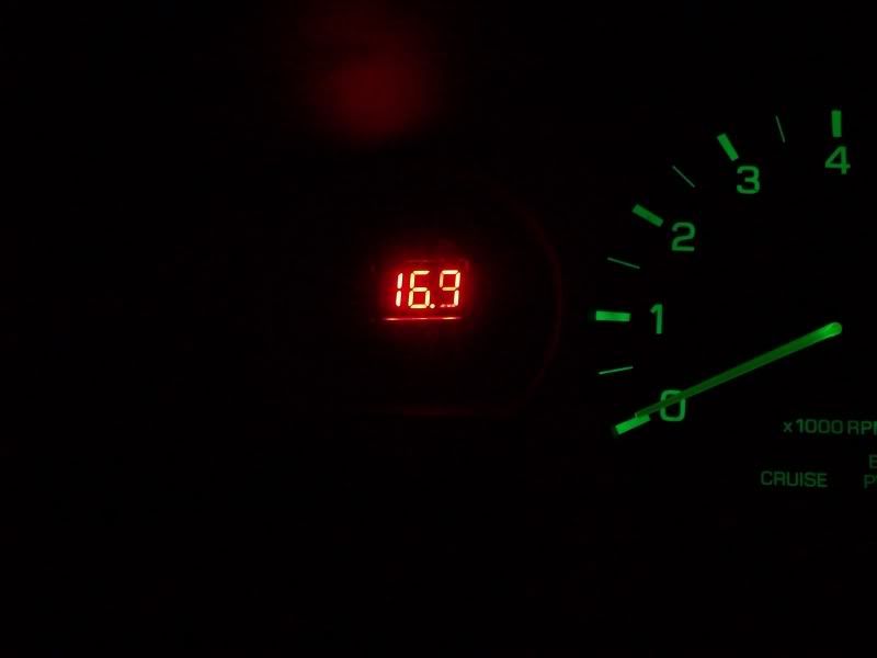

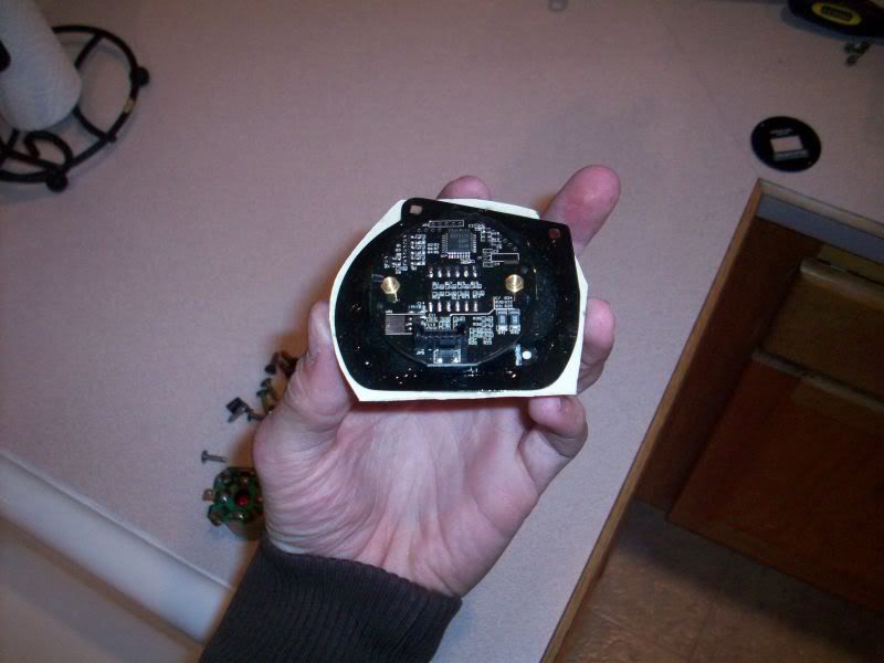

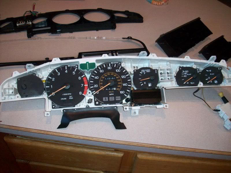

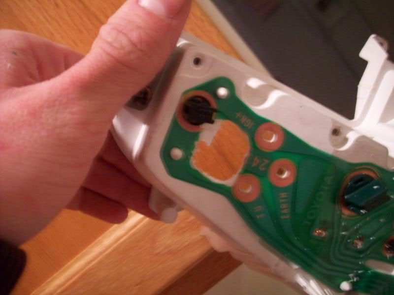

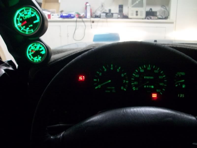

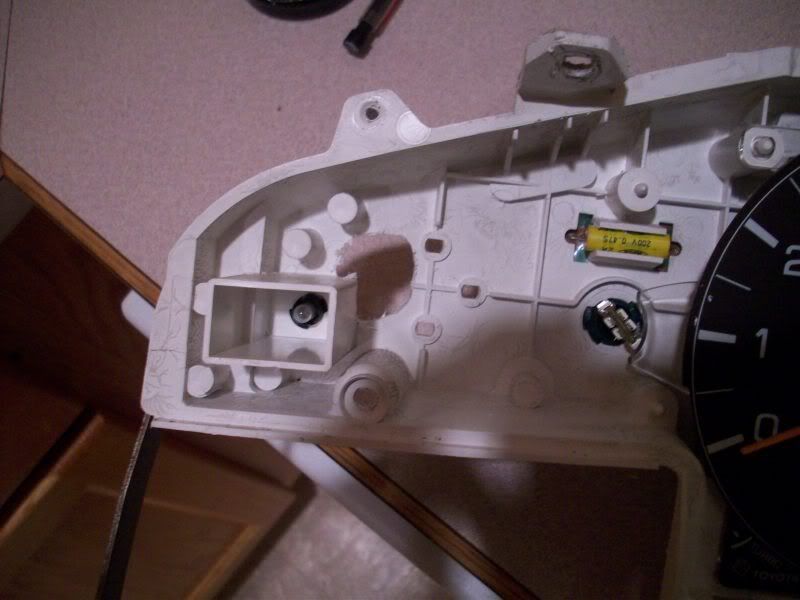

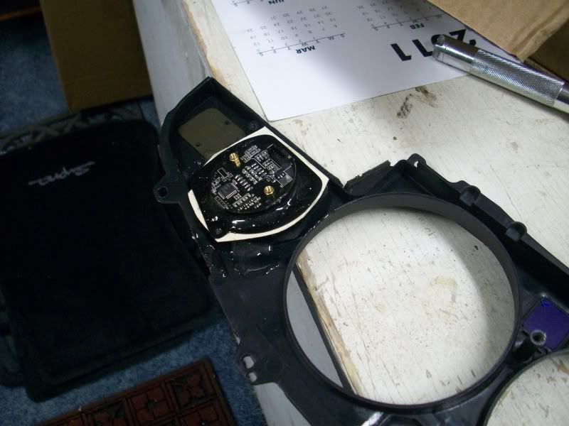

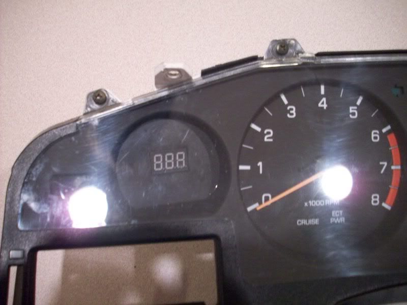

Well I installed some 550's and a lc-1. I also did a custom gauge install for the lc1, some people might not like it but I do. I didnt want to add another gauge in the car and my water temp was not working. I also have a water temp gauge by my boost controller so I didnt need the stock one. here the pics
Only problem is during the day it can get tricky to read, the display needs a piece of tinted plastic over it that I am still trying to figure out what to use.
arknotts
formerly ark86
Jan 9, 2008
461
Ohio
I like it! I wanted to mount my water temp and oil pressure gauges in the stock locations, but backed out being afraid it would look really cheesy since it's hard to mount gauges in the stock cluster. Plus mine were peak and hold which I will need access to. Yours looks like a really clean install!

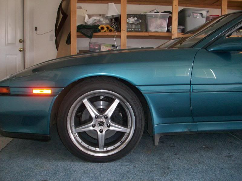

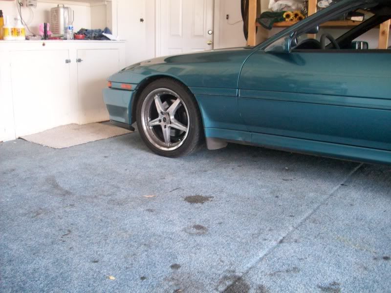

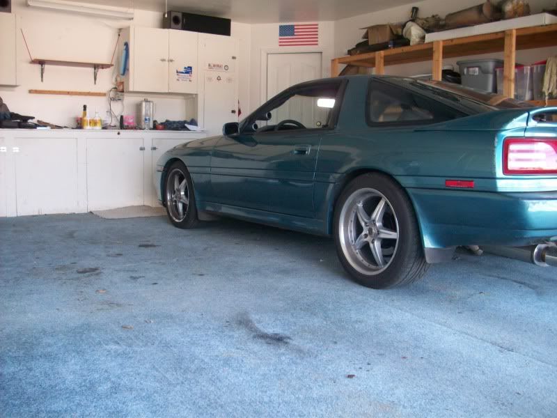

Nice. What size rims are those? My blue car is running Volk 17x8 in the front and 17x9 in the back. Not sure of the offset but the back has some wide tires without any rubbing or bulging out.
gurley0916
Gurley=Last Name not girl
Mar 10, 2008
1,138
Columbus,OH
There cheap rims from the previous owner, there liquid metal f5's and there 18x8 in the front 18x9 in the back with 245/40/18 and 275/40/18 falken tires

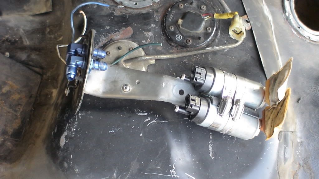

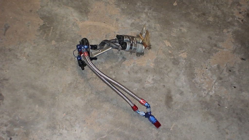

Just ordered a fuel line and supplies to do a dual walbro set up that will be capable of running e85.
Im running dual -6an PTFE (teflon) SS line from the tank to the front of the car, and a -6an return.
Still got to get a regulator, fuel rail, and injectors.
Heres how im designing the hanger (credit to bigzavs)
there wont be a Y fitting it will be two feeds.
Im doing all black SS hose and fittings

You will loop the -6AN line to a -8 or couple them to one -6 line.

No both -6an will feed both sides of the fuel rail, of couse there will be a -8 to -6 reducer. and then a -6 out the middle for the return. So in total I will have 3 new fuel lines ran
