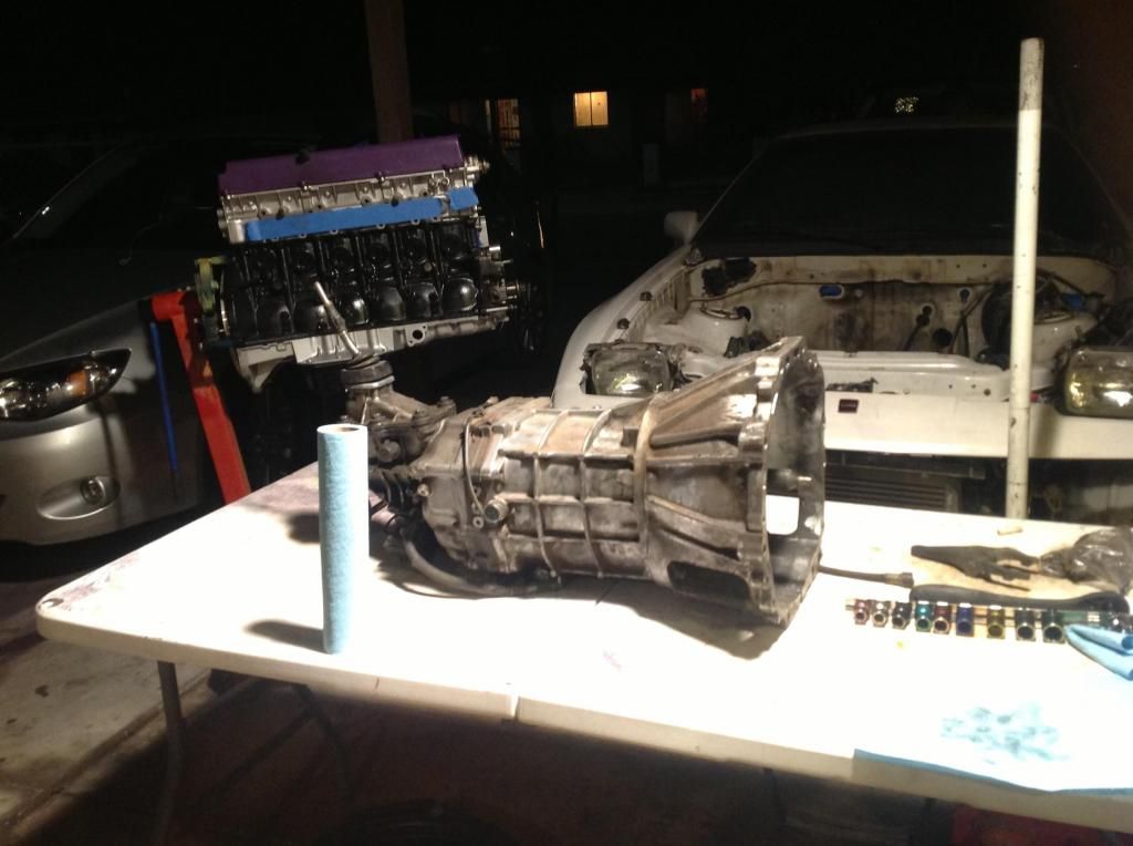

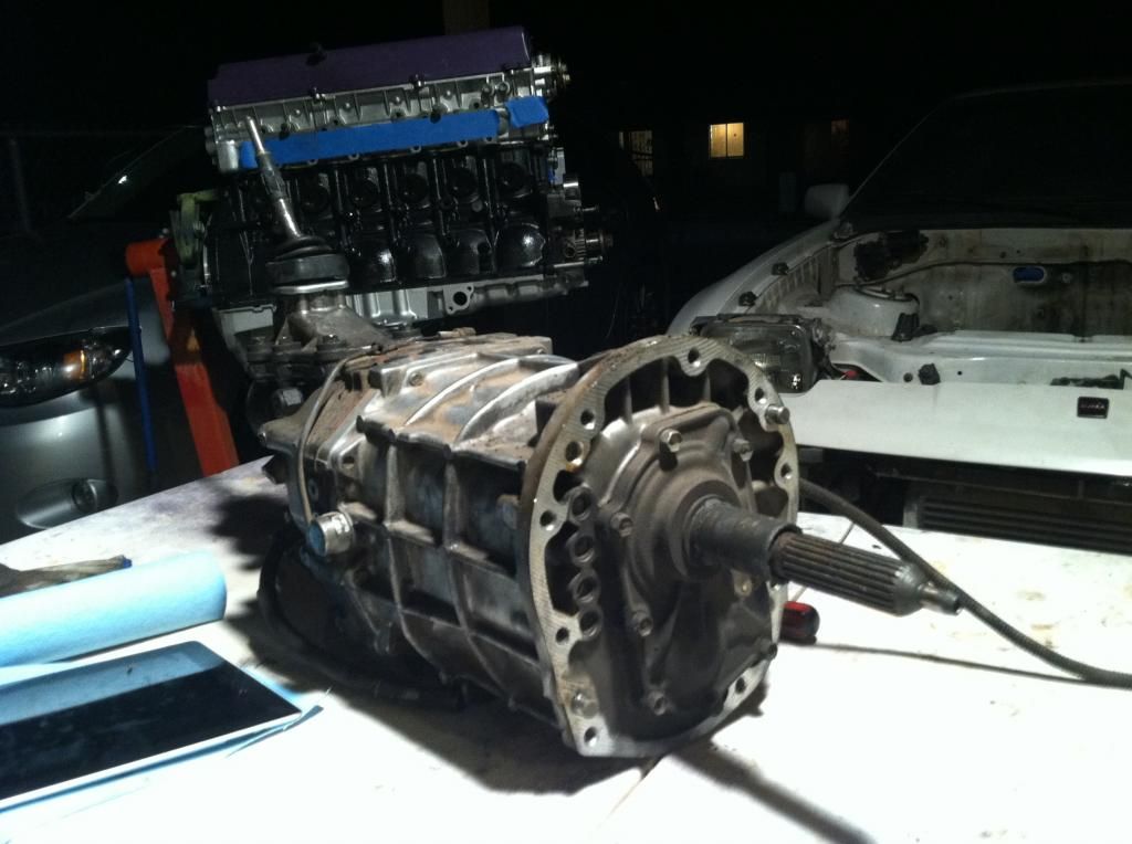

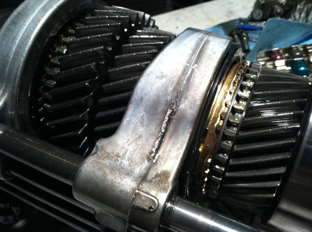

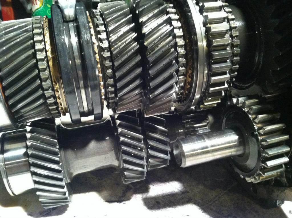

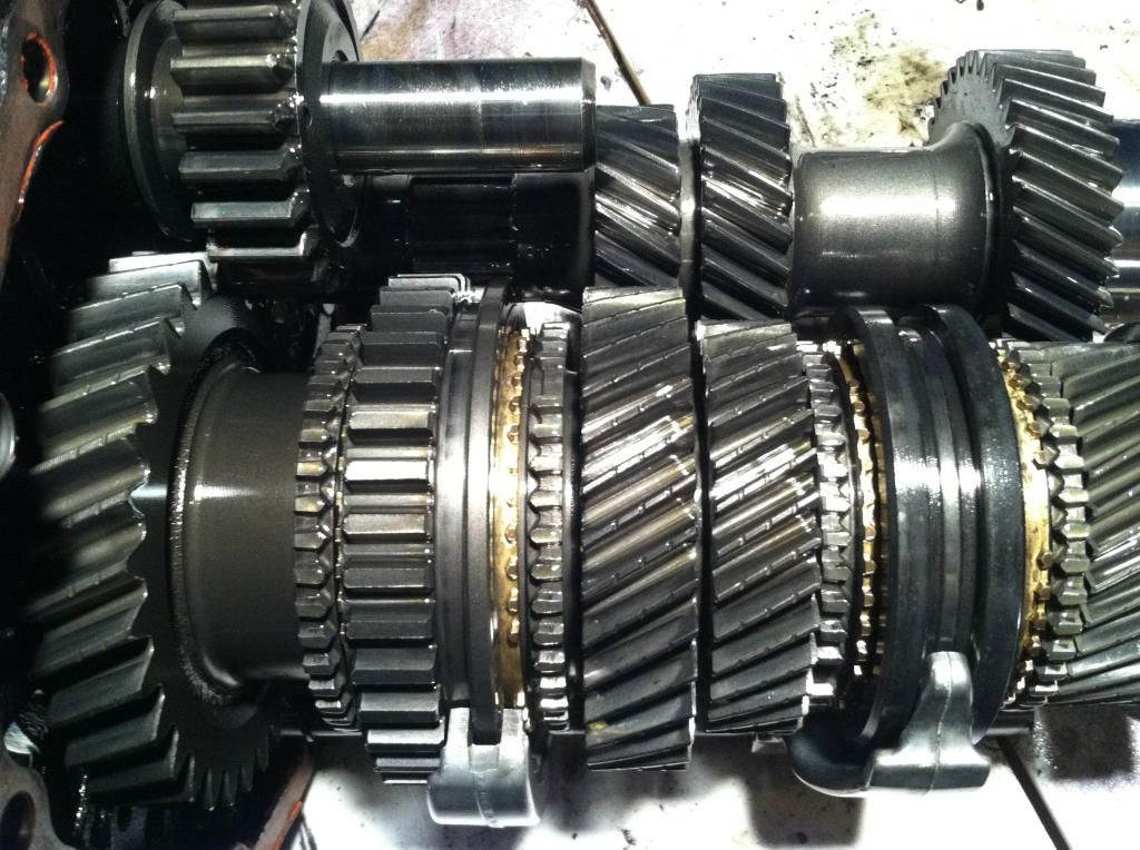

Pulled apart the trans Jordan had in the car before he put mine in. No signs of catastrophic damage, it's rebuildable.

The pics just tell us that he didnt strip gears lol. You have to start disassembling to get to the thrust washer. Did the forks look broken at all?
