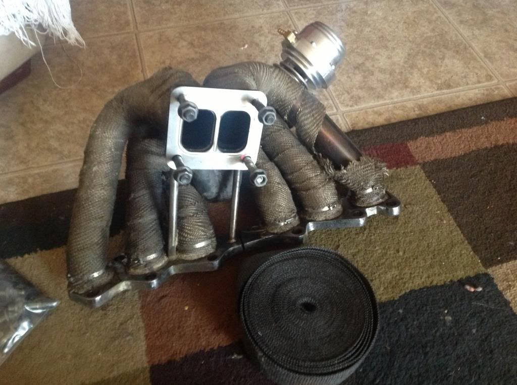

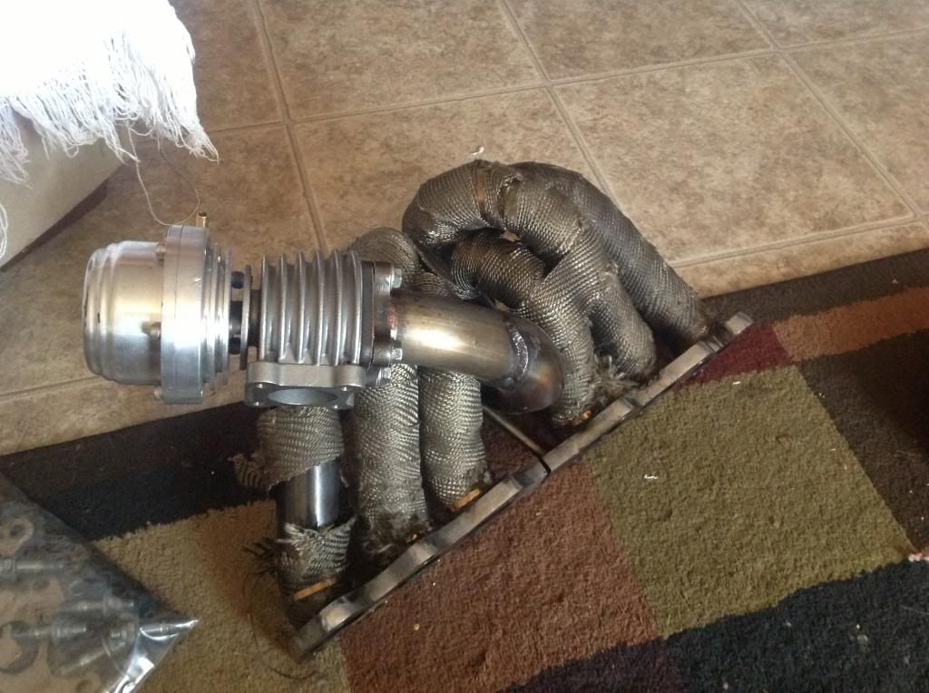

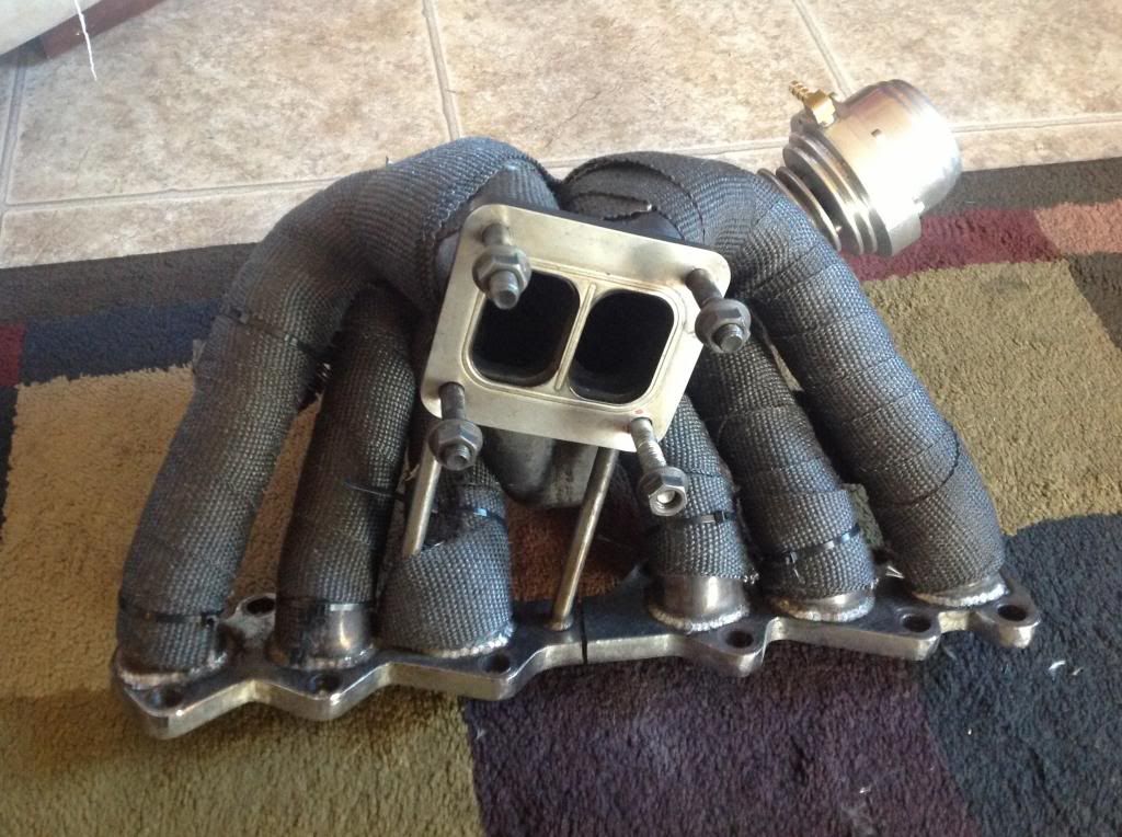

About to re wrap my exhaust manifold here's some before pictures.

Albert;1894836 said:
Metal zipties?
Why not just get it ceramic coated?
I was thinking about it but. Don't want it to take a month to get it back. If I can find somewhere to do it and have it back to me in time then ill more then likely jump on it. How much does that normally run?
