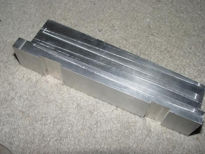

I need to finish making another trigger wheel before I sell this one.
I am also about 50% done with making my big brake kit caliper hangers.
Made from solid billet aluminum, I will take pictures of an almost finished one and post it tonight.
And I will NOT be making any for anybody regardless of what you will pay so don't waste your time asking me to make you one.

It is a start anyway, tomorrow I will finish both sides and this weekend I will be trying anodizing for my first time.

IJ.;1432772 said:
Going to HeliCoil the bolt holes Sean?
I planned on annodizing the block to give me a harder surface for grabbing. I also used a coarse tap to give it some good bite, and will be using industrial strength lock tite.
It is not all set in stone so changes can (and likely will) be make.
gaboonviper85
Jan 13, 2008
3,236
Northeast Philly
Anodize doesn't make material stronger just makes it more wear/abrasion resistant....fine thread is generally stronger within reason funky:-(....locktite won't stop threads from deforming.
You really should coil them...it's not too late.
