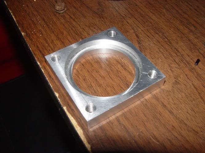

Got the base of my pressure relief piece machined out today, picking up some more materials tomorrow to make my BBK adapters, and the top piece of my relief.
Will try to get pics up soon.

That is the base to my pressure relief, I am machining out the plug for it tomorrow. Then I will do some setup and pressure testing with different springs. I want blowoff at about 45psi.

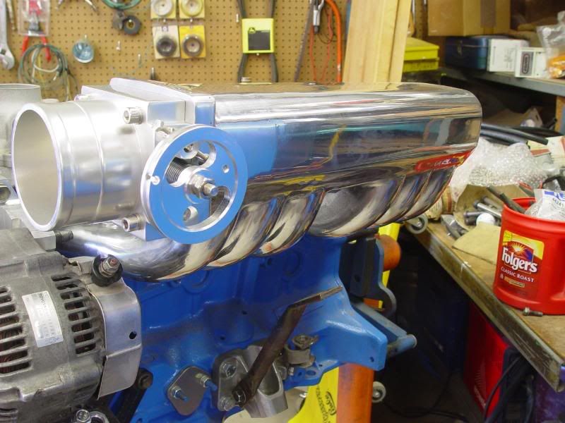

Not too much for progress, but I did finish machining out the hub centric rings for my BBK I am working on.
And it sounds like I will be running a LIPP intake manifold.
Not going to lie I like that idea.
I might also end up selling my turbo setup along with the 4" exhaust system if anyone is interested.
Also looks like I will be dyno tuning my car on raven works dyno in maple grove in december. Easily the most impressive shop in the midwest.
