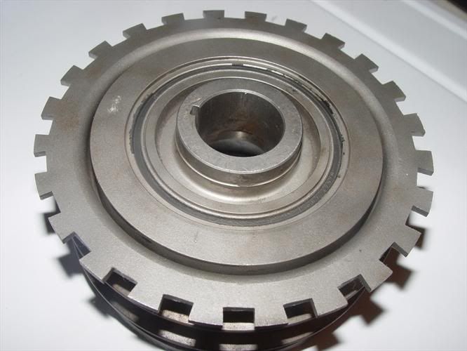

Well I kicked the crank trigger adapter and ended up using the rotary table and machined a trigger wheel on the backside of the pulley so if anyone wants the adapter let me know.
