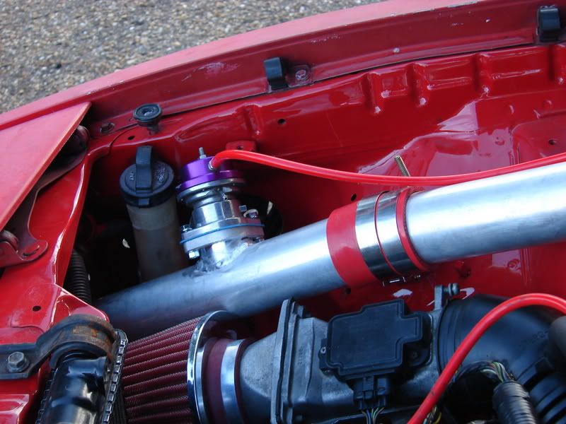

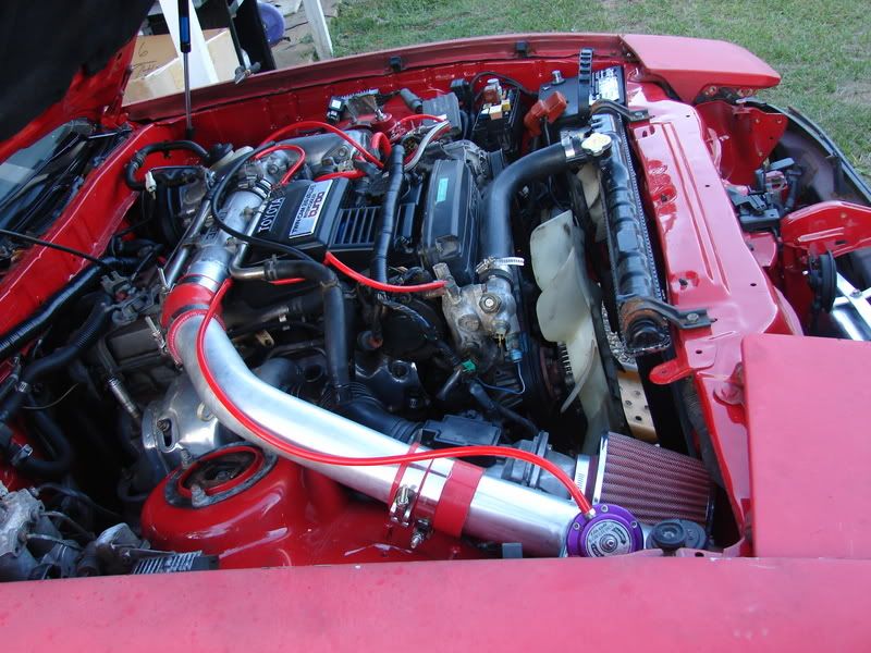

OK.......OK...........I finally got my Upper IC back with the BOV Flange welded on. Ans as soon as I got it home, I took a picture of it almost installed. Then I came in the house to see in my e-mail that my piping will be changinging again tomorrow! Hell YES! That means my HKS 3000 will be here tomorrow. But for you picture hounds, here's what it looks like right now. Still a few things to be sorted out, but it's almost done (Reign Style).

Loving it Scott!!! I am very impressed you have done a great job my friend...:bowdown: :bowdown: :bowdown:
