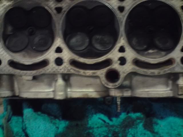

Soooo...
This is what I get for being an optimist:
:cry::cry::cry::cry::cry::cry::cry::cry::cry::cry:

doesnt look to bad.....clean old gasket off check for warpage and if it requires welding up and bobs your uncle..............or swap in sams engine :evil2::naughty::biglaugh::sarcasm::aigo:

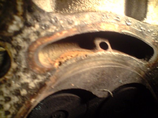

Considering the aim is to have the car running in 7 days, I'm very hesitant to just mask up a potentially large problem.
I firstly would like to know what causes that to happen to the water jackets?
Secondly, any of the Aussies lurking in here, how much would it cost to weld it all up, and is it a permanent fix, or is a temporary one?

Looks fine.
If you look, you can see the marks from where the gasket was pushed out towards the water jacket, that spot is from the headgasket leaking and will probably clean up fine with a resurfacing.
