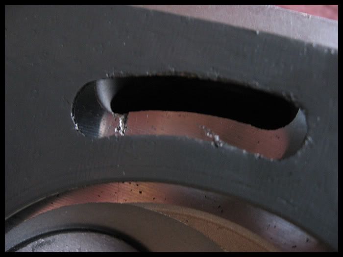

When I was doing my 6MGE build, my ex gave me the cylinder head from his turbo car, that had been sitting for awhile. Apparently corrosion had to it pretty badly, but we couldn't see it until the head was cleaned and milled already.
I was VERY sketchy when I saw it come back looking like this:
Definitely didn't want to BHG, so I took it back the machine shop and bitched...
They drilled a hole near the water jacket, and punched an aluminum peg in it and then sanded it smooth.
See discoloration on the left side of head...
Has held up fine (I BHGd anyway but it wasnt in that cylinder, lmfao)
I would gather that would be the cheapest solution, I am unsure as to how it would up to boost though.
