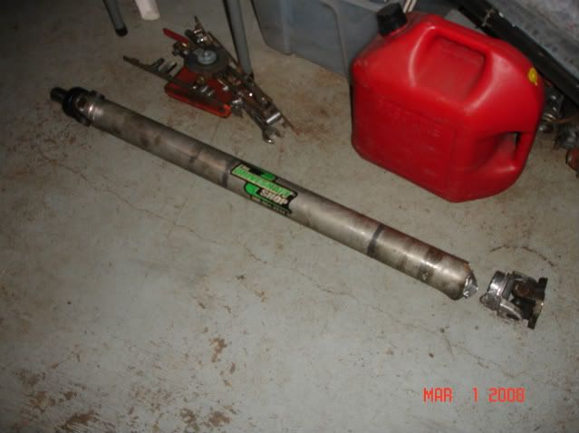

^ Doesn't take much.
Think of the dotted lines in toilet paper or a glass cutter, the cable wears a fail point you apply power and it snaps at that point.
This is another reason I'm NOT keen on Aluminium DS's as they're very easily marked giving them a stress riser.
