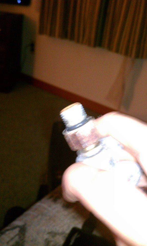

Yea I got that part down, some fuel spat out from the regulator like blow off valve while I was cranking it a friend of mine said I should have teflon tape on it, so I am doing that now.

Yea I have those on there I think the problem is it's not on there tight enough, the washer and O ring looks fine maybe a bit old but they should work because when I had the BHG it wasn't spraying gas everywhere, then again would the BHG relieve some fuel pressure from the fuel rail?

Think about what u just said lol
See when the o ring is compressed for many years and you loosen it up it stays in that form
So when u reinstalled it...now its not making a seal bc its already been compressed
But the copper washer should keep it from leaking as well
I would replace o ring

Yea I was thinking the same thing after I put everything up lol. Where can I get a new O ring? Like Ace Hardware or auto parts stores?
Yup, seems like autozone has a bunch of O rings for fuel pressure regulators.
