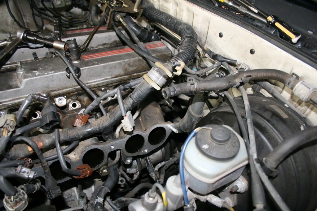

There is 1 plug I can't figure out where it connects to, it sticks out between the idle control valve and throttle body, black rectangle plug.
It's the black plug at the bottom left to the left of the brown injector plug in this picture, I know the other rectangle black plug connects to the idle control valve but I can't figure out where this one goes.
Doat
Feb 6, 2012
2,599
Houston, TX
That bigger plug above the one I am talking about connects to the idle control valve that smaller plug can't fit in it it's too small. I'll check it out and feel around and try to find it and I also need to find out where the vacuum and oil leak are, I am thinking a vac line just popped out because the new ones I used are kind of loose on some hard lines that they connect to.

I appreciate it, it's frustrating to be at this point and cannot figure out where 1 plug goes that could fix my throttle response issue lol.

That larger rectangle connector does go to the throttle body, the white connector goes to the idle control valve. I am still looking at the TSRM to find out where that smaller black connector goes.

the oil wasn't expensive at all actually lol. Cold start injector eh.
Well son of a bitch it is for the cold start injector just looked it up in the TSRM lol. but I don't really see where it is exactly, don't tell me it's underneath the intake manifold.

yea the injector itself is on the underside of the air intake chamber (AKA upper intake manifold). the injector inserts right in the middle. i found it easy to install the injector first and then attach the banjo bolt to it after mounting the upper intake manifold on the runners.

Is it the picture on page FI-81 in the EFI system > fuel pressure regulator section? Step 3. Disconnect No.2 fuel pipe is that where it connects on the right side of that picture?
