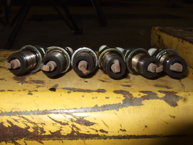

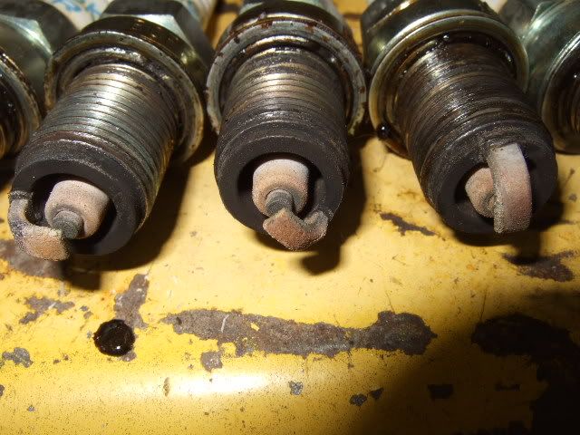

So for quite a while my car has had a little bit of smoke when I boost hard, normal for a ct with some miles on it. Recently it has started smoking at idle, and now does it most of the time. Its defensively blue-gray oil smoke. So I figured turbo seals are gone, or worst case valve seals are going. I was doubting valve seals a bit as the motor only has about 20K on it but then again its original so the seals and all are 21 years old.
So....

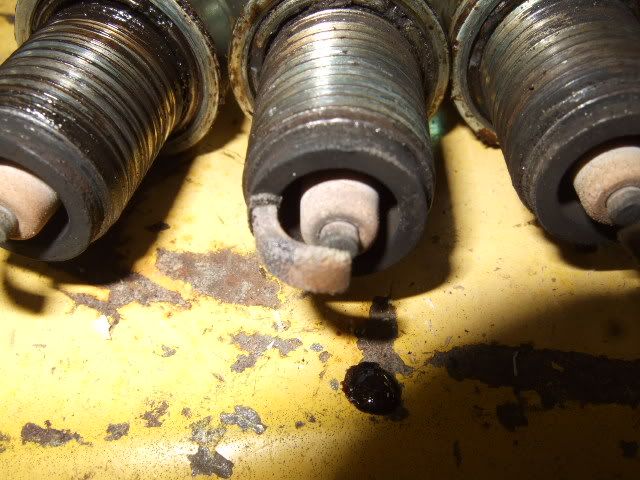

Pulled the plugs, tiny bit of build up but they are a nice tan color so doesnt look like valve seals.

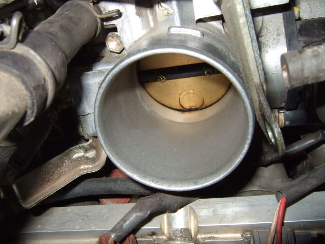

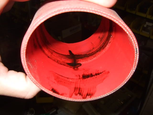

Throttle body and piping are also spotless so its not the cold side seals pushing oil all the way through either
There was a bit of oil in the intake coupler pre turbo but not much, and none in the rest of the pipe

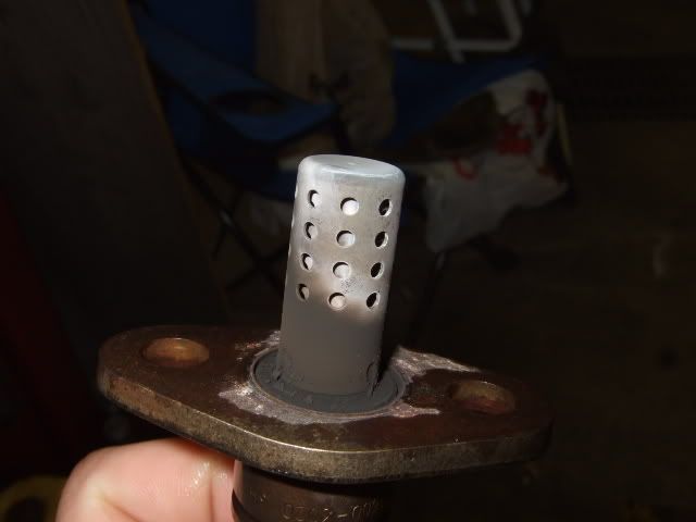

So I figured I will pull the o2 sensor and that should tell me if the turbo is dumping oil in the exhaust.
Wrong not even all black
So I am at a loss on what to check next. I still suspect its the turbo seals and have another turbo in the works but wasnt planning on working that out for a while. Any ideas on what else to check or what it could be?

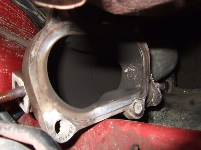

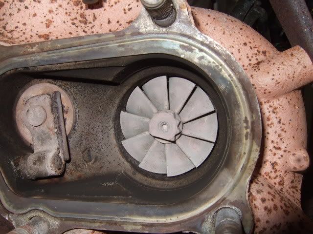

So I decided to pull the DP and elbow and take a look,
Elbow shows normal dry build up
And the turbine and housing show very little at all and are actually a nice light tan color.
So I cant find any evidence of oil in the exhaust and am at a total loss. Any ideas at all guys???

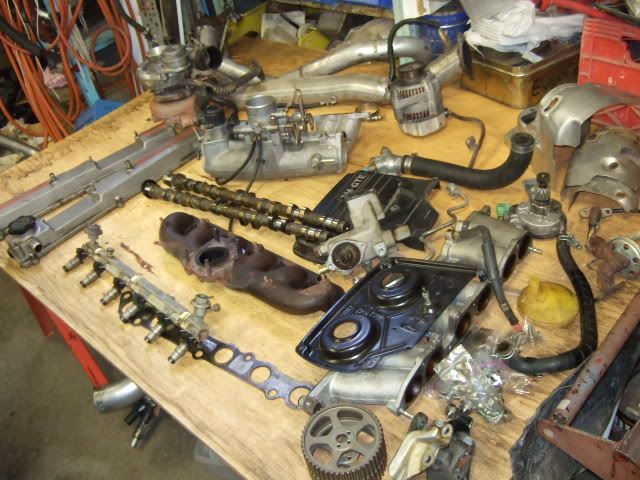

Pulled the head yesterday, you know you have done this too many times when it only takes a couple of hours. Well its definitely not good, more info and pics once I figure out what I'm going to do

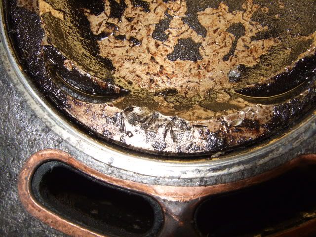

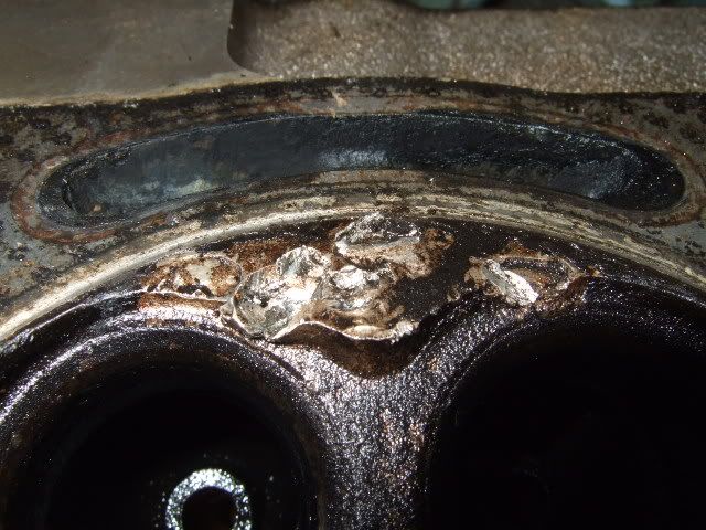

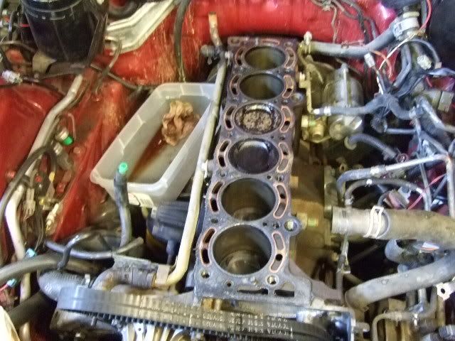

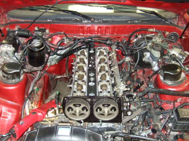

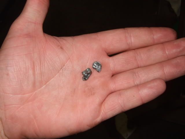

so anyways long story short, turns out something very very small was sitting in the plug galley just waiting to jump into my engine. I pulled the plugs it silently fell in, put it back together went to start it, obviously made a hellatious racket and I proceded to pull everything off and do a comp test. 4 came back low so off with the head!!!
After a few hours of disassembly
We get here
Heres the carnage.
Piston held up well, Im impressed.
Head not as well
and the culprit!

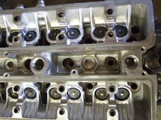

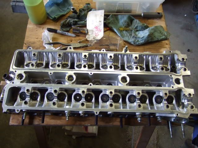

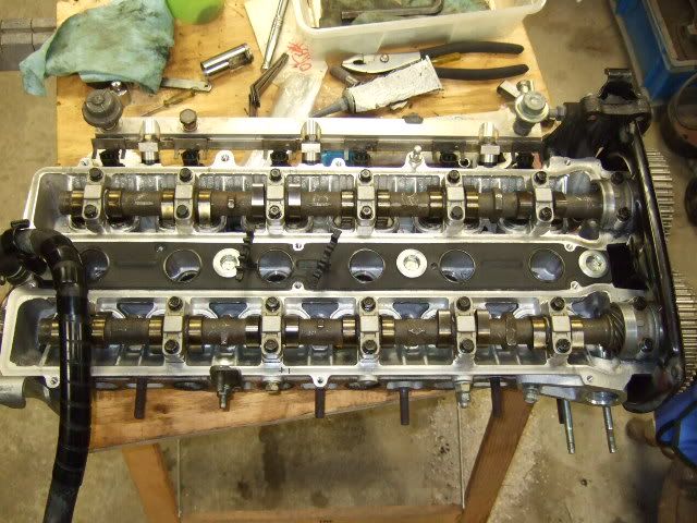

Heres the head fresh from the machine shop, you can see how clean it is with only 20k on it which makes this incident suck that much more.
And all back together with all shims checked and the two cut seats re-shimed.

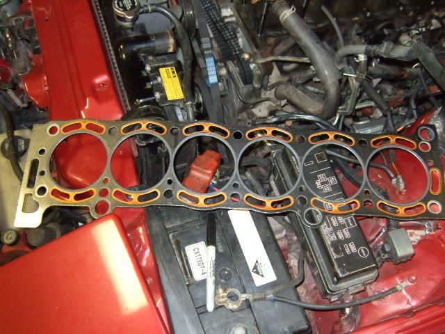

Head gasket ready to go in
and all back in and torqued down, with ARP studs
Still have no idea where the nut came from, I'v never been missing one on anything so All I can figure is its been sitting in the galley for quite a while. So all in all a shity amount of very unnecessary work but what can you do. What really sucks is I was planning on working on my other motor this week but between taking up time and money it will have to wait awhile now:cry:
