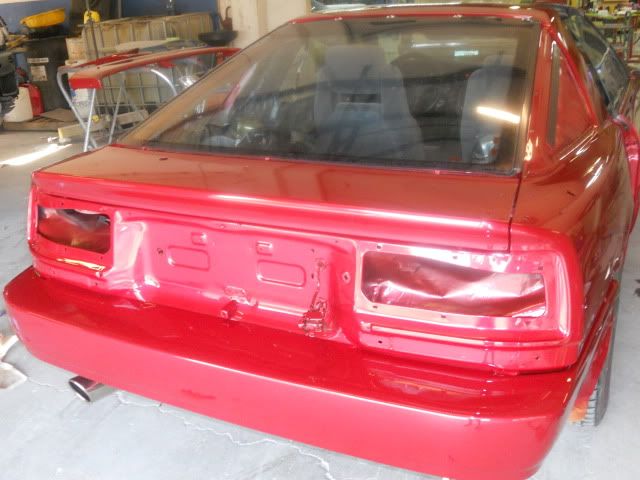

Ya it can be done without removing everything but if your going to put all the work in you might as well do it right. The original owner not having everything removed the first time is the reason I am doing this again now, and the project just keeps expanding. It started as me shooting and clearing all the silver areas, then I decided to base all those areas out and have the whole car cleared, then I decided to work on a few dings and blemishes, and finally we decided it was best to shoot the whole car because the risk for blending lines were just too high.
Ken, me and my dad would have shot it completely ourselves but work schedule up till I go back to school gives me no days off and my buddies at the shop offered to shoot it for a few six packs more than having me do it in their booth. Im comfortable with painting but I know they can do it faster and better than me anyways. Did you come to a conclusion on your wheels dilemma???
Oh and by the way its done and in the garage curing Im just behind on pics, working on getting some up now.

The most recent set of pictures (after paint) I have are on my wifes camera so I will have to wait and put those up later.

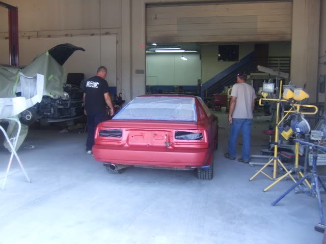

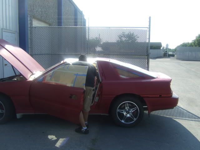

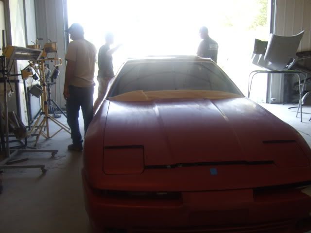

Me and my dad taping the car off outside the shop
Taping inside the hatch wasnt the most enjoyable thing I have ever done!
all done
My dad Kicking my ass for suckering 3 days of labor out of him, with no overtime pay.....or any pay for that matter lol
The car sitting in the shop to cool overnight before going into the booth in the morning

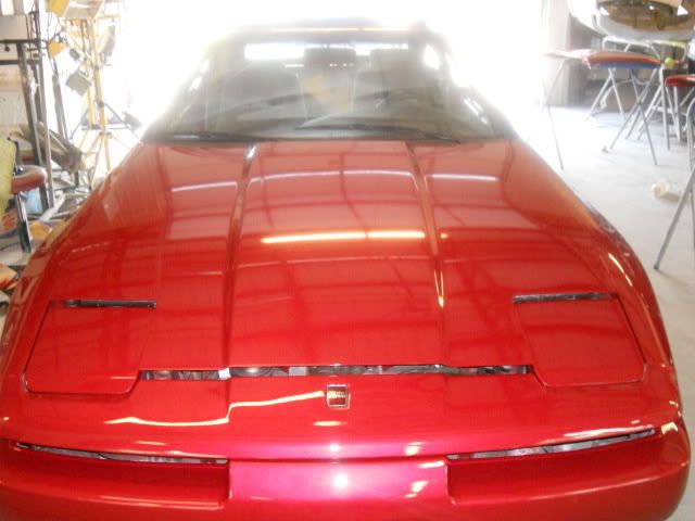

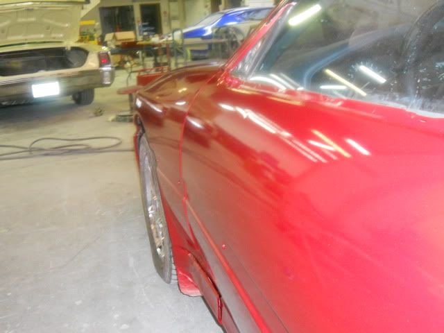

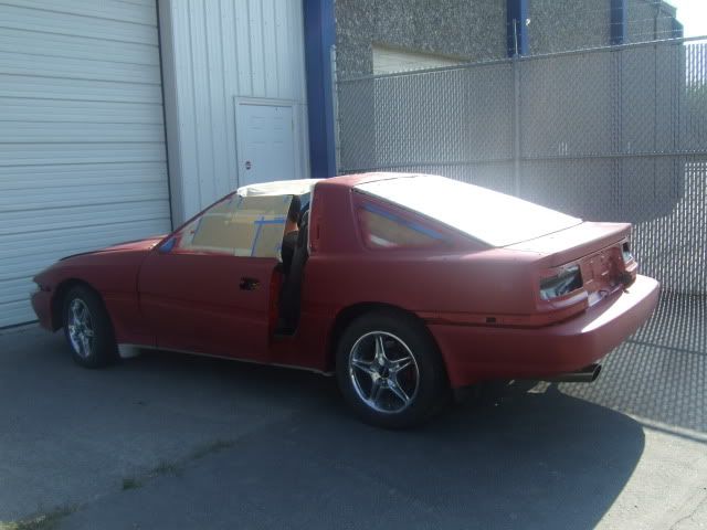

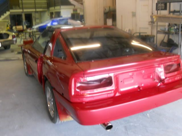

Ok I finally got the pictures off my wifes camera
The lighting and flash makes the color look incredibly bright. Its actually slightly darker than it was before
and with a little heavier metalic. The pictures also look like they make the cae have a pink tone to it which
is also not the case.
So here it is the day after being shot and baked in the oven over night.
This one looks the closest to the actual color in person but still looks light and has a sort of pink hue.
Ill get more pics up when I can. Work the next few days will keep me from running over and working on anything on the car.
Im going to let it sit and cure for a good week before I give it a cut and buff. Im also heading back down to school in just
over a week so hopefully I can still get it back together at a decent pace.

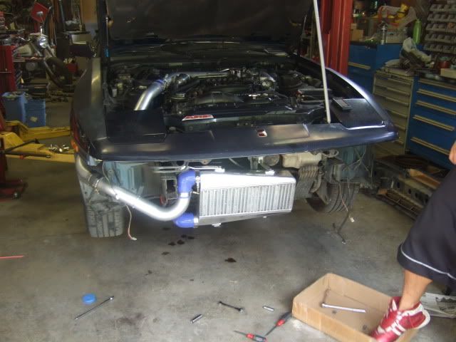

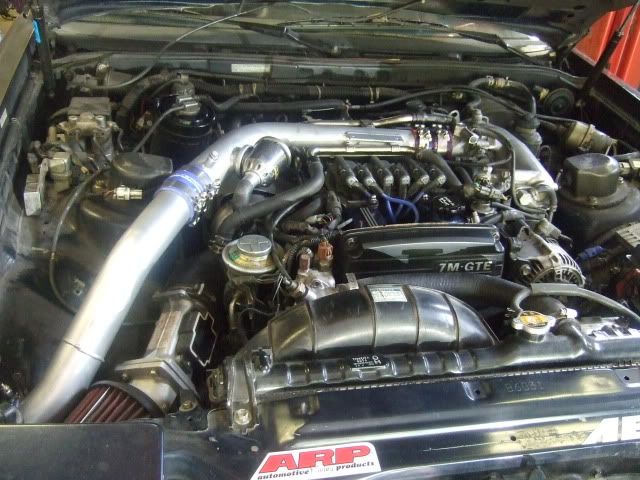

did some work on A supra today... not mine though
Me and my bro finally decided to fab up the missing sections of his piping today and install his 3" intercooler. He has been running half of a lipp IC pipe set for quite a while. He had the 3000 pipe replacement and the turbo to IC pipe but the rest was a jumble of stock and aircraft ducting lol.
I'd say it came out pretty good for a quick project before I headed to work

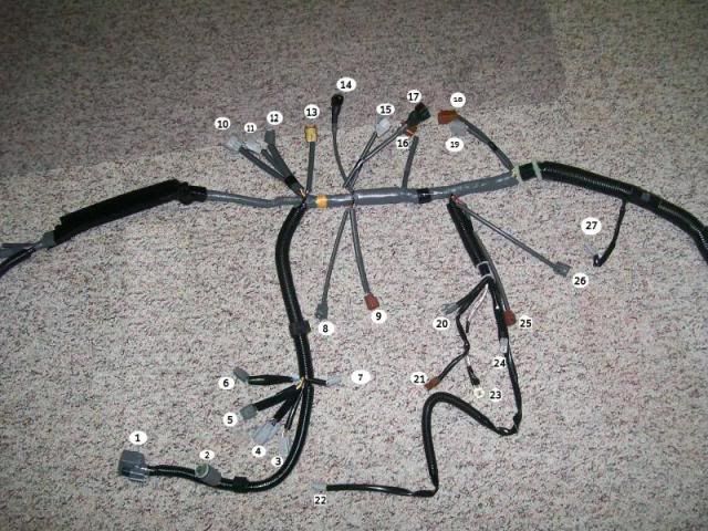

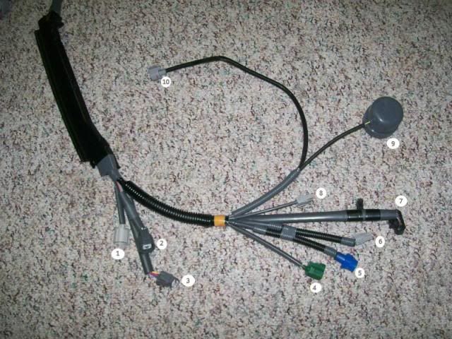

I have also been gathering info on the wiring harness and sensors in preparation for building a new one this winter. I have wanted to build a new harness with mil-spec connectors at the firewall for easy engine removal, remove what I can and that incorporates the maft pro harness. Here are my thoughts, looking for some input
Red = I think it COULD be removed, not yet sure what sure should be yet
Blue = comments
this list corresponds to these pics put up by 92teal
HOT SIDE
1. Cold Start Injector Plug---Remove with FFIM need input from those running them?
2. O2 Sensor Plug
3. Cam Position Sensor Plug
4. ECU Coolant Sensor Plug
5. Radiator Cooling Fan Sensor Switch Plug-- makes contact >234 off <225
6. A/C Coolant Sensor Switch Plug-----What does it do, condenser fan? on >212 off <203
7. (Air Flow Meter Plug)------Remove
8. Instrument Cluster Coolant Temp Gauge Plug
9. Oil Pressure Plug
10. From headlight relay, it has been Unknown, but I found it, but I don't see where it plugs in.
COLD SIDE
1. Check Connector
2. Ignition Resistor Plug
3. Resistor Plug on body ( Rectangle shape )
4. C1 Plug located next to the fuse box
5. Igniter Plug
6. Igniter Plug
7. Progressive Power Steering Plug
8. #1 Knock Sensor Plug
9. #1 VSV---Opens briefely at hot start to increase fuel pressure (Is this needed with FFIM)
10. Idle Air control Plug
11. Fuel Injector #1 Plug
12. Coil Plug
13. Fuel Injector #2 Plug
14. Cold Start Injector Plug-----Remove with FFIM?
15. Fuel Injector #3 Plug
16. Fuel Injector #4 Plug
17. Throttle Position Sensor Plug
18. Fuel Injector #6 Plug
19. Fuel Injector # 5 Plug
20. (Blank)-------Remove
21. Start Solenoid Plug
22. Manual Transmission Reverse Light Plug
23. Ground under Intake Manifold
24. ABS Plug for Manual Tranmission
25. #2 VSV------- EGR, controls when the egr opens and recirculates combustion gasses(to remove egr or not to hmmm)
26.#2 Knock Sensor Plug
27. Horn Plug
my main questions are;
1. Whether most run the cold start injector with an FFIM?
2. I have a JDM ecu so I could ditch the egr but is it worth the slight temp increase in cylinder 6, Im on the fence.
3. Is the AC temp switch for the condenser fan? do they even have them on 89+? Mine never has
4. If the AC switch is even needed, could it and aux fan temp switches be tied together so the fans kick on at a lower temp?
5. does anyone with an FFIM and AFPR run the fuel pump vsv?
Thanks for the compliments guys, Ill try to get more pics up in natural light before I go back
