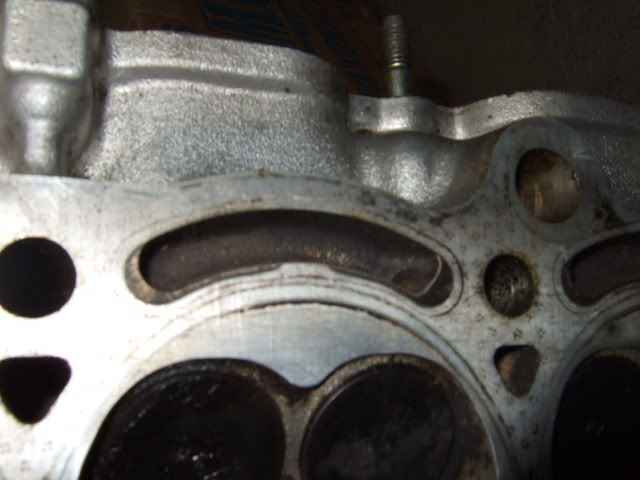

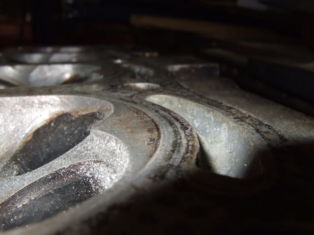

Picked up a new head since mine fell casualty to electrolysis around the water jackets. It has quite a few miles on it according to the previous owner but the gasket surface should clean up with only a few thou and the jackets are perfect. For the price and how long I'v been looking for one locally I couldn't pass it up.

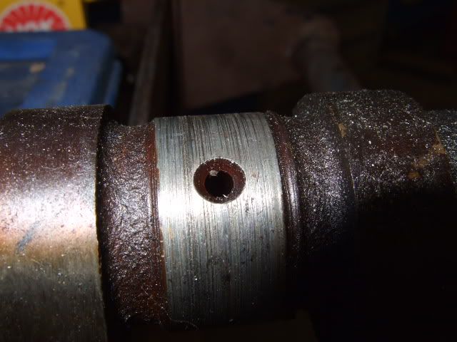

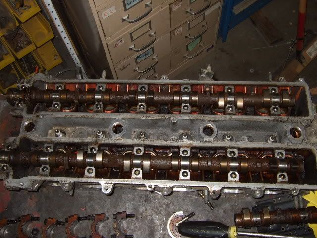

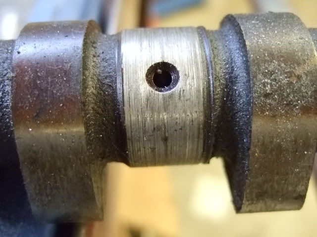

I pulled the valve covers and cams today, found the usual. Scoring on the cams and caps. The journals on the head are perfectly smooth though. Im not all that happy with the way the cams look. Why is it the first journal behind the main always shows the most wear, it sees oil first????
I know in the pics it looks pretty normal but if you look at the edge profile you can see how deep the scoring is. Its worse than the others I have taken apart.
I think I will pull the cams off the other head tomorrow and see if they look any better.

where did all that dirt on the cam lobes come from? im assuming this thing sat without the covers on for a while.

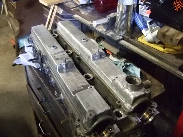

I think that is from me, I set the cams down on a dirty bench. I just finished smoothing out a set of valve covers so needless to say there was aluminum everywhere. I didn't get a chance to pull my other head apart and check the cams in it today like I hoped so....tomorrow.

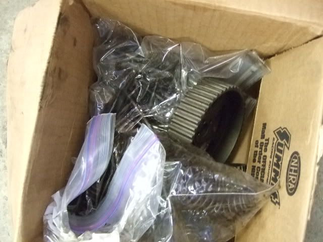

Today I got started on the head,

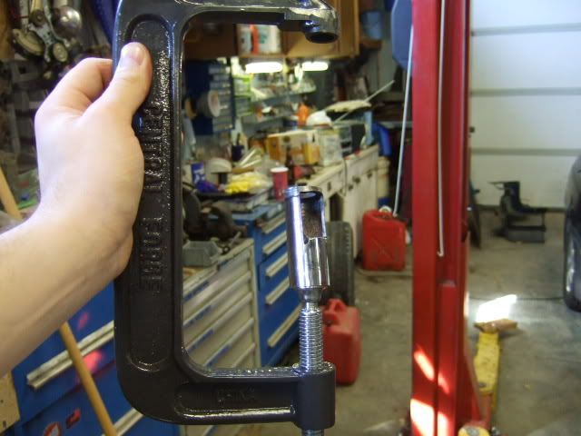

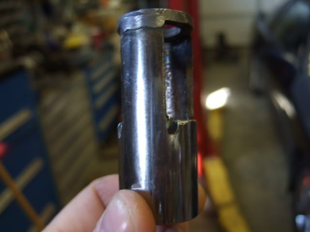

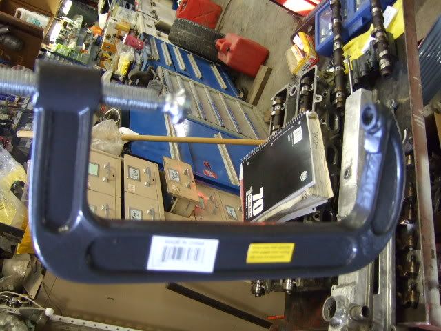

I did have a valve spring compressor that would work with our heads so.................. I made one. Started with a large C clamp, some chromed stainless tubing and a washer and ended up with this.
Worked pretty well, I think it took maybe 10 min to get the whole head disassembled once I got this finished.
I was weary of changing to a different set of caps, Thats one thing I usually try not to swap but the set from the other head show hardly any wear. Of course I plasti-gage the head with the better cams and caps. The main/ supply caps came back on the tight side while all the rest cam in within the normal limits. I think the largest clearance was around 28 thou. I think I will moly coat the journals so that should even bring the clearances down a tad more.

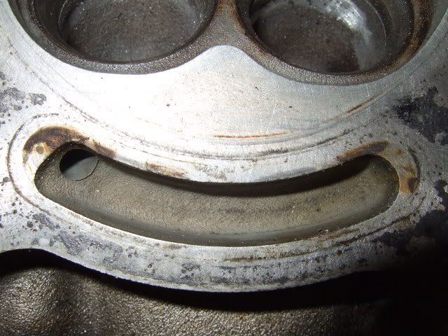

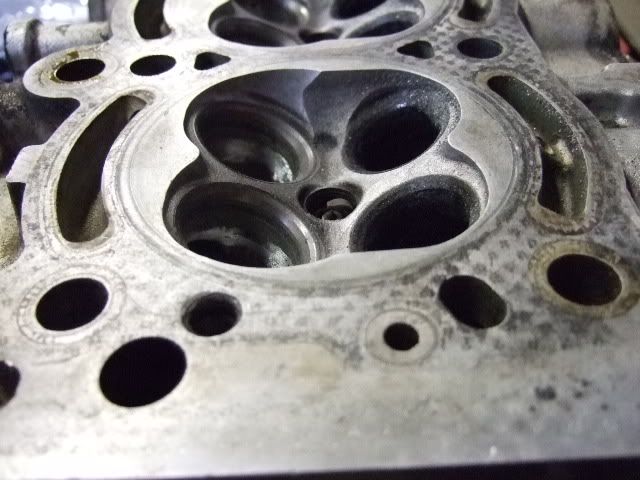

Heres what the jackets and surface of my new head look like.
This is the worst of the ring grooving. Looks worse in the photo due to the staining. I think 3 thou should be enough to clean it up so it really isn't much at all.

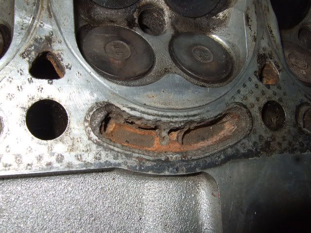

Heres a shot of the old head for comparison.
Pretty bad electrolysis going on as you can see. It only affected the exhaust side coolant jackets. It really sucks because the head surface isnt too bad at all, it has never been shaved, its not warped and I checked the hardness for the hell of it and it passed.
Here how good the intake side jackets look for comparison.

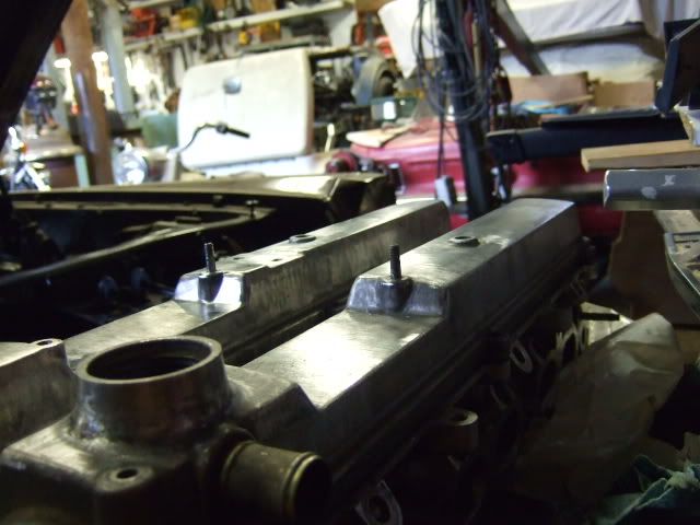

I love the valve covers! I've been wanting to do that from some time. I'll probably hit you up for some tips and what tools you used and such... ;)

Kenny, I think I will stick with this head, but I will let you know if that changes. It passed the harness test, is straight an although the surface looks bad (mostly because I havent cleaned it all since it will be surfaced) It will take <4Ks to clean it up. Plus It already has port work.
