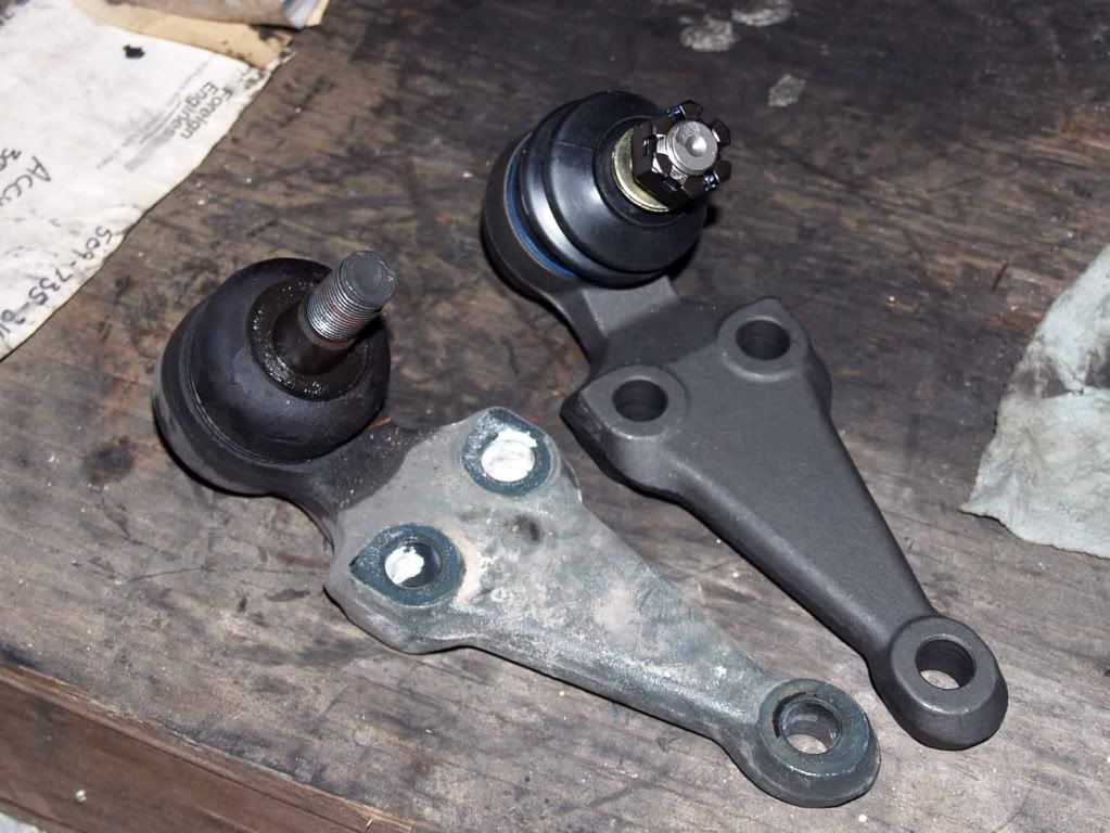

Here's a shot of the bad lower ball joint next to a new one. The boot on the old one wasn't torn; but, it was dry. As in no grease inside. Hence my occasional clunking noise.
I forgot to include the tools used to remove it; but, I used a can of WD40, Hammer, Pry Bar, and a Puller.
