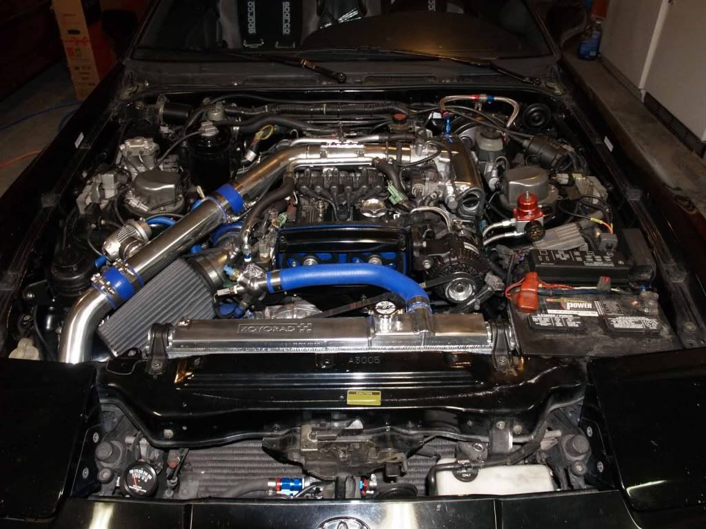

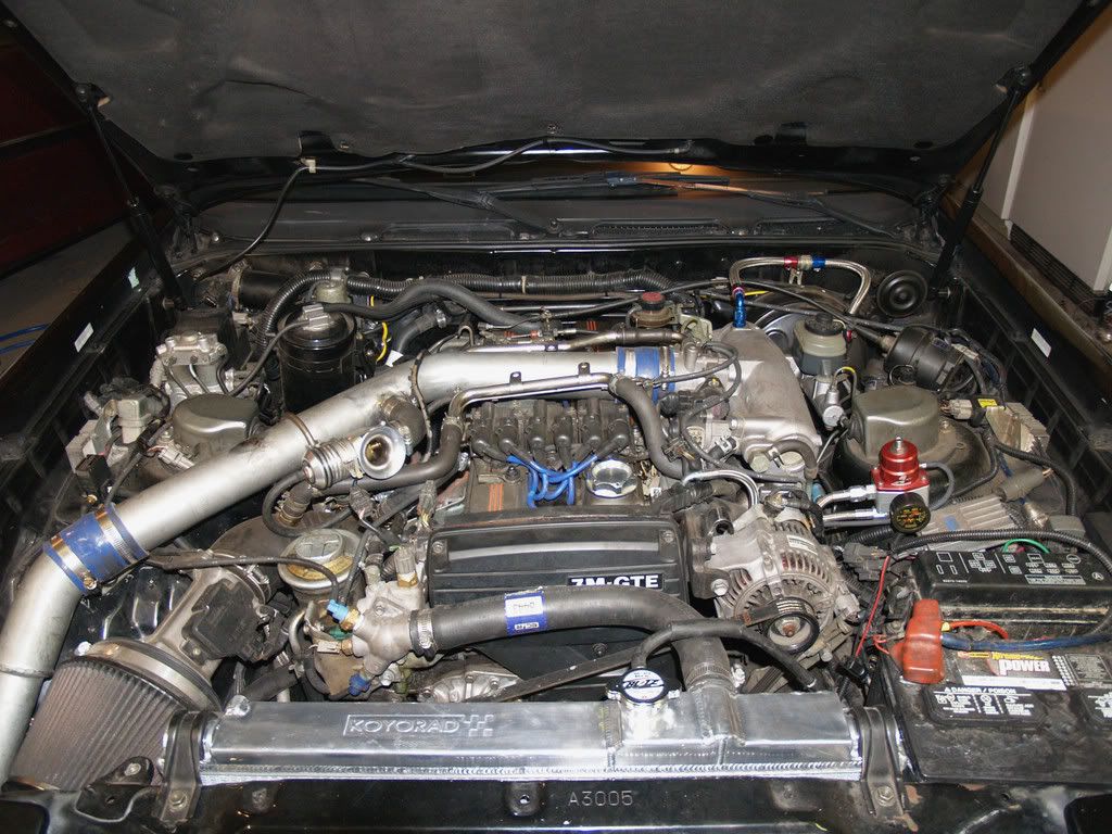

CajunKenny;1542378 said:I just thought I'd throw a before and after post.
Before:
After:
carter;1544740 said:How did you like the RLF? I don't think I could listen to that bov all the time.

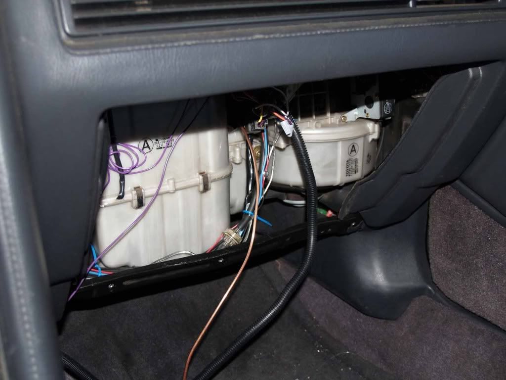

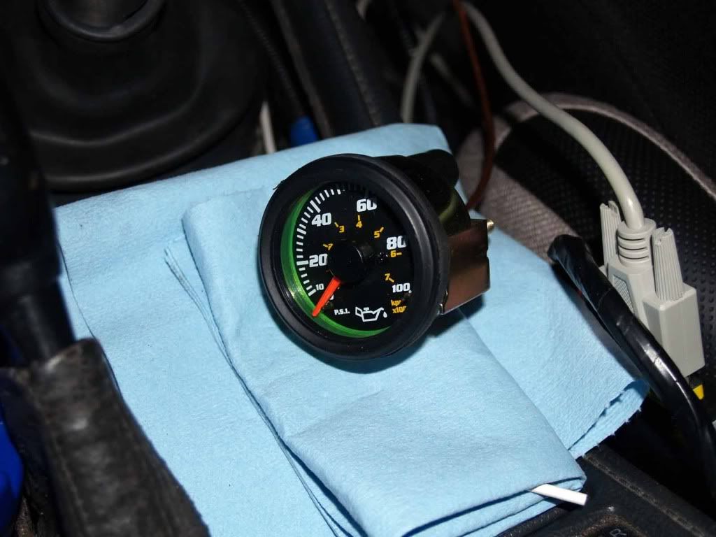

SupraRon;1550501 said:Cool Ken. Thanks for the pics. I wondered how easy the install would be using copper tubing. I know its rather flexible, but not as much as rubber. What thickness is the copper? I'm assuming the gauge box will be mounted in the glove box?

Sawbladz;1550502 said:Installing the copper is a bit of a pain in the ass since you need some slack to be able to pull the gauge out to disconnect it. I ran mine to the stereo surround area and it turned out decent.
CajunKenny;1550789 said:As long as you think about the routing before you go at it, it isn't that bad. Care has to be taken not to kink it or bend it back and forth because it will break. The only thing I wish I would've done differently was slide some vac line over the tubing so it won't rub/scratch/rattle on anything. I'm probably still going to do that.
The brand of the tubing is 'Sunpro'. Which is owned by 'Snap-On'. I don't know what the thickness of the copper tubing is. Whatever it is, its the common size for gauges...
The glove box is my second choice. I have an idea that I'm working on; but, if I don't like that, then yep....in the glove box they go.
That's where my buddy put his too.
Yeah, the copper tubing is a little more of a pain than the plastic stuff; but, VERY worth the hassle!![]()
