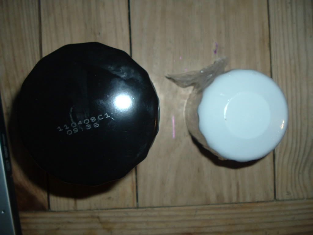

CajunKenny;1522436 said:
I haven't decided on the filter size yet; but, I was thinking along the lines of a PH8A. That may be too big; but, I want to fit the biggest one I can in there.
What about you?
WIX 51515 (Motorcraft FL1A), IIRC it is off some thing like a 460 ford engine. It should be large enough, :rofl: Look at post 506 on my build thread for specs on it.

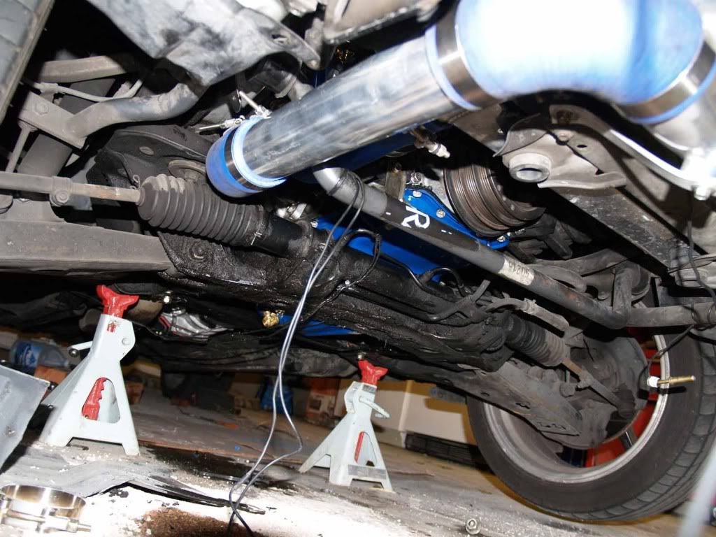

Well, once again the "Parcel Service Gods" decided to smile on me last week. My MK4 COP's showed up along with an AEM Dry Flow Filter, and an S3 Shifter! I'm liking that... :)

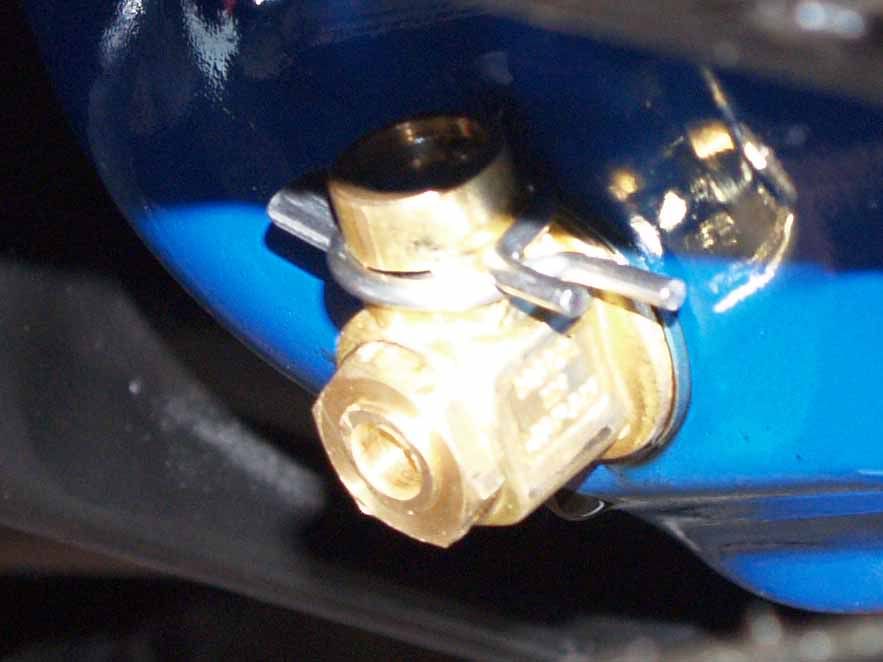

So, I decided to cut the hose barb off of my Fumoto valve. It was hanging a little too low for my liking.
Then I was able to finish up the lower IC Pipe run. I had to add a 45* coupler to make it work.

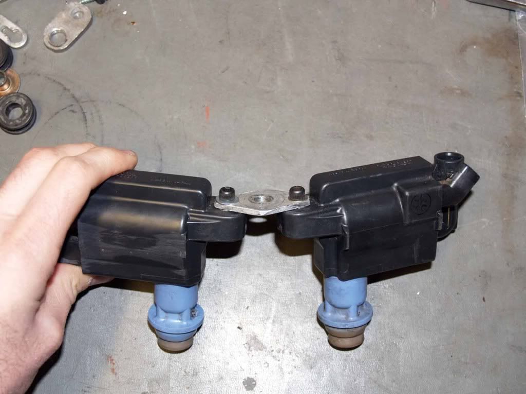

Here's test fitting the new coils. I'll have detailed pics of this process later. This is NOT a plug and play thing.

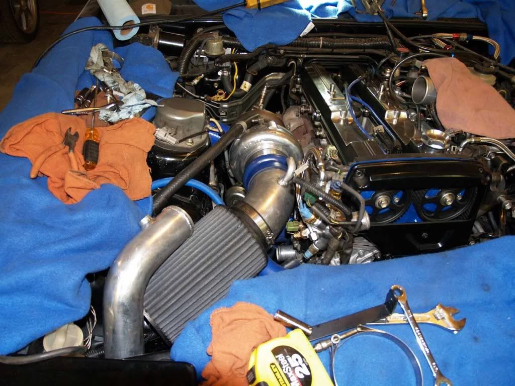

And here's test fitting the intake pipe and new AEM Dry Flow. I can see why guys like to move to a FFIM when dealing with a 4" inlet turbo!

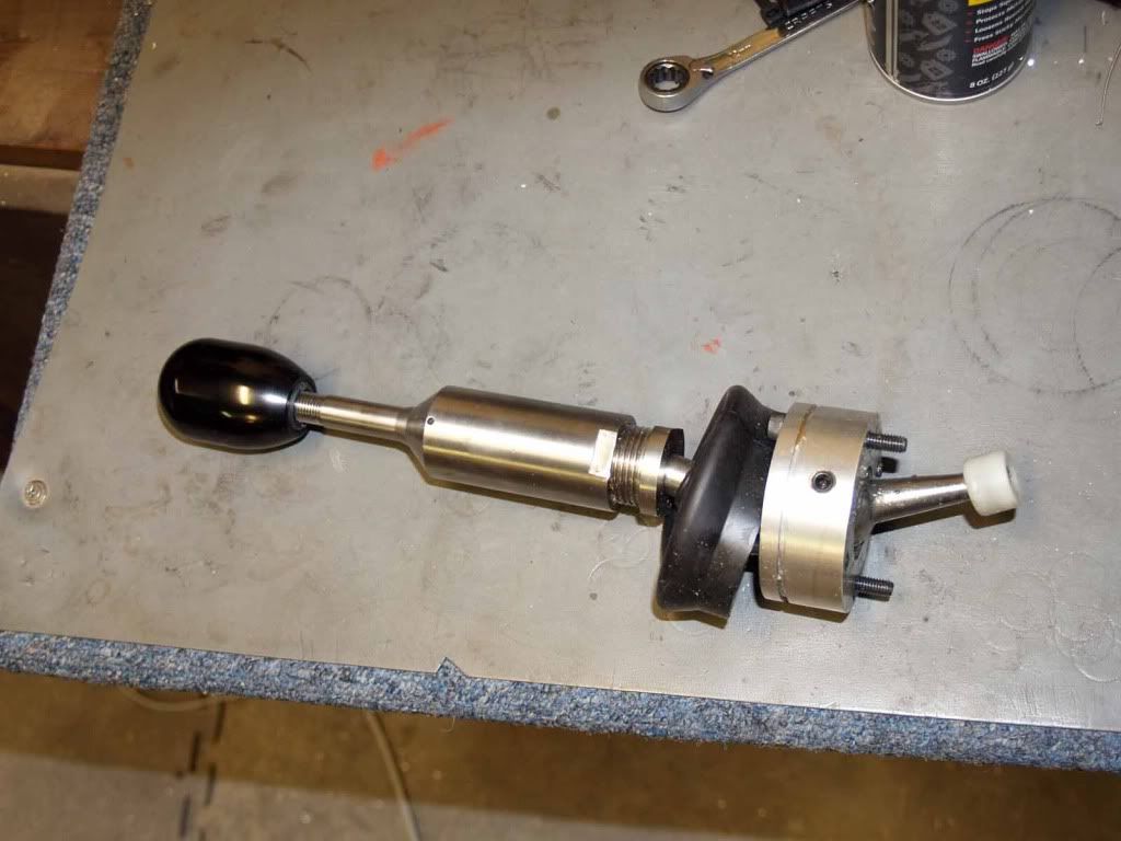

The S3 Short Shifter.(previously a C's ;))

CajunKenny;1526590 said:
......The C's Short Shifter. Yummy!
Errr, Not C's, but rather Supra Sport's V3. No doubt arguably the best short through shifter available.

SWD Fredester 3;1526835 said:
Looks good Kenny, everything is coming along nicely. I just replaced the SS V3 shifter with the one from Nash Man, I'll see what the difference is, hopefully soon.
Thanks Fred. One of the things I wanted in a shifter was for it to look stock. Or close to it... I want it to hold the factory shift boot like the stock shifter does. The NM shifter just doesn't do that to my liking. Otherwise, I would've gone with it.

I also have the S3 shifter, it is pretty sweet. I've compared it to Nashman's shifter, and Nash's shifter has an even shorter throw than the S3, which I assume would require a bit more force to shift. My S3 has developed a bit of play in it over time, but hasn't got any worse. I seem to remember it being 100% tight when new. Not too big a deal.

Yeah, with the Marlin Crawler Tranny, I figured it was time to upgrade the shifter too. The shorter the throw...the faster you go... :)

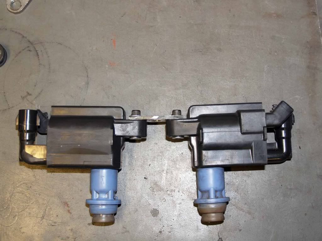

Here's the start of the COP Mod. (I will update this post as I go so it'll all be in one post. So check back here for progress...)

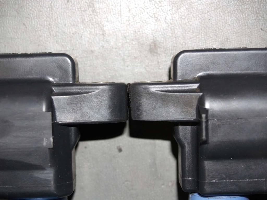

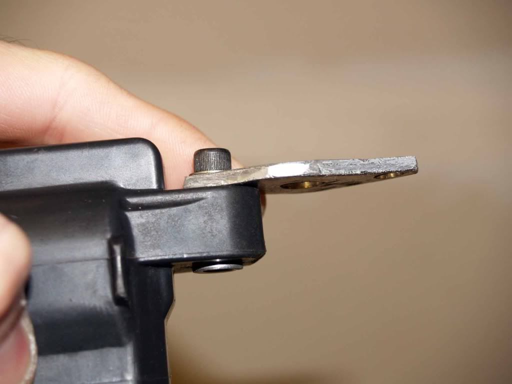

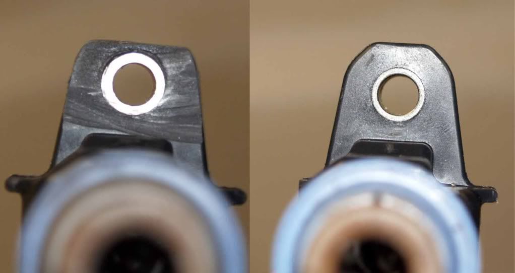

In order to get the 1-6 Coil to sit correctly you have to shave a bit off in two spots. It should look like this when you're done.

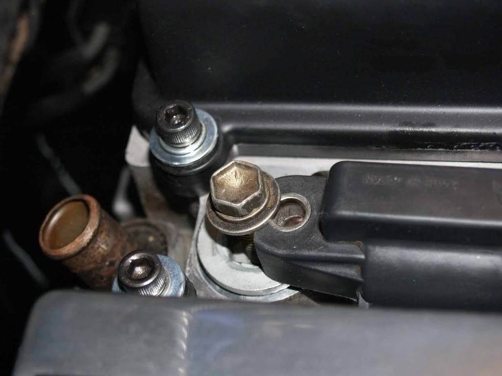

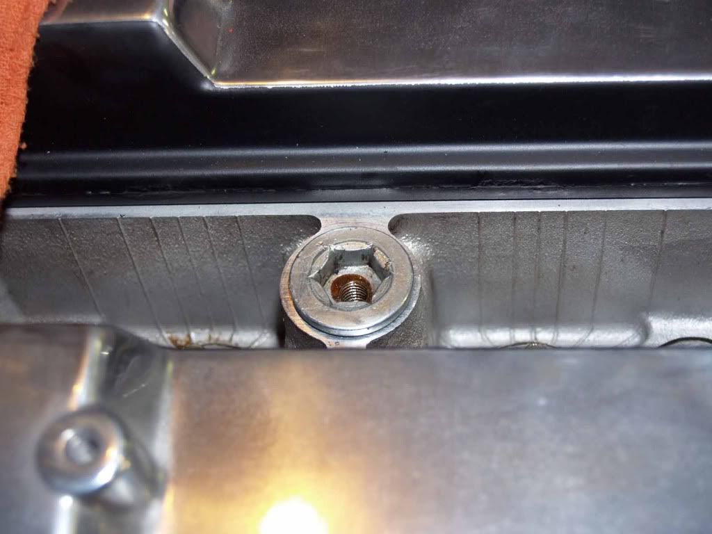

I then threaded a bolt in to the rear threaded oil galley plug.

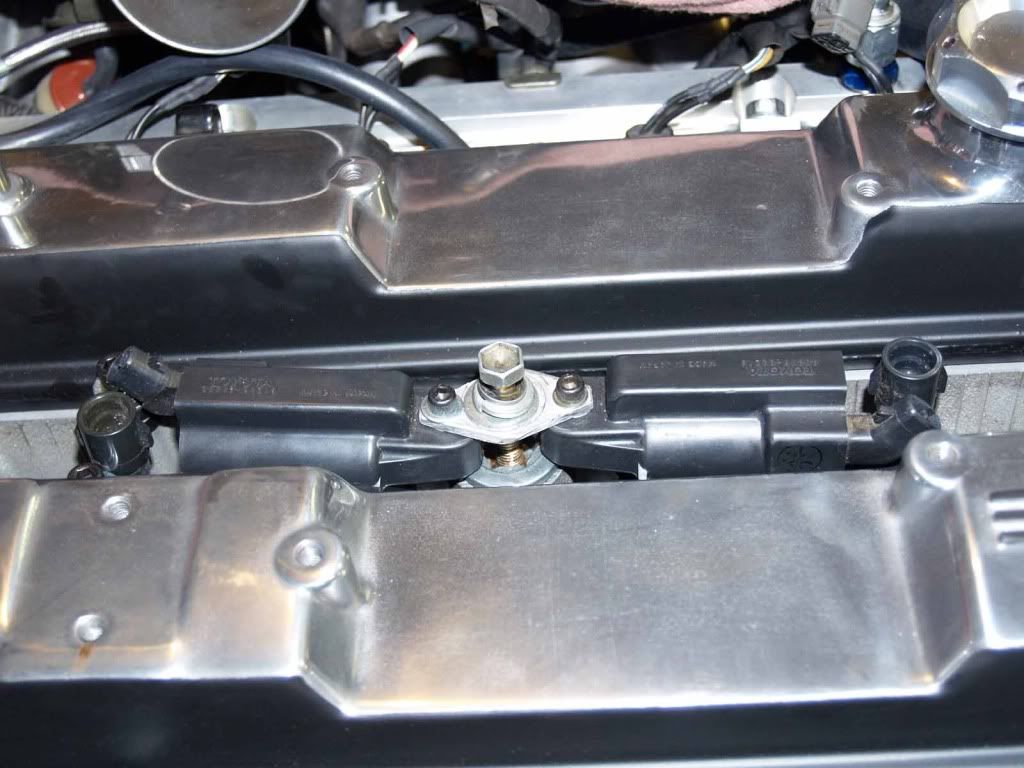

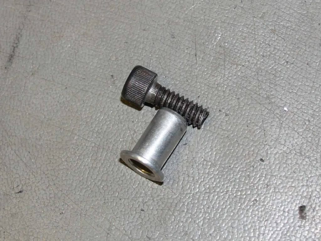

Next up are the screw and threaded shoulder used to secure the bracket for coils 2-5 and 3-4.
And a shot of the bracket. I made it out of 1/8" Aluminum Bar Stock. It's not the best; but, it doesn't matter because it'll all be covered by the cover I'll have made.
And a spare threaded plug to secure the other two coils
It's going to look something like this.

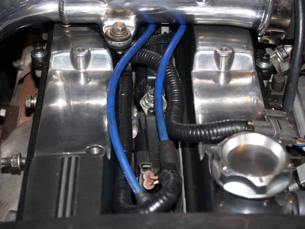

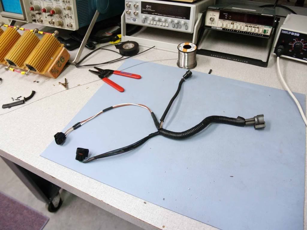

Here's the modified harness that came with my COP's. I am placing the coils differently than their previous owner so the harness is not long enough and had to be modified. I am out of wire loom so I couldn't finish up; but, I'll get some tomorrow. On to the harness...
Before:
After:

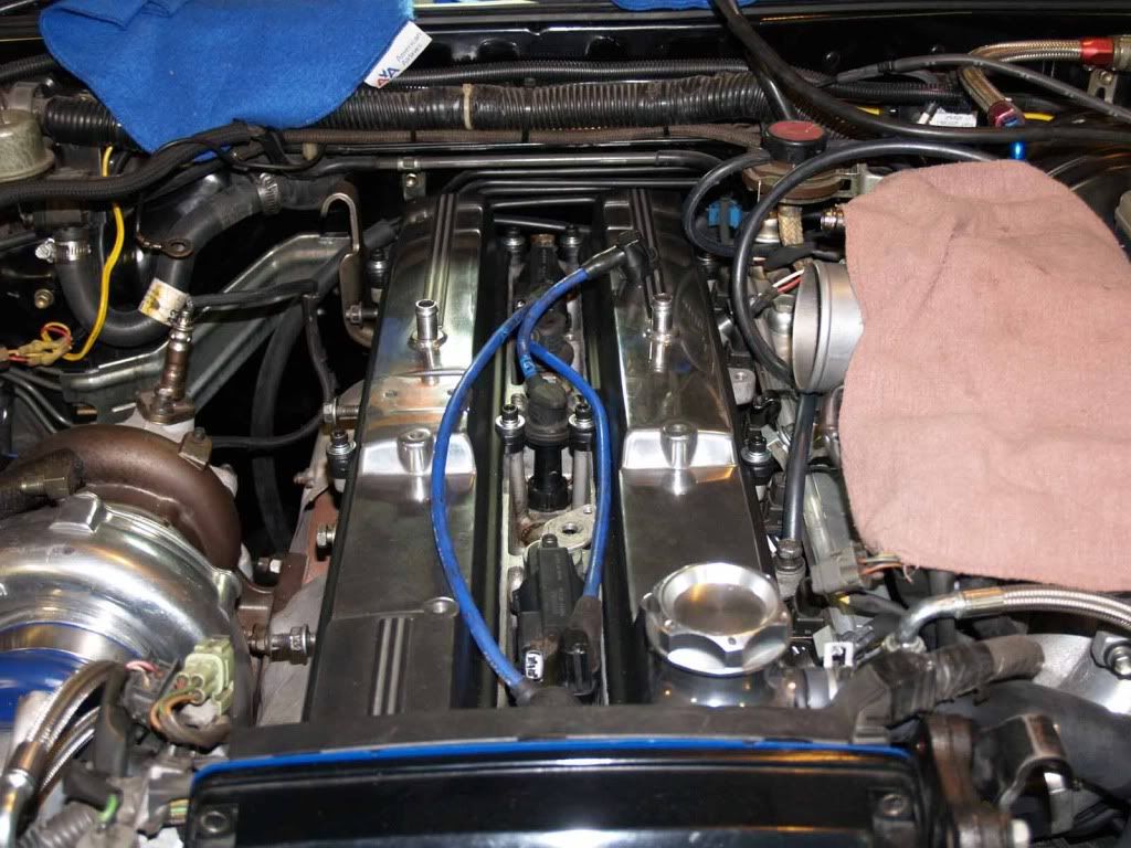

Ok. I got the harness all loomed up and installed. The coils all sit ~OK at best. I can't say that I'm happy with them at all; but, that could be just me being picky. We'll see how everything goes once it's running.
I skipped some pics because I was in a hurry to get this pig done; but, here's how things ended up looking.
