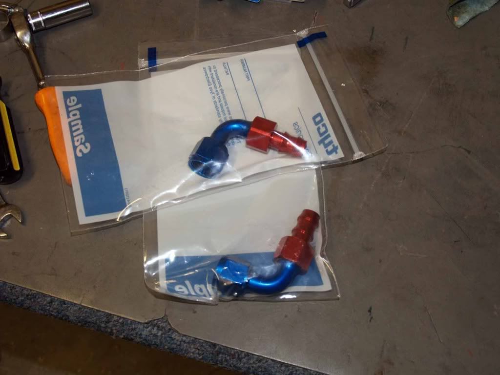

Nope, they're not knock off's. Here's the story...
I found out that there is a supplier of “un-official” Russell Fittings. AND they are offered at a fraction of the price as the official Russell Fittings.
The story is that the two owners of Russell Fittings parted ways. One owner kept the Russell name and moved the "Russell" company to California. The second owner moved to Florida and opened his own company and that’s where these fittings are coming from.
The below supplier is where you can get these substantially low cost, “un-official” Russell Fittings. The picture I posted shows that they are VERY well made. No cheap pot metal.
Performance Dynamics
804-427-5908 or 804-366-8321
www.performancedynamicsspeedshop.com

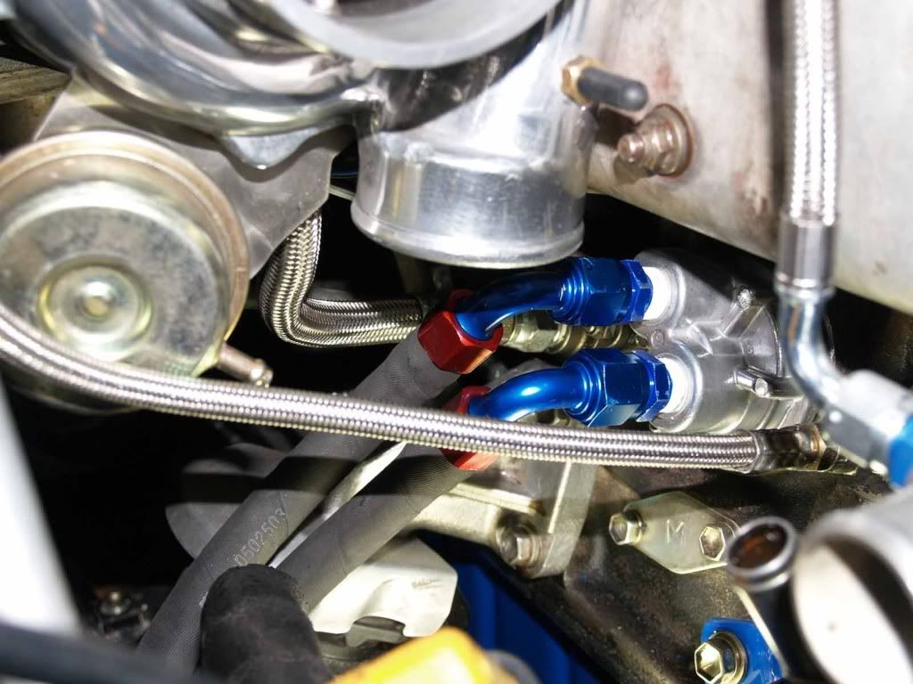

Speaking of fittings......ARGHHHHHH.....now I have to order to 90* fittings. When I switched to the Aeroquip hose, it's not as pliable as the stuff I used in my first run at this so now I have clearance issues. This is SOOOOO frustrating!!!!
Ok. SIGH...SIgh...Sigh...sigh... I'm done ranting... :)

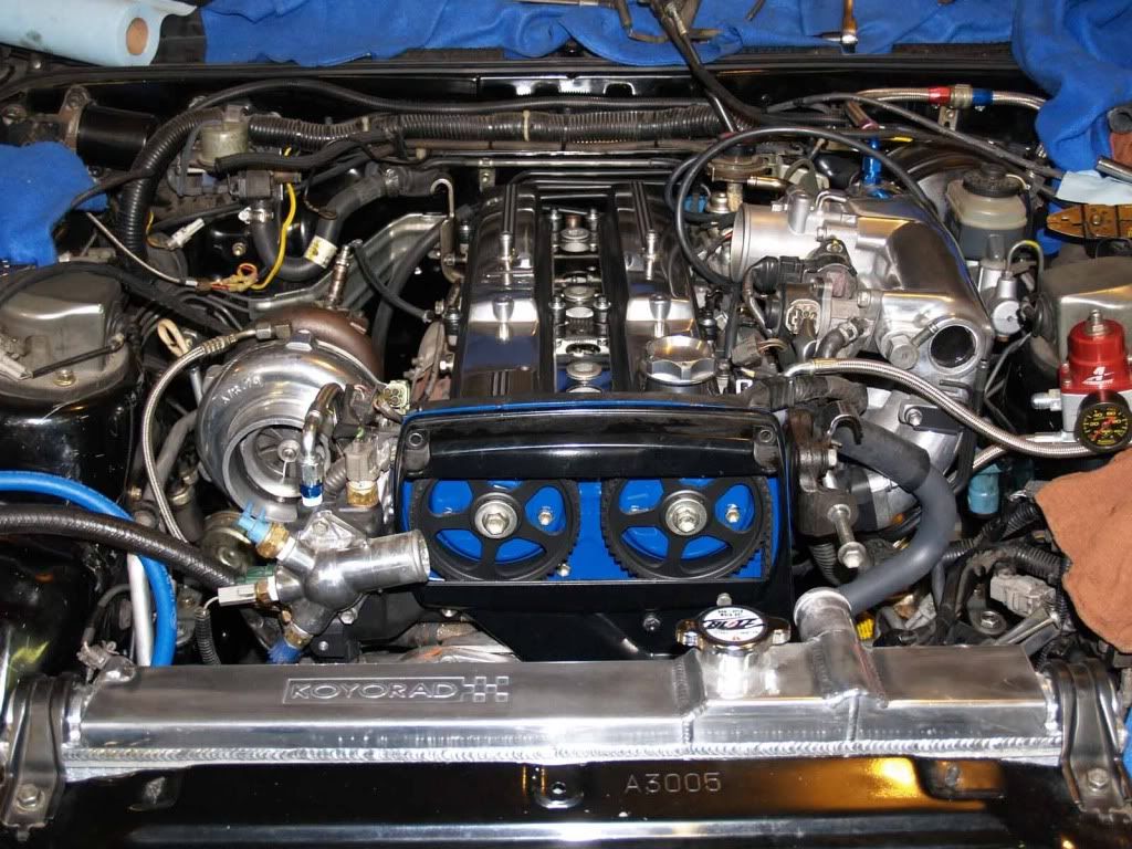

Well, the parcel services have been good to me today! :)
First up: The last of my many needed fittings. Hopefully anyway!! :biglaugh:
Next: A VERY Special Box. Any guesses as to what this is!?!?!?
And here's what I've been up to while I've been waiting for parts...

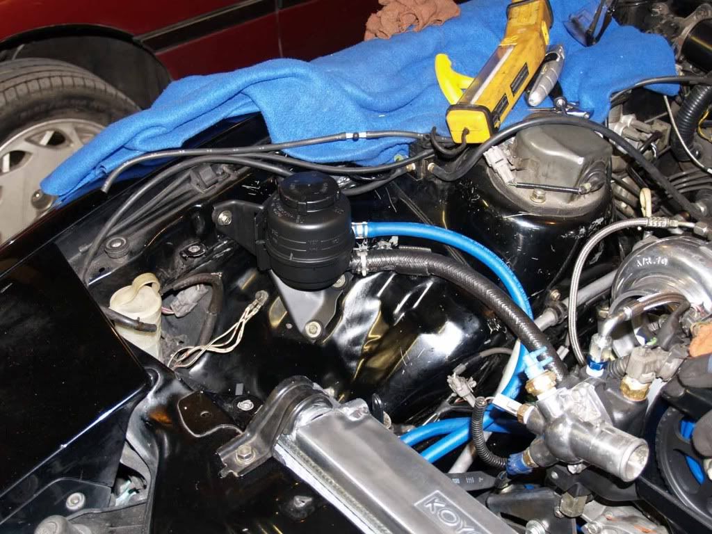

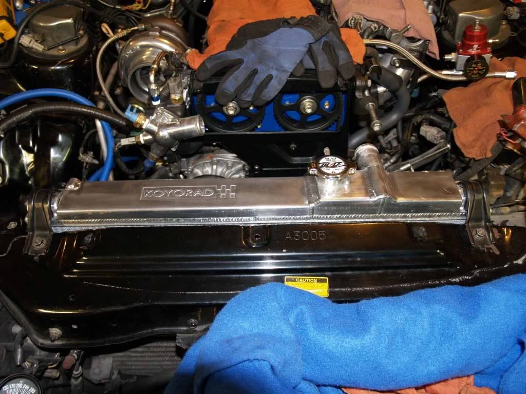

Well, the two 90*s did it. I was able to get the whole oil system buttoned up. Woo Hoo!!!

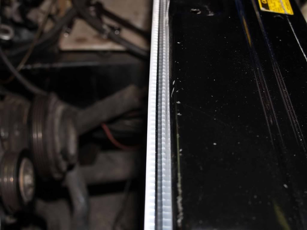

Then I installed some edge insulation to insure radiator isolation from stray currents.
Of course the Rad was next to be installed.

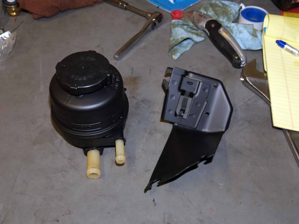

Next, I installed the N/A Power Steering Res. Compliments of David. Thx again David! :)
And here's where I left it for the evening...
