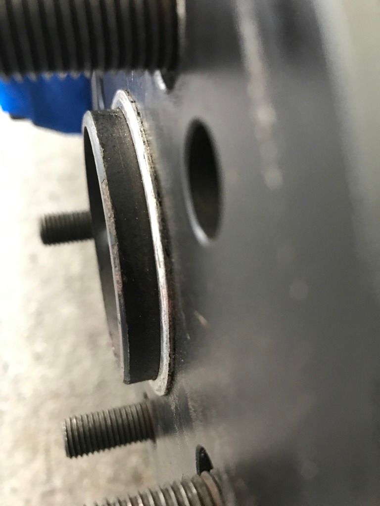

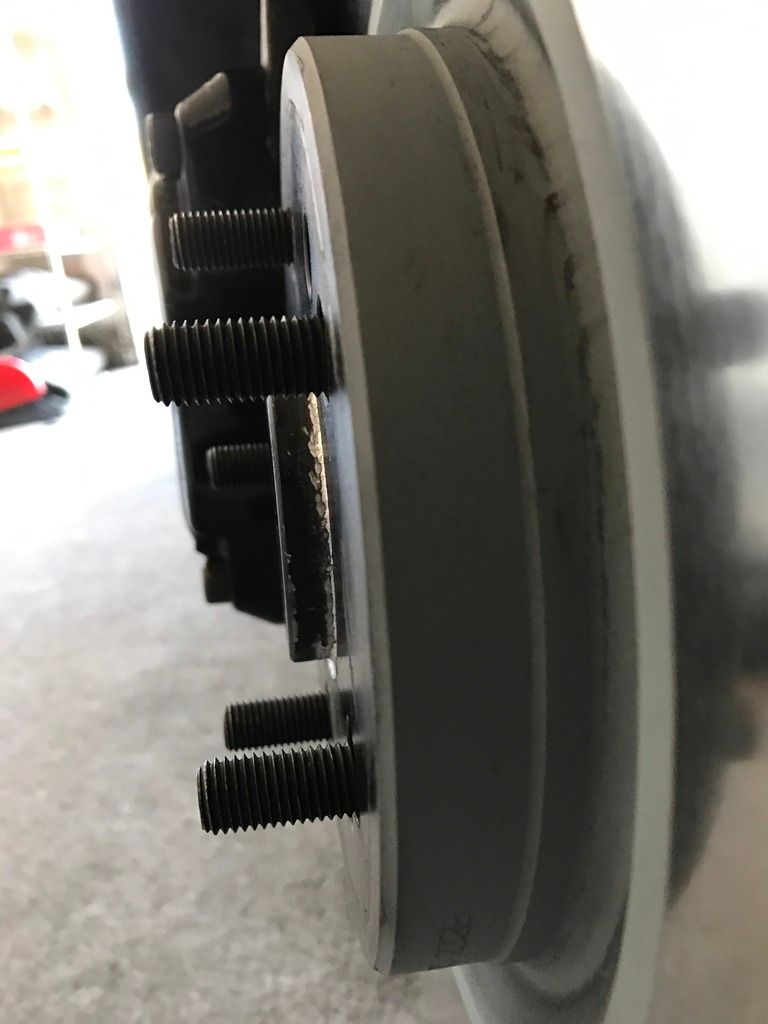

Issue #1: The aluminum hub rings from Amazon are junk and not machined evenly. The passenger side protruded from the rotor hat maybe 1mm but was tight on the rotor; keeping it from pivoting back and forth on the wheel studs (due to the larger stud hole bore on the rotor). On the driver side, however, the hub ring protruded a good 3mm, keeping the TT wheel from contacting the rotor hat. Also, the rotor could still turn freely since the hub ring was not as snug as on the passenger side. The rotor could move side to side several mm before it would click against a wheel stud and turn the hub. Factor in that the wheel was hitting the hub ring and sitting 3mm away from the rotor hat...let's just say not good. I ground down the hub ring flush with the rotor using a dremel. Problem solved. Will probably end up doing to the passenger side as well one of these days for peace of mind.

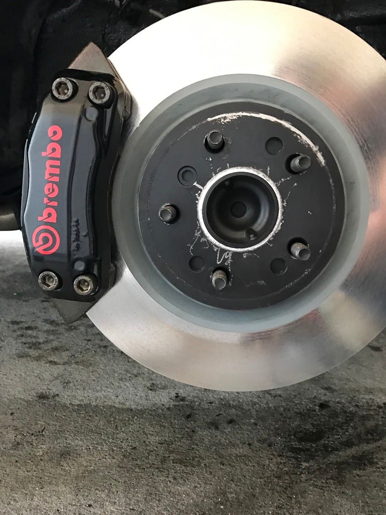

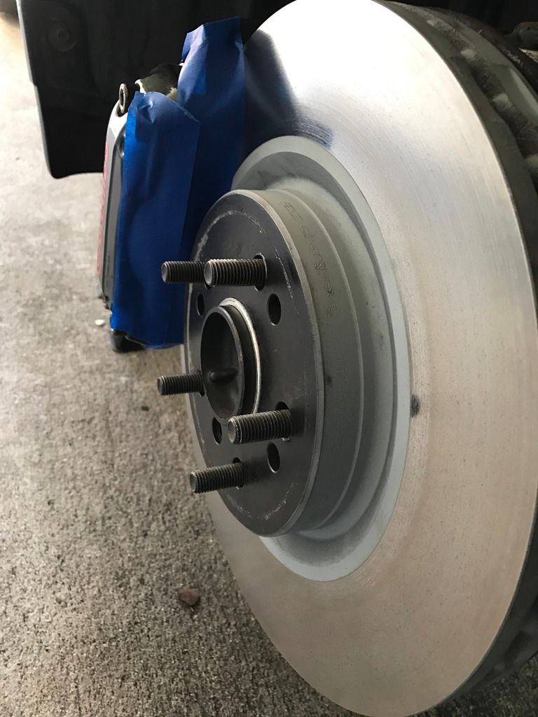

I finally got around to grinding the front passenger hub ring adapter flush with the rotor hat. Definitely recommend doing this prior to installation as it is very tedious and time consuming with the rotor still on.
Before:
After:
It's hard to tell from the pics, but the ring was ground around 1mm below the rotors surface. You can see where the Dremel got away from me a few times. Luckily, the bit is too soft to mar the iron rotor and hub; just fucked the paint up a bit. Easily remedied if I ever feel the need. Unnoticeable with the wheel on, so at the bottom of my to-do list.
